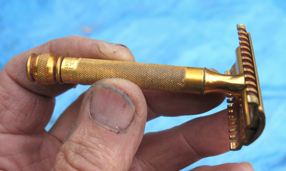

I wonder why these don't tarnish. They don't have a brilliant reflective shine, but they retain their color.

Baldwin uses PVD for their lifetime finish.
