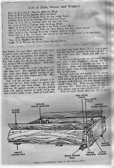

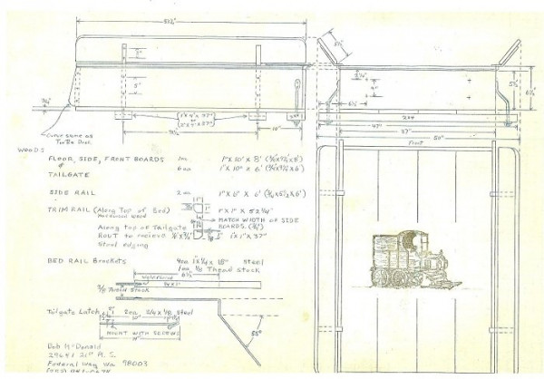

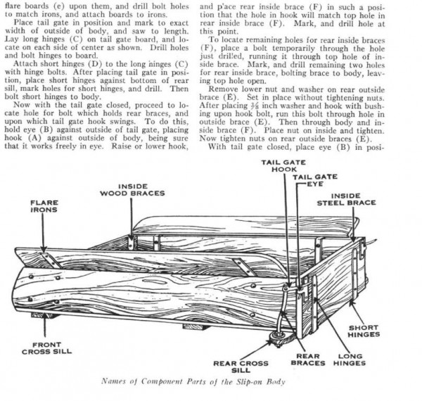

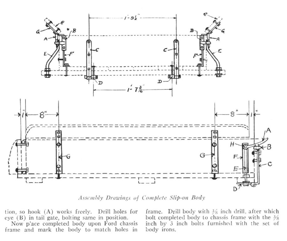

This is all I have saved from previous discussions

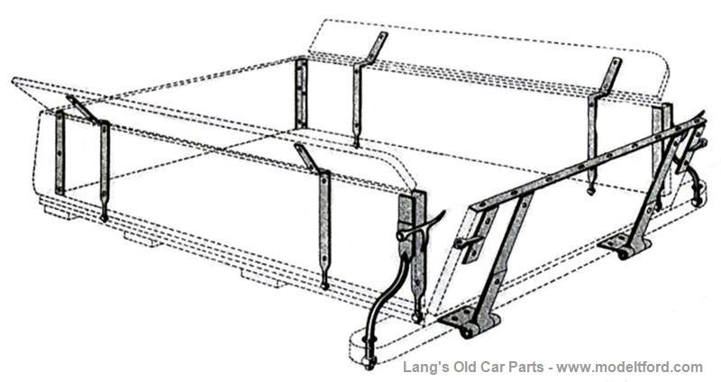

Also from SNYDERS --- always have instructions for most of what they sell Just click on the PDF file or the link
https://www.snydersantiqueauto.com/Reso ... s-5879.pdf
