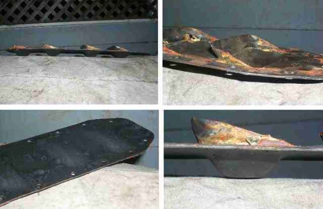

In the interest of presenting an honest record I took a photo of the Mountain pan. To my shock I realized (note the greasy hand palm print on my forehead) I had for some stupid reason returned Rusty to stock... no Mountain Pan, no Horlick oiler! Well I could smile in looking at Rusty's originality, but I am back to original style wiped bearings. When I reassemble this you can be sure it will have a Horlick Mountain Pan modification in place.
Here's the pan cover ... stock Ford Not the improved Mountain Pan design.
Here is a photo of the Mountain Pan I thought was in there!

Upon further cogitation I remembered (through the haze of time) that last time I had this engine apart to work upon I found that the pan was no longer perfectly straight. Due to my usual T-guy frugality, I chose not to pay to have the pan straightened since I had another straightened pan ready to go. My mistake (well, one of my mistakes) was to forget to swap in the access cover which has my Mountain Pan dips brazed in place. That will be easily rectified.
This is the Mountain Pan. I will just swap this back onto the engine pan now in use. It is only 1/3 of my mountain set-up but is the heart of the system. It is a totally hidden modification which does the most to save you from spinning off rod bearings in the hills... I wish I had left this in my car! You can easily see the secret of this modification; as you go uphill the rear of the dip keeps the the oil from running back to the bell housing. This is very simple and extremely effective!
This is a long slow job... because I don't heat my garage. Since warm weather is on the way this job shouldn't take too long.
TH

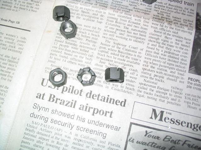

Dave, are you saying to use the Chevrolet rod nuts on the Model T main bearing bolts or on the Model T rods?
D Stroud
- Posts: 1015
- First Name: David
- Last Name: Stroud
- Board Member Since: 2011
Re: Laminated main shims...HUH?
Use small block Chevy bolts too. They pretty much fit right on. Dave
