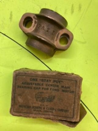

I would be interested in the centre main fixes. As there are no thrust faces on the crankshaft journal, how do they work?.

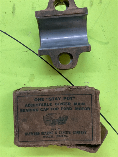

Re: Rear main cap removal advice
Allen
The cap is brass so it gives a more robust surface to wear against. It alos has a way of locking it in place to get the mag ajusted.
Made by the Hayward bearing and casting Co. Called the "Stay Put" adjustable center main bearing cap for ford motor.
I'm having trouble sending pictures to my comtuter.
- Posts: 7167
Craig, I was not aware that the cap was brass, but it still does not compute with me. You report that it is stated that it wears better, but in the absence of a thrust face ground on the crankshaft, what does it wear AGAINST? There is no thrust face on a centre main cap and no thrust face ground on the crankshaft. I must be missing something. Or does it just fill a gap like the temporary brass item sandwiched between the fan pulley and the front of the block, and wear against whatever?

Center main fix isnt a great idea. In operation the flimsey T crank will "grow" in length. Big problem for go fast guys. If not enough clearence is given to account for the that growth in the center & front main caps the force can lead to a broken crank. Thats usually the cause of a frontal area crank break.(barring removed radius's on journals).Rear area breaks are usually from pan/4th main misalignments. One old timer racer buddy told me to allow at least 1/8" @ the front main for crank growth. If the t was originally center thrusted, the magnet/field coil clearance would change @ speed. "widen"

I would assume that there is enough suface in & past the radius of the center main journal to hold the crank in place. Don't think it would be wise to set it up any tighter than you would the 3rd. main. This is just a stop gap repair I would not think it smart if you are not sure the rest of the engine is up to the task. As I understood this was intended to keep the Mag. working? When I purchased the engine in for My speedster I was told it was probably
