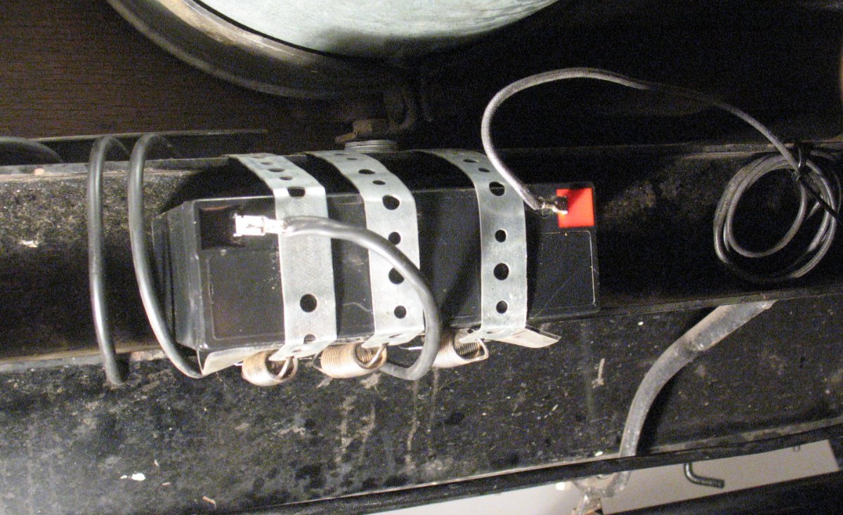

Post by Steve Jelf » Mon May 03, 2021 2:00 pm
The battery in my 1915 is strapped in the left frame rail. Also magneto charged.

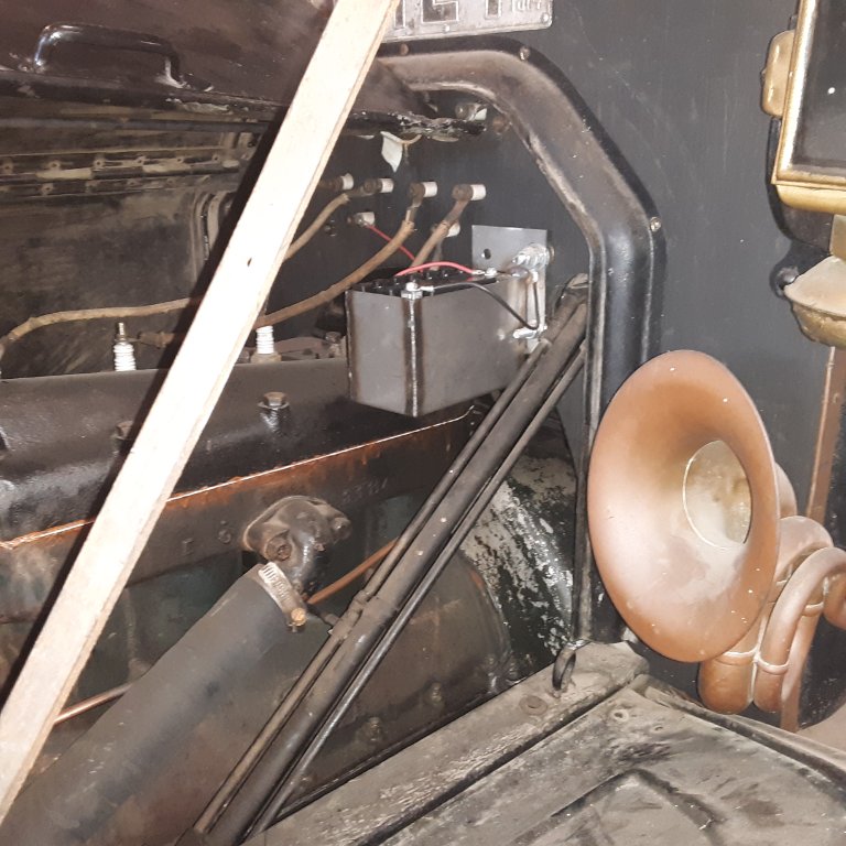

Re: Battery mount location in 1914 car
Post by got10carz » Mon May 03, 2021 3:24 pm
This what I did on my beater 14. Way less wiring.
