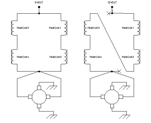

Ahh! It has been done more than once.
I believe it has to do with joining the field loops (??) up in a different order...
It has been explained to me twice but I still did not get it.. but you can start by looking here: http://www.mtfca.com/discus/messages/80 ... 82269.html

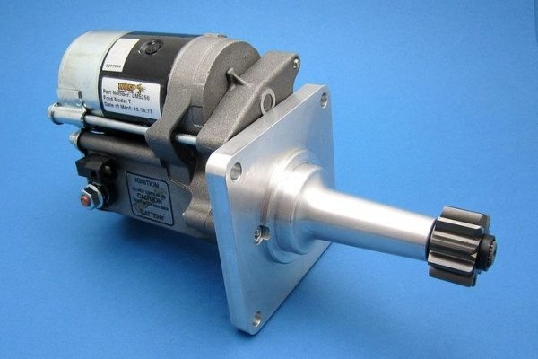

I also have a high compression head and originally ran a 6 volt starter on 12 volts. To drop the voltage a bit I put the battery in the back seat, ran #4 wire and put an old bendix spring in series with the cable from the solenoid (yes, I used a solenoid, not a foot switch) to the starter. Normally it worked fine but a couple of times I stalled out on tour (engine hot) and had to crank it by hand beyond compression before the engine would turn over. I also had a bendix problem (slipped woodruff key) another time. These little things bothered me enough that I decided to purchase a modern starter designed for the job. I wanted to stay with 12 volts for a number of reasons which need not be discussed now.
I took my 6 volt starter and the diagram for re-wiring it for 12 volts to a reputable old-time auto electric shop. When I explained what I was thinking and showed the guy the starter his reply was "Aw....you don't want to do that....." Indeed, he refused to do the mod. I'll leave it to others to debate the pros and cons of that modification. At that point, I decided to look at a modern replacement.
The WOSP unit is a geared starter, with a built in solenoid. You can keep your foot switch, just use it to activate the solenoid. When activated, the starter gear first engages the flywheel, then turns. Less wear and tear on the gear teeth. Also, no little bendix parts to come loose and end up in the engine. In the year I've had the starter it has worked well and given me zero problems.
They aren't cheap, but I covered most of the cost by selling my six volt starter and bendix. My goal has always been to have a reliable car for touring and the starter goes a long ways towards meeting that goal. If a future owner wants to return it to original, it is a simple matter of out with the new and in with the old.

The info you are looking for is in a post from AdminJeff on Feb 02 2020 pictures & diagram.
My Brother in law took his to a generator shop they did it for $40 it works great. One of the local club members is doing it also.

To convert the stock 6 volt starter to 12 volts requires rewiring the field coils from parallel to series.

I'm moving to Idaho in 10 days so my entire shop is in boxes (the new shop is coming along great!), however, I did document this entire process. I and others with similar skills have done several of these conversions and they work really well.
viewtopic.php?f=2&t=10169
