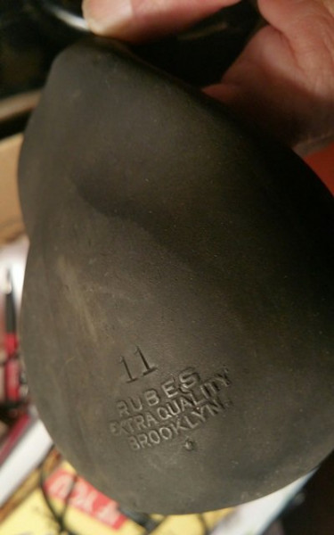

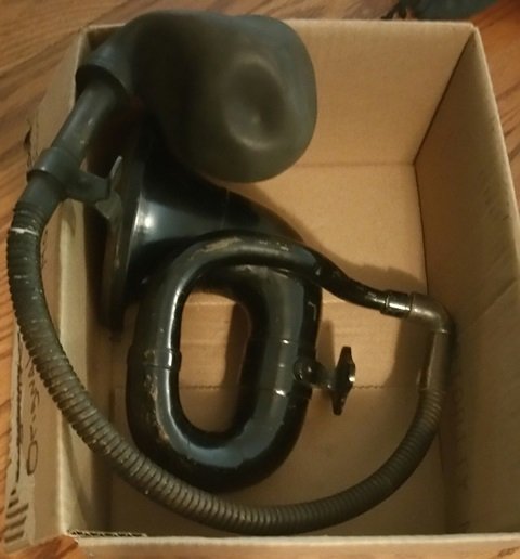

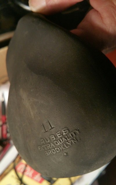

Here is a photo of what I believe is a really difficult to find part - an original rubber horn bulb. This really minty Rubes horn was my prize from the Luray Va Pre-War swap meet. It's actually for an early 1915 with that "L" shaped tubing adapter where it goes through the fire wall, but substituting a straight connector makes it suitable for 1914. It's got all its original black paint, tubing, bracket, and a wonderful rubber bulb marked "Rubes." I don't think there are many like that around. It's still relatively soft and supple, but has just lost its shape from years of laying flat. It may be worth trying to reproduce that.

Terry Bond -- That's a nice '15 horn you found, but it's not correct for a '14 even if you eliminate the elbow. The mounting base is a "diamond" shape on the '15 and oval for a '14.

You're right! Just looked at the horn on my 14. That's ok, I've got a good unrestored 15 chassis that will eventually get restored into a panel truck (I hope).
