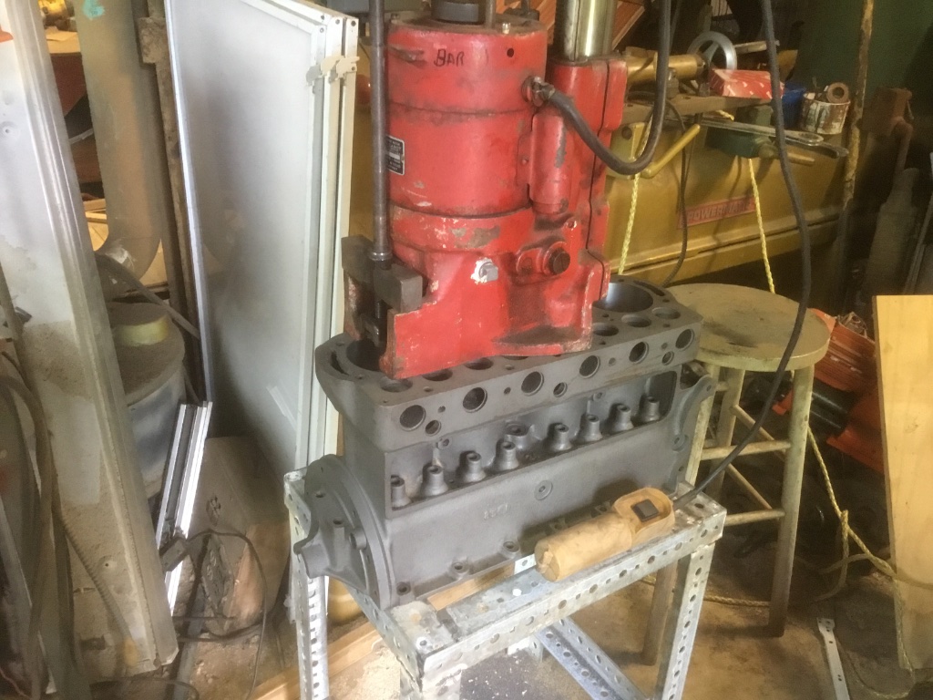

In-chassis boring equipment is still available; the problem is that it is pricey. A really good automotive machine shop might have one, but if you live anyplace except in a major population center, good luck finding a shop that has one. There is no reason why a T engine could not be bored in-chassis.

Anyone with a boring bar could set up in the car. But my goodnesses, how could you ever get it cleaned enough not to self destruct?. And what about the babbitt?

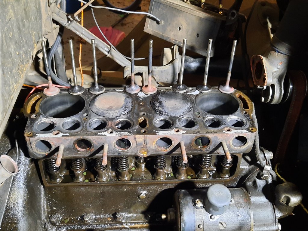

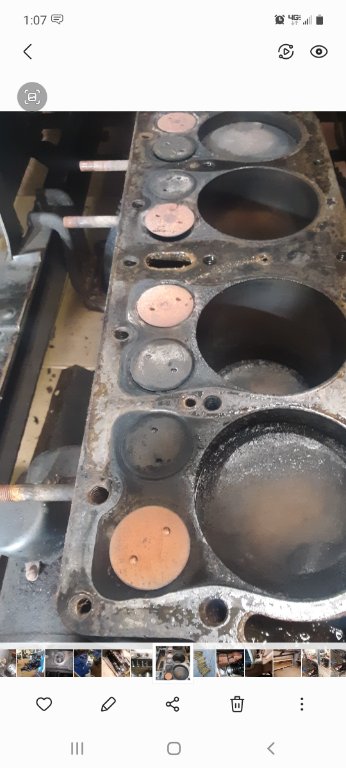

So... I took it apart this evening... intake valves look ok, intake not so much.. also I can feel ridges halfway down in all 4 cylinders... I guess that means rebuild job, right ?

It's good you pulled the head to look. I'm not an expert, but those exhaust valves look like they were very hot. Maybe something happened to cause the ignition timing to back off. That would cause the extreme heat and a definite lack in power. Plus... after that happened they probably weren't sealing well either. So when you get it back together, I'd double check the ignition timing. Bill
- Posts: 6732
Re: Losing power..
It means the valve job didn't take
you might have some scratches 1/2 way down the bore, but you don't have ridges. Nearly all old T motors have scratches...some even have gouges from wrist pins gouging them. In most cases, it is meaningless relative to performance and very often doesn't even result in excess oil consumption. I've replaced rods for guys who are determined to not spend a dime more than the price of a rod and a couple hours of work...in most cases, even the gouged cylinder jobs ran passably well.
Proponents of valve grinding paste not always, but very often end up wrecking new valves and ironically never fully clean up the block anyway, and are the primary recipients of hardened seats and a full rebuild...if they had used a NuWay set and done the job (which does NOT require a finish grind), there would be far fewer "sunk" valves and far fewer hardened seats sold.
You may very well need to have the motor completely rebuilt, but there are plenty of folks who could put that thing back on the road for another 5 - 10 years with very low risk. Unless you have a burning desire to spend $4,000 - $6000 bucks on a rebuild, find one of those folks.

Ok. I ordered oversized valves, and the reamer to go with it..my valve guides I can easily slide a 21/64 drill bit in the guides with a little bit of wiggle but I cant get the 11/32 bit to go in....according to me and Google that would be about 20 thousands... TOO MUCH wiggle.. so I'm gonna put oversized valves in ,and try seat em good, and see if I can push the rebuild off a few more years... I'll try to let you know how I make out... thanks for all your helpful advise..
- Posts: 6732
Re: Losing power..
Larry, I'll warn you that if you simply run a reamer down the hole without fixturing the reamer dead center on the valve hole (or where it SHOULD be since the last set of valves were lapped in with excess wobble/clearance), and then CUTTING a new valve seat, you are not going to come to a good end.
There will undoubtedly be someone who will cheerfully suggest that "nah, you only have to whale-away at the block with a couple of stones after you've reamed it and you'll be fine". If you take that advice, well the advice was free, just like mine.
http://www.mtfca.com/discus/messages/70 ... 1510948496 shows how I do it, and how others do it similarly, as well as a period tool which did the same thing as I and others do. All good engineering practice and you're guaranteed concentricity between the valve guide and the valve seat (which is absolutely vital once the guide/valve tolerances are back in spec).
I really cannot too strongly suggest that you get help with this from someone who is acquainted with this type of work. Pretty sure I said the same thing when you were first replacing the valves and sincerely hope that you will take the advice now.

So I got a valve job done, with what I am happy with.. compression is between 35 and 40 in all cylinders...car starts easy, idles nice.. However I still seem to have an issue with power.. Here is some info, see what you think...number 2 and 3 cylinders seemed to have burnt valves, as in running lean, when I start the motor and adjust the fuel I go clockwise to lean, (which is about one turn out) then turn counterclockwise to to get more fuel I can turn all day little or no change( 3 or 4 turns ) is that normal ? I thought I should be able to flood the thing ... I have a rebuilt holley vaporizer.. any suggestions ??
