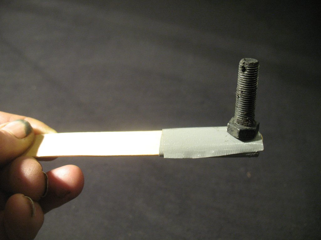

Post by Steve Jelf » Tue May 25, 2021 11:36 am
Tongue depressor, Gorilla tape.

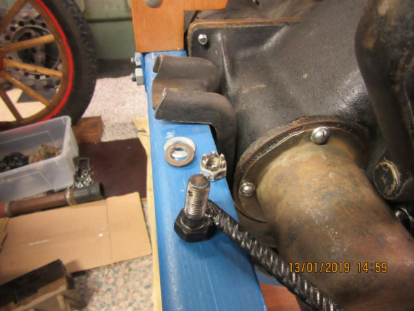

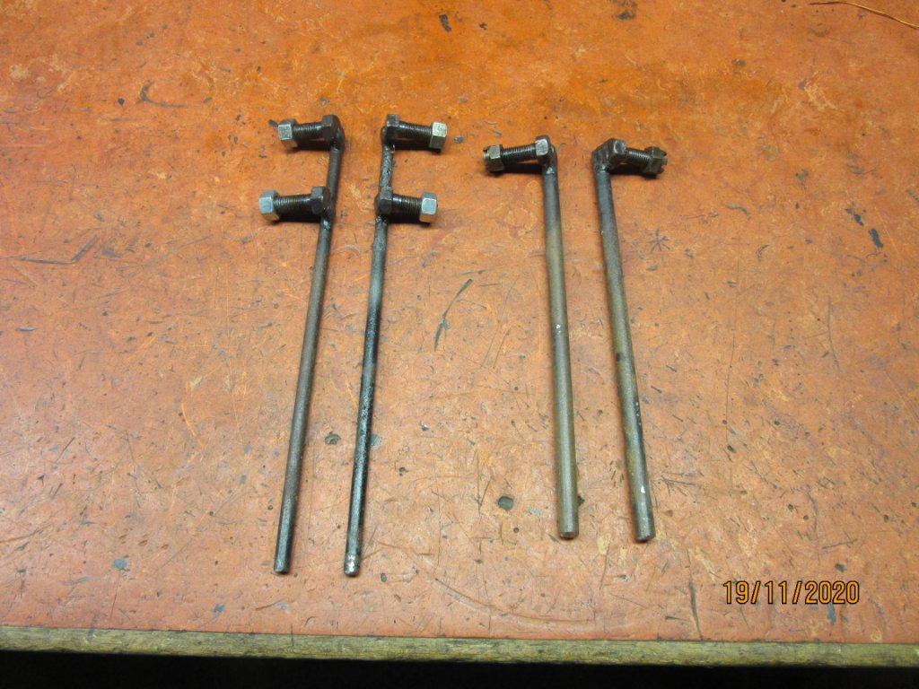

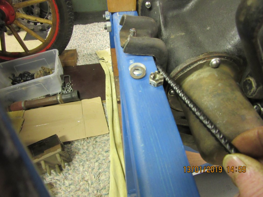

Post by ABoer » Tue May 25, 2021 1:21 pm
I use this .
Toon
