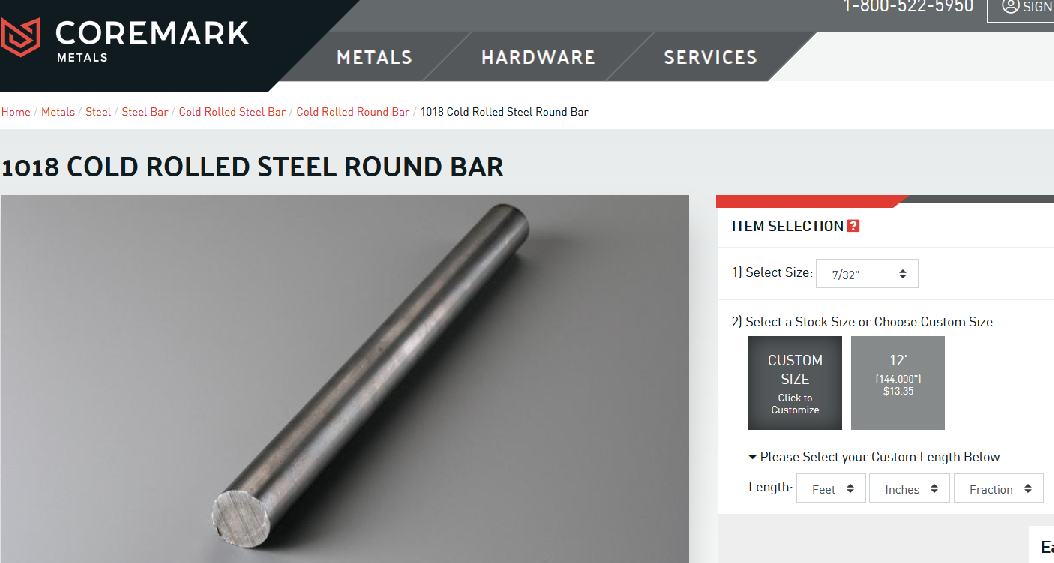

Posts: 6467
Re: Throttle and advance rods
Post by TRDxB2 » Wed Jun 02, 2021 9:05 pm
The had a listing but its gone
52100 Bar Stock Steel .210" Thickness - https://usaknifemaker.com › 52100-steel-210-thickness-...
It is a tough steel that has very fine grain when heat treated well. Depending on the final hardness, 52100 can make great hunting knives(59-61 HRC), kitchen ...
Closest I could find https://www.coremarkmetals.com/1018-col ... -round-bar
7/32 or .21875" 5mm = 0.1968
