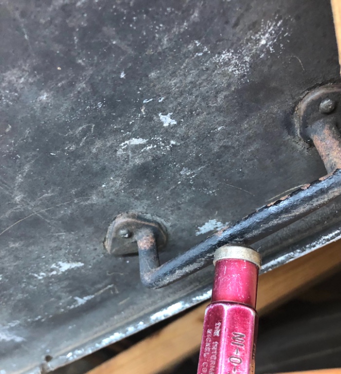

Magnet hanging from the forged steel ( iron )handle of a '13.
