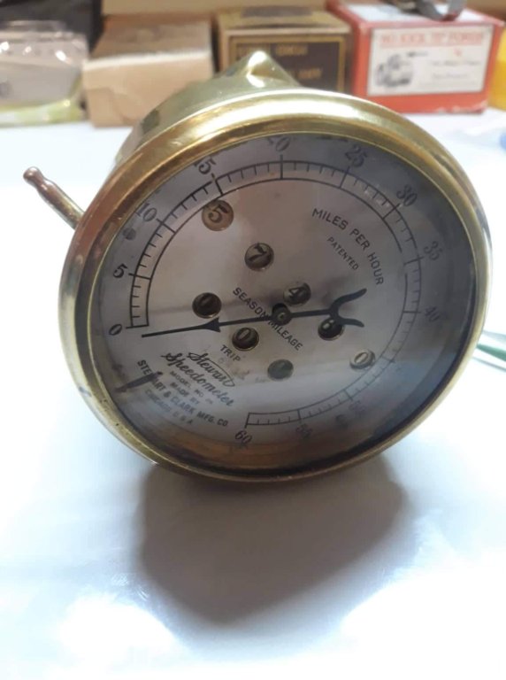

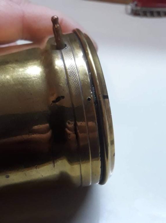

Post by Glen McConachie » Tue Jun 15, 2021 6:15 am
Here is a couple of photos of the one I am working on
Many thanks
Glen

Post by Russ_Furstnow » Tue Jun 15, 2021 8:52 am
Three small brass pins are pressed into the case and bezel to hold the bezel in place. The holes in the bezel must line up with the holes in the case.
