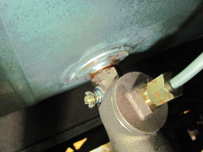

Trick too on the repro brass sediment bulbs, they tend to seat fully anyway due to the modern pipe threads, and the shoulder nut rides close to the tank, a very thin open end wrench is beneficial as a thick monkey wrench can wedge there!

Regarding "modern pipe threads" - I had a chat a number of years ago with Billy who took over reproducing the new gas tanks and he told me that the tank outlet castings were tapped too deep by the original producer's hired help thus the reason Snyder's new sediment bulbs want to bottom out ! I've addressed that issue twice by adding a thin layer of solder to the new sediment bulb.
