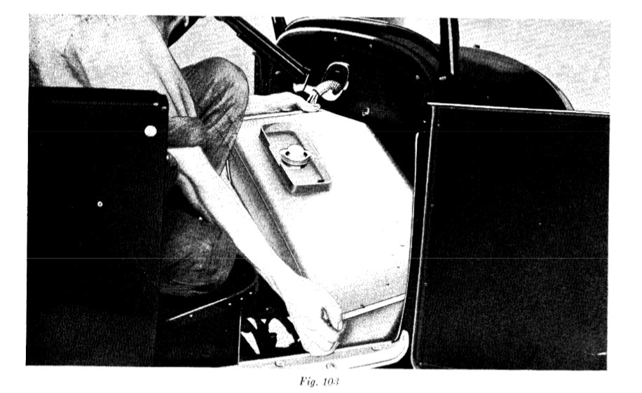

You shouldn’t have to remove or loosen the dash. You do have to remove the floorboards. The info on procedure is in the service bulletins.

I was able to install the cleaned gas tank in the 1926 roadster pickup I once had with the dash in. I had to remove the steering gear and the key switch and wires, plus the floor boards were out. Place tank on hogshead and hook the, (prior restored strap lining ), tank straps to cowl hook eye. Now the hard part, even with a helper. Lift the tank up and rotate tank a little if needed to thread the ends of straps threw the fire wall. Now while holding tank up have helper start the strap washers and nuts on engine side of firewall. Don't forget to reinstall the tank drain tube when done.
