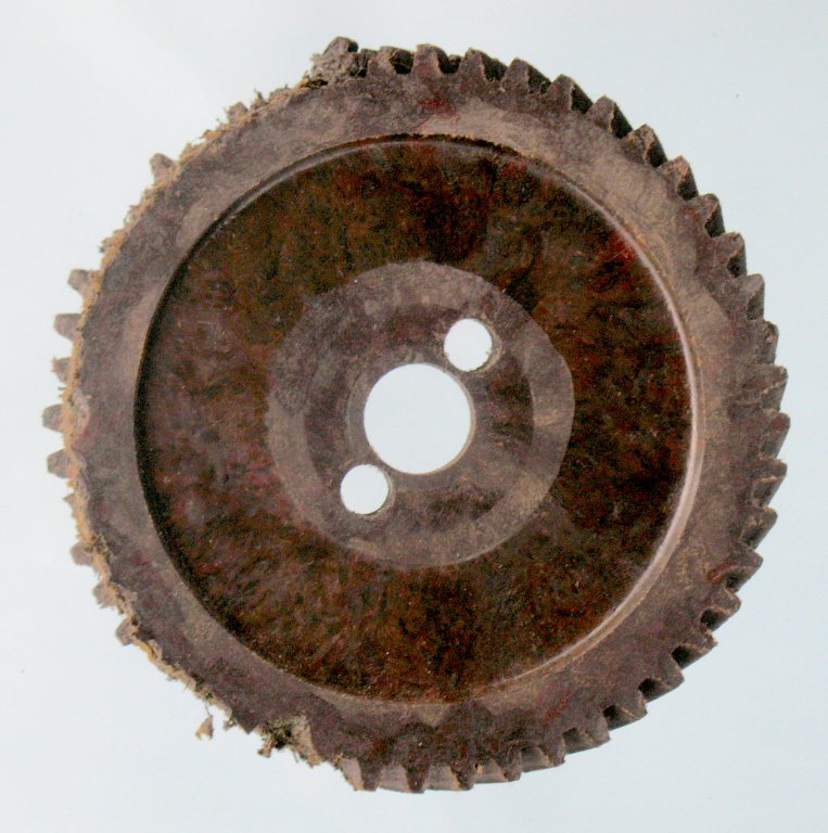

I bought this car knowing there was zero compression. I could see/feel the gear on the generator did not turn when hand cranking the engine. The pistons move freely. I felt that it was the timing gear and sure enough it was sitting there with very few teeth along the back edge of the gear. What are some of the things that come to mind that would destroy the fiber gear? I plan to replace the gear with an aluminum gear. Before I try to start the engine I will lift the rear end, put the trans in high and hand crank the engine. Hopefully I won't have any binding or locking in the drive train. Any other suggestions? Do these fiber gears just give up and fall apart? The son of the previous owner seemed to remember that the car was running and stopped quickly. Dick C.

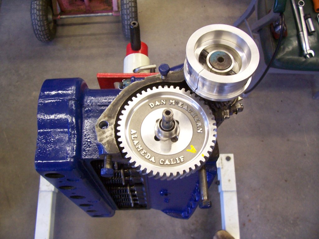

Maybe they're not all the same, but I don't aim to ever gamble on another one.
I think this one dates back to the seventies or earlier.
Dick, your gear was in a 1925 car but it wasn't a 1925 gear. The original was steel.

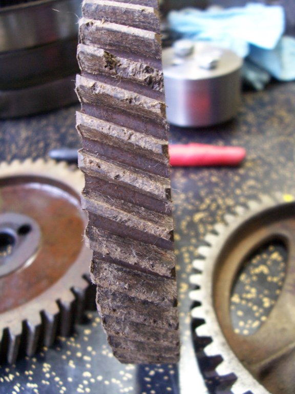

Macerated gears are made up from short chopped up fiber with binder added and compressed to make the gear. Laminated are made out of layers of fabric that binder is added and compressed to make gear. I don't know if all Model A's used the Laminated gears from the factory or not, I think they did, and if so, at some point both the T's and A's have had lower cost macerated gears installed. Both T and A can suffer the same fate, stripped teeth(macerated). While the condition of the generator gear and crank gear in the Model T along with spacing of the generator gear to cam gear may come into play, that would not explain why when the macerated gear is used in the Model A, it suffers the same fate at some point.
You will note the mottled surface of the stripped gear shown above, that is a pretty good indicator of being a macerated gear. Laminated gears generally have an even colored surface and may show signs of the fabric weave in less compressed areas.
