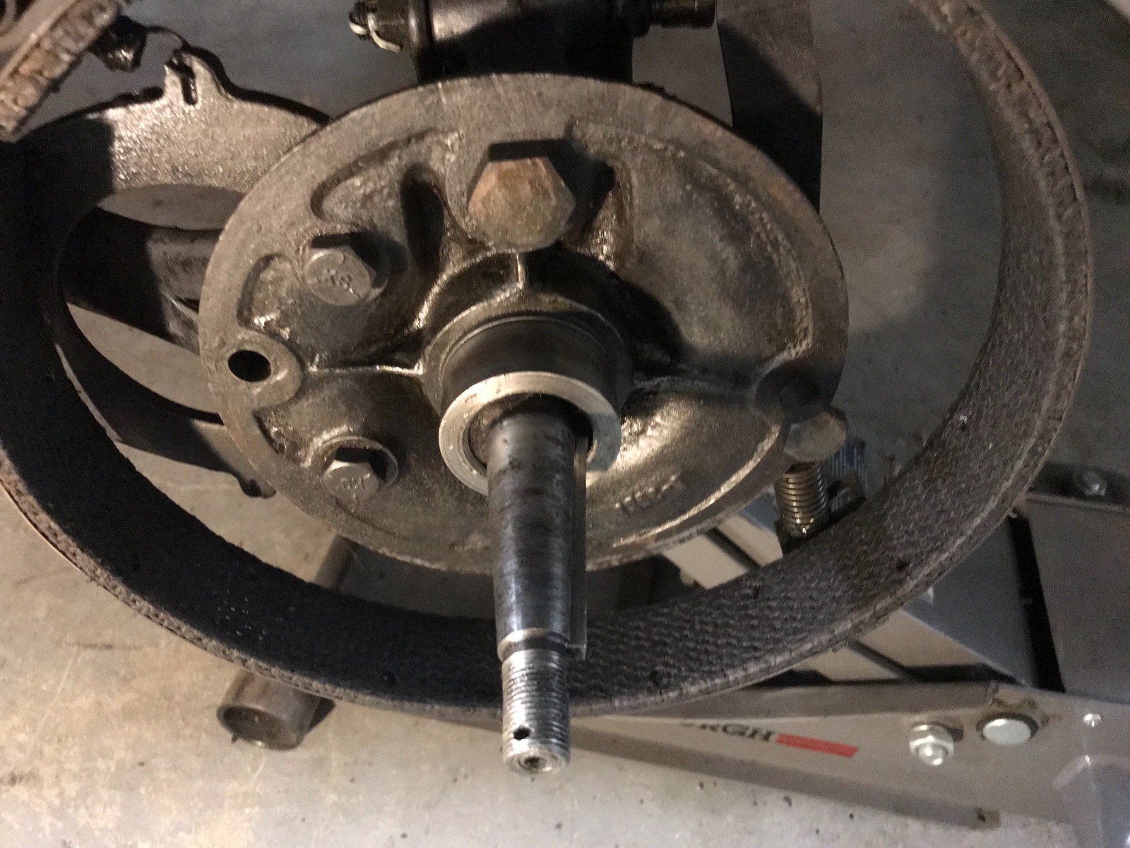

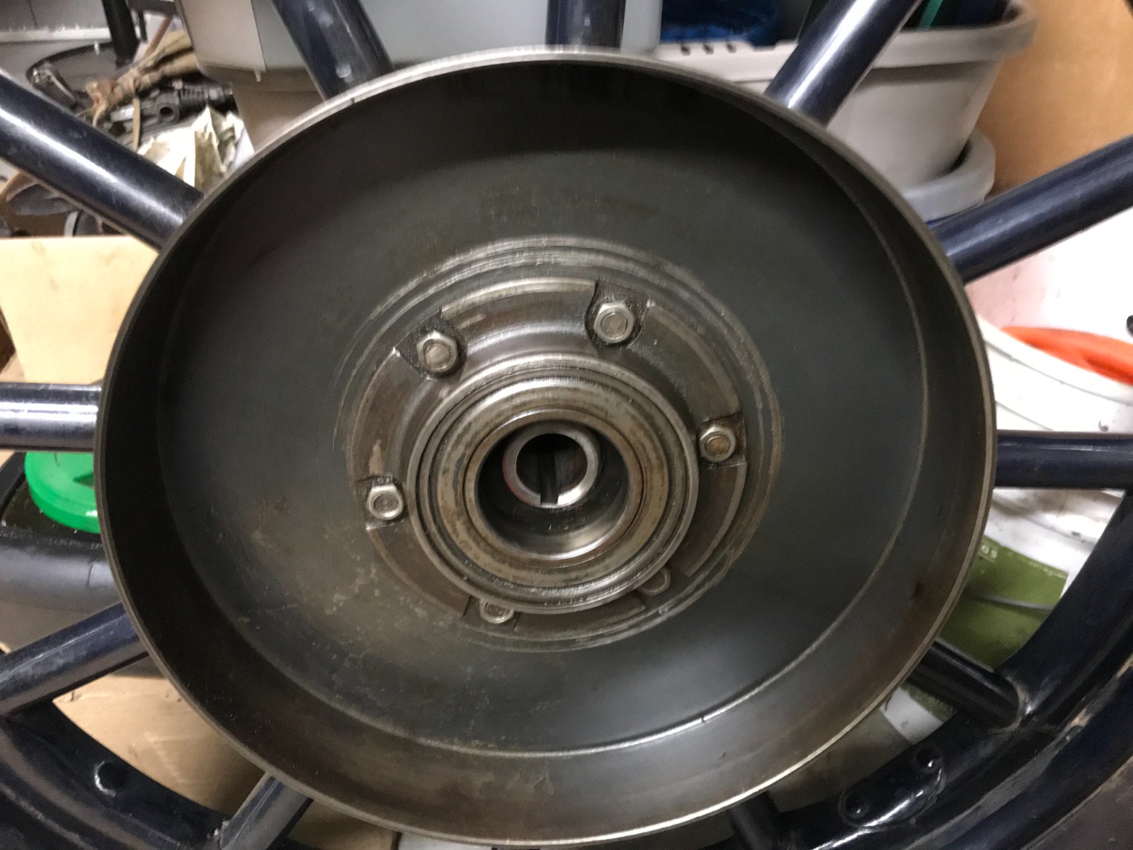

I have had my '14 Touring for over 10 years and when I got it the previous owner told me that he had completely redone the rear axle so other than checking periodically for play I have not done anything to it. It has Rocky Mtn. brakes but the previous owner did not put the Ford service brake drums back when they were added. I thought that was odd but I have not had any issues as a result. Recently, after a week of touring I noticed some grease on the brake lining so I pulled the wheel and discovered that the car had some kind of floating hubs.
I have never seen floating hubs like these before but it looks like there are felts around the axle to keep the grease in. It also looks like there is no way to grease the bearings because when I removed the grease cup there is a blind hole. My first question is are these sealed bearings and if not how are they lubricated. My next question is how can I stop the grease from getting out. My inclination is to pack new felts around the axle. My last question is can I put the small Ford service brake drums back using longer hub bolts or will that create a problem.

Val, often the sleeve in the axle housing on floating bearings has an oil seal on the inside end. It usually does a good job sealing around the axle. Your oil leak may be between the axle housing and the sleeve. Some types have an O ring to help here. I prefer to use a loktite red flange sealant instead.
Your bearing has metal shields. It may or may not be sealed. A sealed bearing also acts to keep oi in the right place.

Val, I forgot to add that the original emergency brake shoes may have been left out because the nuts mounting the bearing carrier in the hub fouled on the brake shoes/springs. This is even more likely given thAt the mounting nuts on your carrier look to be standard thickness rather than the thinner original nuts.
