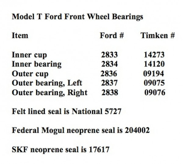

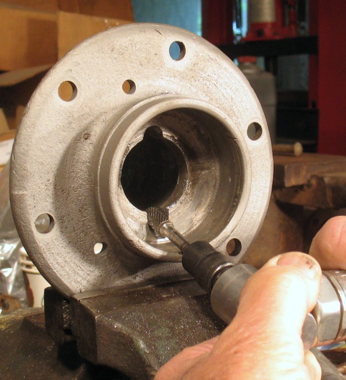

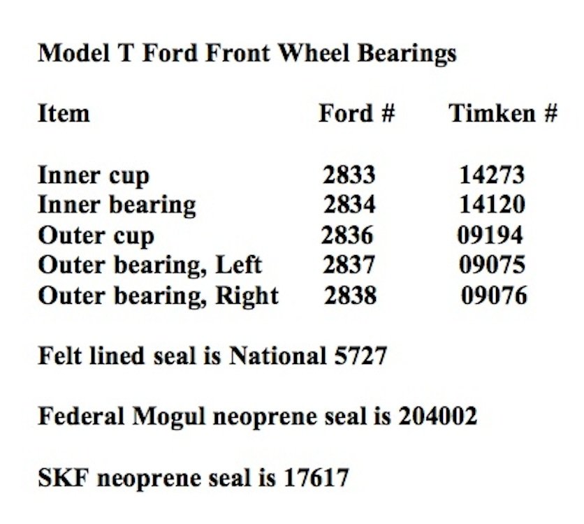

Several years ago I looked into ball bearings and found that some parts were available but others were made of unobtainium, so I went with roller bearings. 1915 hubs were made without notches for driving out bearing cups because the ball bearing didn't need them. So for the new wheels for my 1915 I used 17-18 hubs, which are a little sturdier, and cut notches in them.
I use the stock bearings and have no experience with the cheaper substitutes. The best prices I have found are at rockauto.com. Unfortiunately it seems that some parts are currently out of stock. https://www.rockauto.com/en/catalog/for ... aring,1672
