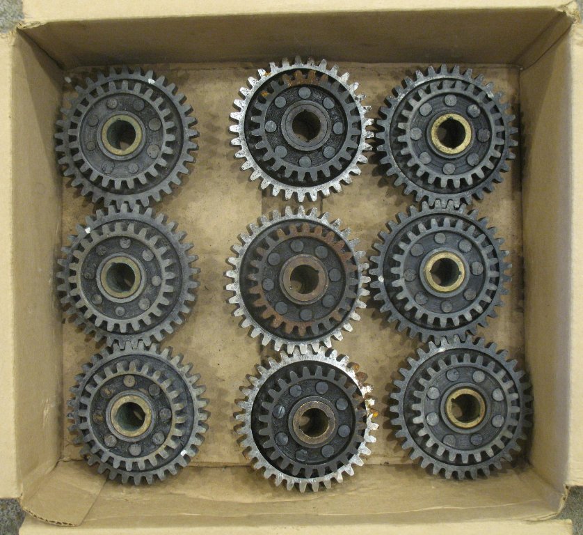

Today I went hunting for "new" triple gears, and these are all I found.
I've arranged them here in three sets: left, center and right. The weights within each set are all quite close, so balancing them should be easy. But some have loose rivets. In a couple it's obvious. In some others, if there's any looseness it's so little that I can't be sure. The question: can loose or suspect rivets be hammered tight enough to make the gears usable?

Steve, all those gears will be "new" to your already run transmission that had the one piece gears. So, they will have to get to know your drums as they settle in. I can see no particular advantage in keeping them in their sets, unless they are quite worn, which is not usually the case with three piece gears. Selecting any three with tight rivets is not really going to make a lot of difference, so long as you can still balance them.
If you had a transmission apart and found a gear with loose rivets, then I would re-rivet that gear to keep the triple gear/transmission gear family together. If the gears have not "worked" to be quite loose. I would turn up a collar to support the rivet heads on one side of the gear, and use a press to load each rivet individually, rather than hammering on them.

Steve Jelf wrote: ↑Thu Jul 01, 2021 5:17 pmToday I went hunting for "new" triple gears, and these are all I found.
No.
