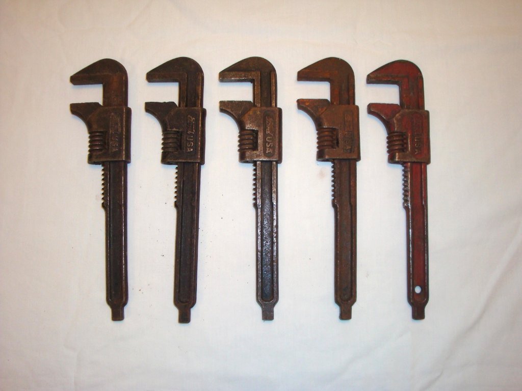

The later Ford script adjustable wrenches have a square boss on the end of the handle for use with the Model T and Model A differential plug.

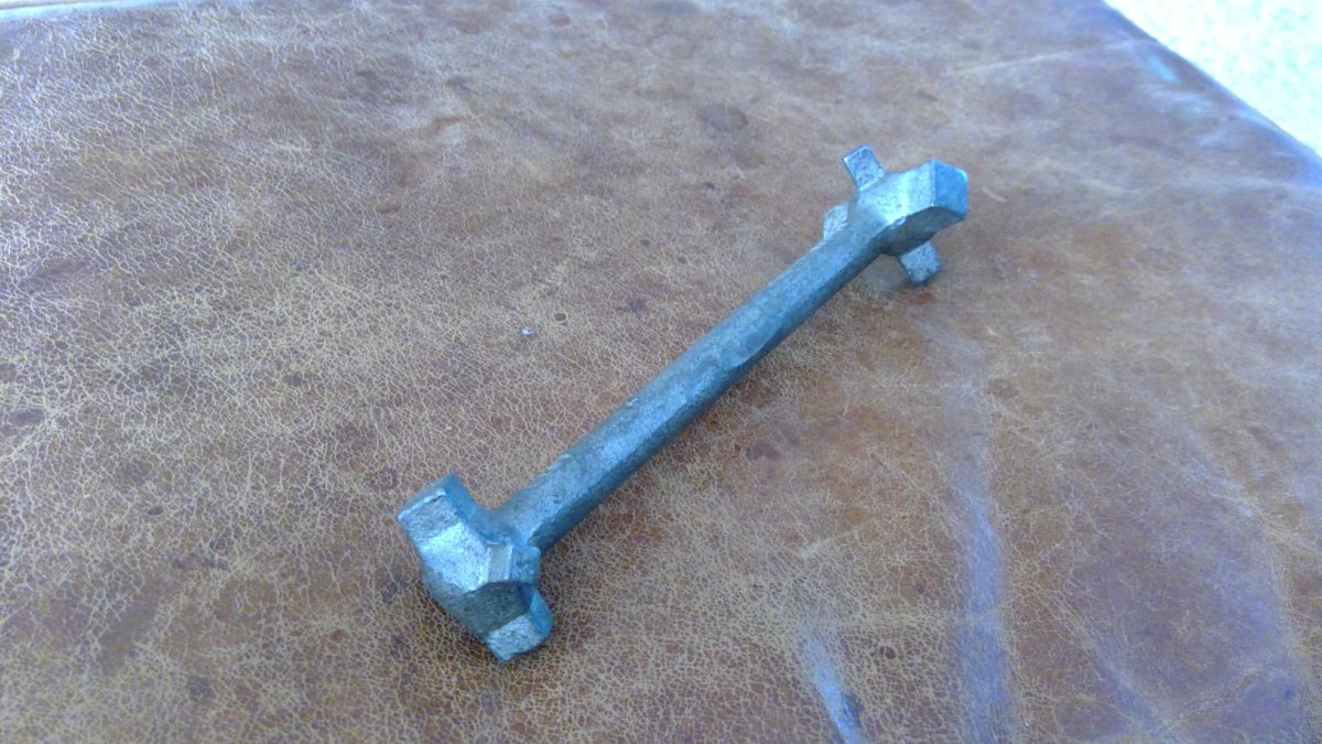

Bung wrench. A handy addition to any toolbox!
