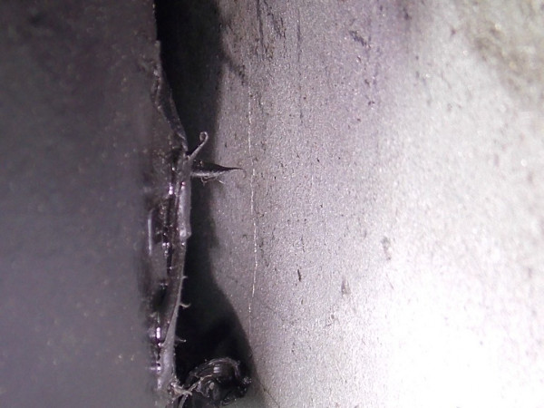

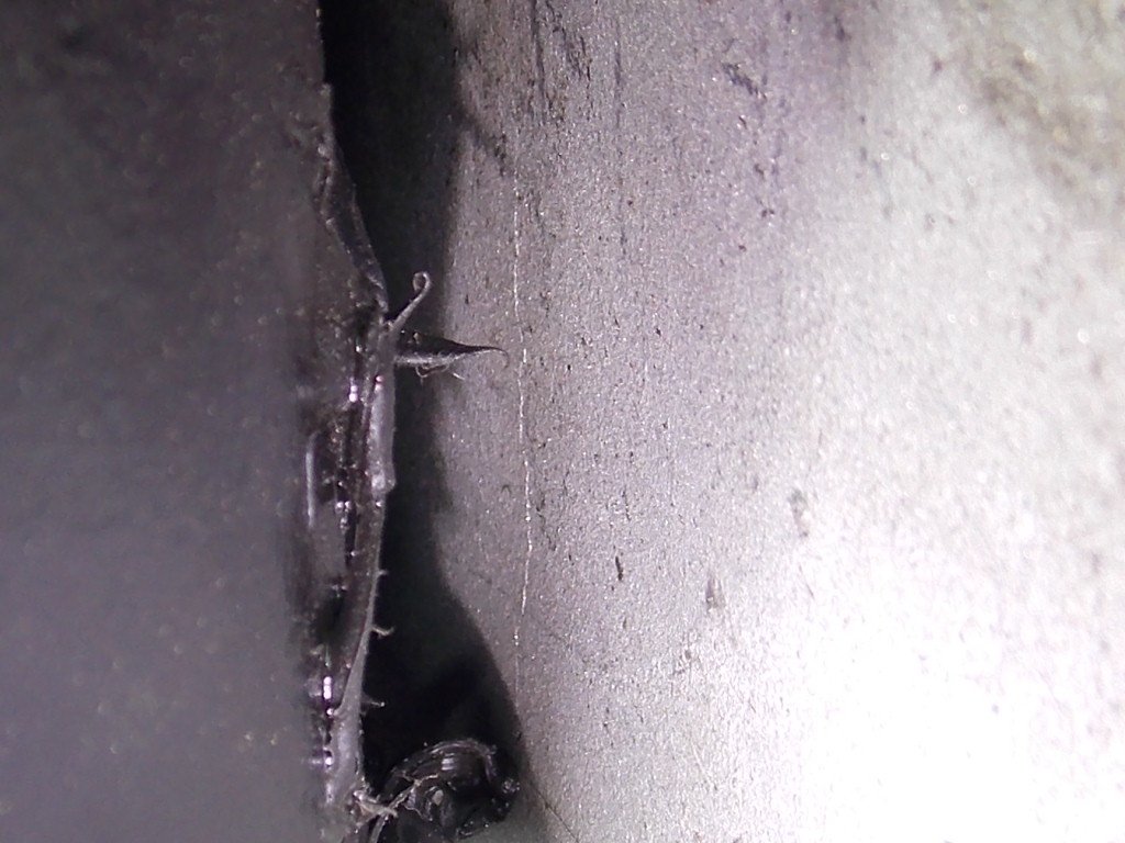

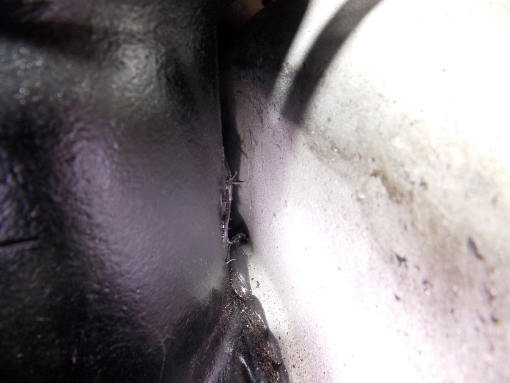

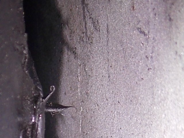

Re: oil leak
As promised yesterday here are the photos of the crack in the hoghead.

- Posts: 3977
Re: oil leak
Just my observation, but sure is a lot of silicone sealer in the interface. The hogshead should mate with the rounded back curve of the block.
And that crack in the aluminum hogshead seems like just a casting mark, those parts are normally nice castings and usually are damaged at the rear mounting hole ears.
Have only fitted up one alum. hogshead, but did that the same way as always, and haven’t had a leak at the upper round areas. Only in the junction of the hogshead/block/crankcase corner is potential leak to occur. My fit is always old school, the Ford felt , soaked first in varnish and squeezed down, placed over the block curve, and carefully fitted butt jointed gaskets on the block and crankcase at that junction, using Permatex coating on metal and gasket surfaces. That varnish lets the felt conform and dries and seals the felt, but allows later removable with ease.
Then, and only then, a dab of silicone sealer at the corner junction to help seal that triangle, just at final placing down the hogshead.
Using the felt keeps the hogshead to block curve joint in relation, without humping up the hogshead with a pile of silicone, that shifts on install and can be too thick in one spot and too thin in another. Plus silicone dries and then tears away in shards, and can get into the mechanicals. And those stiff silicone sealers with fillers like that right-stuff make removal a bear of a job.

- Posts: 4568
Re: oil leak
Looks to me there isn’t much of seal by the way the silicone looks. When I installed the hogs head on my cars I always used the felt. What I did was to put a light coat of gasket sealer on the block and let set up enough to keep it place. Then a light coat on the outside that goes against the cover.
I then put a thin bead in the corners. That seals it pretty good. But I do think Dans method makes it easier to take off the next time around ! Old school looks pretty good to me.
