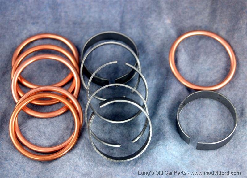

Which is the best to use, the 3 hole gaskets with the internal rings or the individual flat metal gasket with the internal rings?
I know it is a personal preference but which is the most used?

These are far superior to anything else...

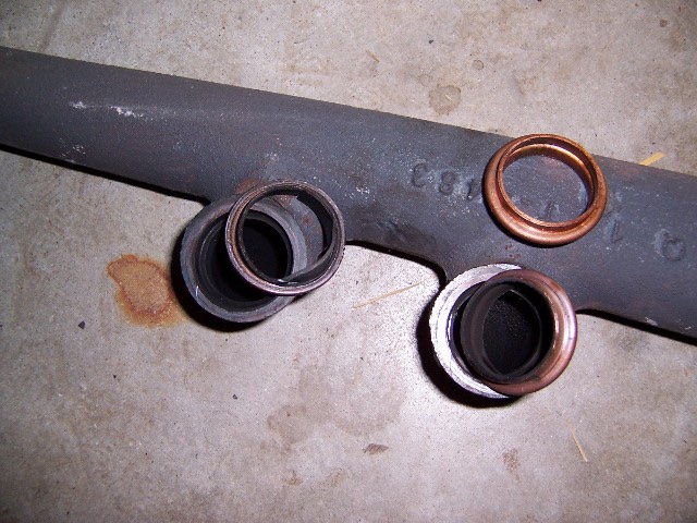

Caveat. These original Ford gland and crush do need proper install. The ports in both the manifolds and block should be clean and deep, without rust or pitting. The gland can be trimmed to fit best, they need to fit fully in the ports, and the crush then can do their work to seal the openings.
Sometimes the glands need straightening and sometimes need expanding or trimming to make them fit satisfactory. Otherwise the crush rings won't compress to seal completely.
And the exhaust manifold is very prone to warping, be sure the ports are in alignment. As for those Snyder's 3063-CR, for me the copper tubing used when formed became work-hardened, and the 'crush' didn't happen. They leaked. The crush rings have a high temp fiber filling, and those never fail to crush and seal. Yes they are one time use, but a new crush ring is only $.80!
Crush Ring on left, crushed and complete seal, One Piece formed copper tubing, didn't fully compress. Leaked.

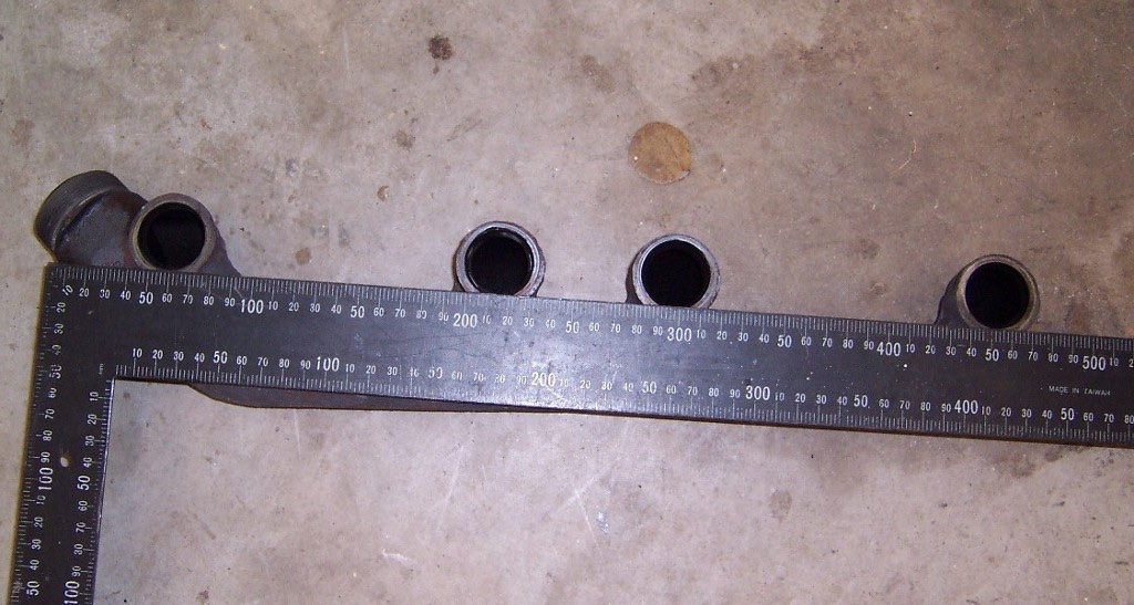

There is one essential when fitting a T manifold. It must be supported with gland rings in the ports. Repeated heat cycles cause expansion and contraction within that long manifold, leading to stresses which tend to bend the manifold. Most are low at the back port to some degree.Often the bent manifold will not allow the fitting of the ear gland. Then you must rely on the clamping force of the nut and bridge to keep the manifold tight to the block. This will work for a while, BUT, that back port is free to move with each heat cycle, making the rear port a prime source of leaks and erosion of the block due to same. The gland ring is needed to stop the port moving with the heat cycles.

Once you have a good installation, preserve it by avoiding running the engine under load with late timing. Running the engine loaded, especially at higher speeds, with late spark timing will make the exhaust manifold run very hot, which will over-expand it and contribute to warping, both of which will tend to loosen the manifold to block connections.

Re: Manifold Gaskets
Exhaust manifolds warped less than ¼" can be straightened. I was once told that straightening burns up more gas than the cost of a new manifold, but that has not been my experience. Somebody else suggested that if a manifold is warped ¼" or more you can straighten it halfway, then come back the next day and straighten it the rest of the way. I'll try that the next time I straighten a bunch. A problem with buying a new manifold is that the only ones being made are the 25-27 style. If you want the earlier type it has to be original.
