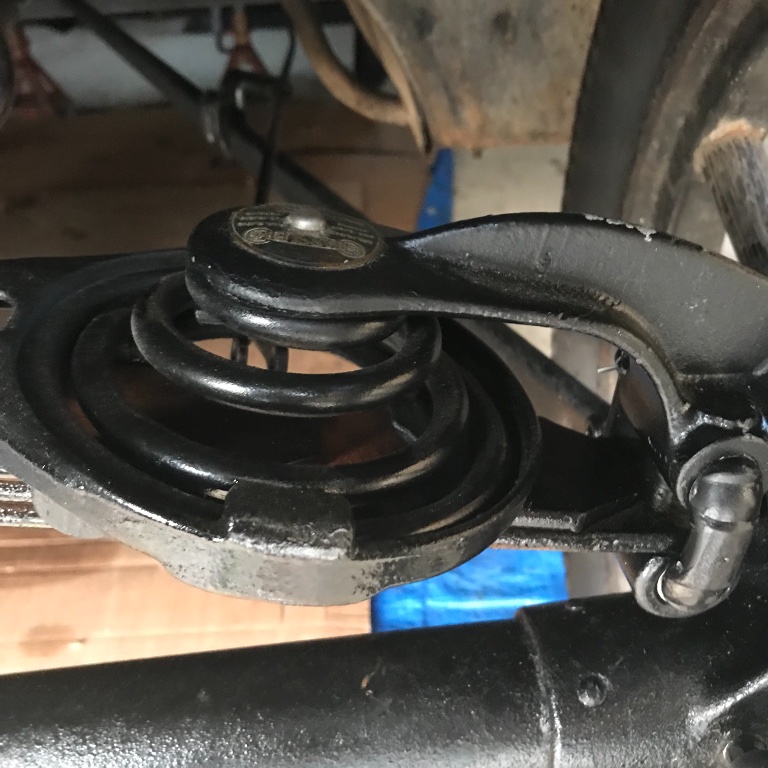

Is there a trick to accessing the flip-top oilers now mostly hidden underneath the rear Hassler shocks on my ‘24 touring?
Do I need to remove the shocks?
Gene

If you lift the car body by the frame with like a 4x4 in the rear, the axle will drop down and open up the spaces between the coils. May work, just a thought. Frank

a large screwdriver that you don't care about and a hammer, or a cold chisel or any flat bar and a hammer will fix that right away.
apply oil to the ensuing hole

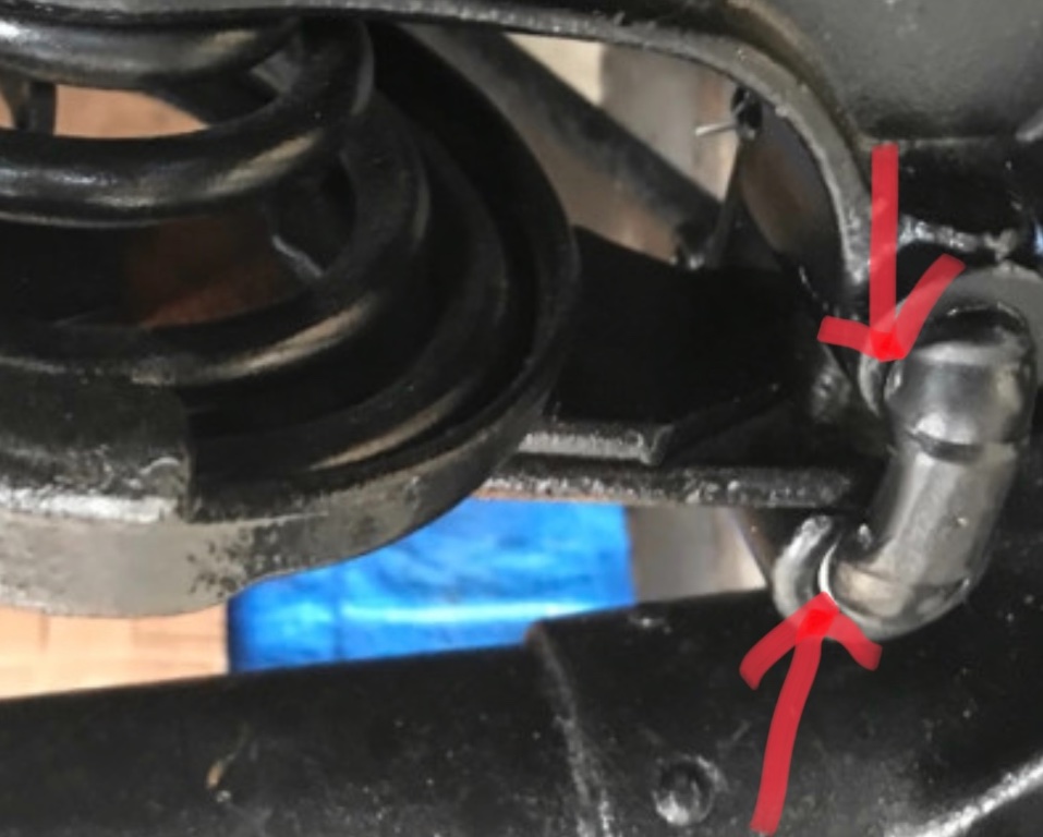

Gene, those guys want you to work up a sweat. Just put some oil here on both sides, it’ll wick in where it’s needed. Your bushings look plenty good from the pic.

What I see is the flip top oiler on top of the spring. It appears to not be set down far enough into the spring as designed. Even without hasslers, there is typically only 1/8" clearance to open & oil. Oiling via the bushing ends is a good way to go, as suggested.

Post by Dropacent » Tue Jul 20, 2021 10:33 am
