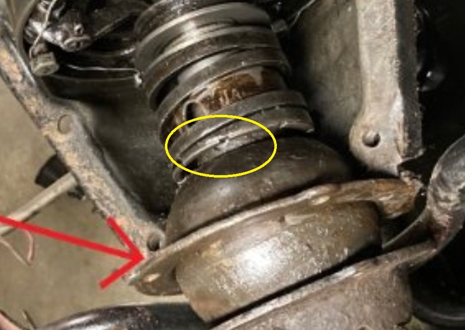

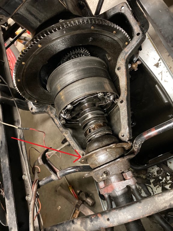

Well I think this is what is called the 4th main, see photo.
I took my hogshead off for a look and to do some repairs see viewtopic.php?f=2&t=22322 if interested.
Anyway I was cleaning up the old gasket on the oil pan today an took all the bolts out of the universal joint because the gasket appeared to be trashed, didn't help as I've sense learned you would need to remove the axle to get at the gasket. Looking around on here and on the web I'm reading about getting the 4th main lined up right are the 4th main and the universal joint the same thing or two different things that make up a unit or is the 4th main something totally different? Just wonder if I may have done something I shouldn't have, don't think so, reading the service manual it says to take all the bolts out the the universal joint to remove the rear axle.
Provided I haven't screwed this up can someone explain how I remove the rear axle so I can change out the universal joint gaskets, I'm not clear on this from reading the service manual, I know how to get the car off the ground, take off the wheels and unbolt the universal joint after that it is unclear to me. I have a 1927 Touring with wire wheels.

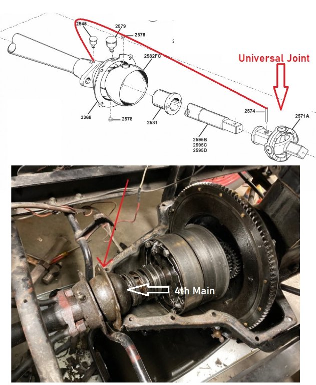

The U joint slides out with the D/S. The 2 bolts top & bottom are plugs to get access to the U joint pin which is peened in place. (See T1 manual)
The 4 D/s bolts are already out. The 4th main has an oil hole that should be up.(incase you turned it). A new gasket can be in stalled by splitting it at the top. Slide the 4th main back a little to install.

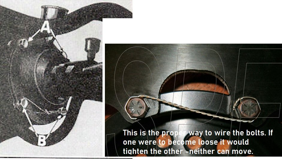

This attachment should help you understand what/where things are. The above explanations of replacing the gasket are well explainedbmklawt wrote: ↑Sat Jul 24, 2021 10:00 pm..... I was cleaning up the old gasket on the oil pan today an took all the bolts out of the universal joint because the gasket appeared to be trashed, didn't help as I've sense learned you would need to remove the axle to get at the gasket.
This the proper way to wire the two bottom bolts - not as shown in the T picture

speedytinc said "The 4th main has an oil hole that should be up." where is this hole?

The oil hole is in the middle of the bearing surface sleeve or tube that the output shaft runs in. You should be able to see it thru the inspection cover.bmklawt wrote: ↑Sun Jul 25, 2021 10:51 pmspeedytinc said "The 4th main has an oil hole that should be up." where is this hole?

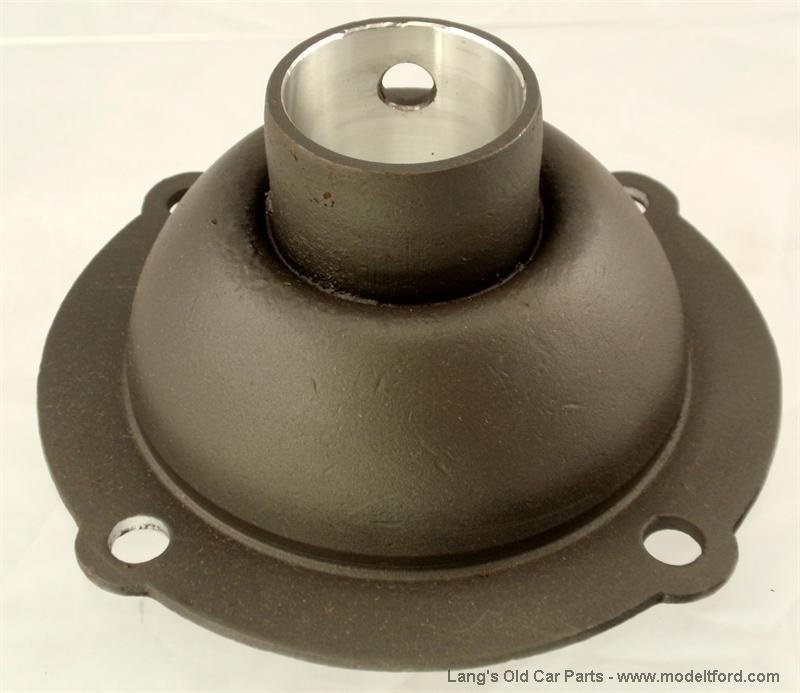

Here is a picture of the 4th Main also referred to as the Ball Cap- sold thru Lang's https://www.modeltford.com/item/3369.003.aspx
AND I blew up your picture and it appears that the hole is currently in the up position.
