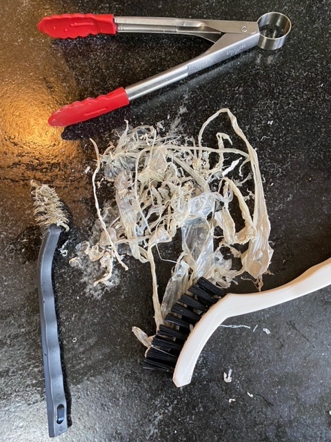

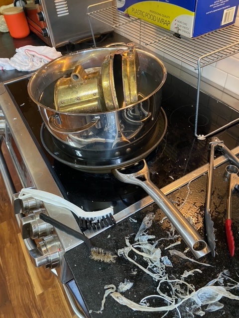

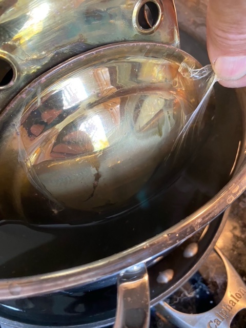

Tom advised me to submerge my failing clear coated 1911 brass in a pot of heated vinegar and, just as he said, the clear coat fell off like a cellophane wrapper. His brilliant solution turned a full day using solvent over and over again on only one cowl lamp into stripping completely clean three lamps in only 2 hours. Thank you Tom Zimmer.
As you can see in the pictures, I used a large frying pan full of water to double-boil a lobster pot full of vinegar. Upon reaching temperature the clear coat delaminated in only 1 or two minutes. I helped it off with a soft brass wire brush and small tongs. This was way easier that I ever expected. However, I should have added to the process some thick dishwashing gloves and full coverage lab goggles.

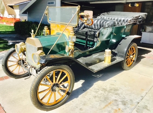

Hello fellow Model T-ers,
I am frustrated. Almost all of the brass on this 1911 Touring was coated with clear coat. Then, the car was left in the sun for 3-1/2 years, so an unnatural tarnish formed under the clear coat (picture #2).
