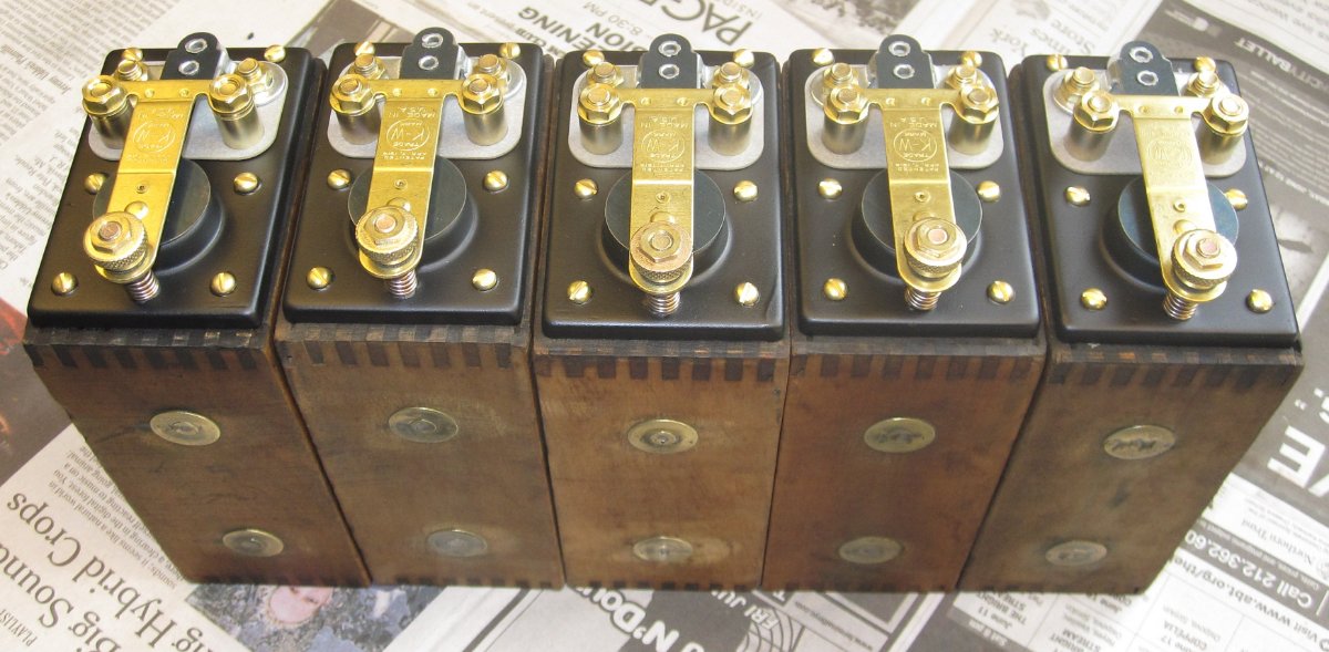

Posts: 7401
Re: Need help figuring out interior linkage for carb adjustment
Post by Steve Jelf » Sun Aug 15, 2021 11:50 pm
Instead of replugging that end hole with a new chunk of brass, I use Stan Howe's method of tapping the hole with a bottoming tap and putting in an 8-32 Allen screw, easily removed for future cleanings. Of course, once you've cleaned the passages they probably won't need it again during your lifetime. :)
Yes, definitely send the coils to a specialist to get them squared away. Any of the coil guys on this page will make them sing: https://www.mtfca.com/model-t-ford-suppliers/
Ron did mine and they are gorgeous.
