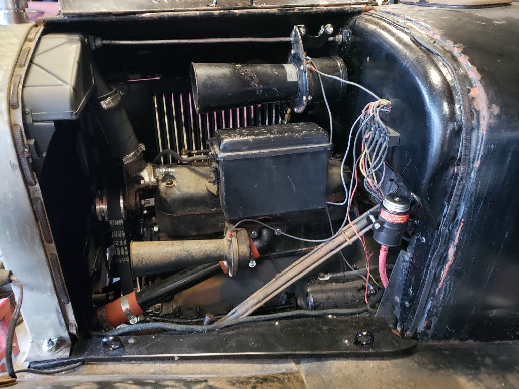

As you can see I mounted it on the firewall outboard of the steering column.
I also used DOT 5 brake fluid and recommend it highly for this application.

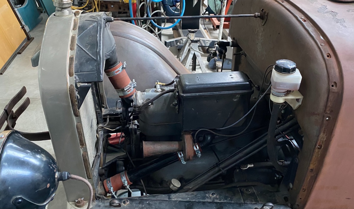

I used the large resv as you can see, tried Dot 5 fluid but could not keep it from leaking around the bleeder screws..using Dot 3 w/no issues.

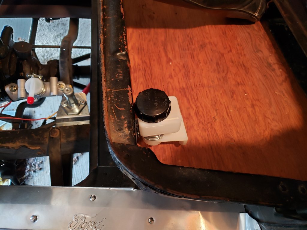

I mounted the remote reservoir under the front seat at the end of the gas tank, mounted to the seat riser. Out of the way and not seen when looking in the engine compartment or potential damage by the hood or engine removal.

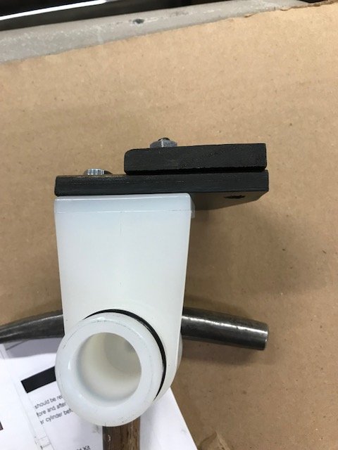

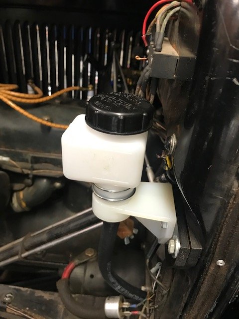

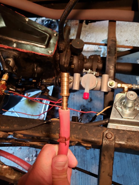

The 26-7 does present a challenge as to the placement of the reservoir. With my 27 Tudor the only logical place was under he hood on the firewall. The spot I wanted to use was, as others have noted, too close to the side and the hood. So I made an offset mounting from wood, painted black, which allowed me to mount on a smooth surface and shift the reservoir to the right. The hose provide reaches the master cylinder perfectly. See photos.

So the one bolt through the wood bracket is what holds it?
jsaylor
Posts: 434
Last Name: Saylor
Location: Citrus Heights, Ca
Re: Sure Stop Disk Brake Reservoir Mounting Ideas
Post by jsaylor » Tue Aug 17, 2021 11:31 am
Mount the reservoir with one bolt through the offset, single thickness. One bolt through the double thick into the firewall. Then and one bolt through the single thickness into the firewall.. In the first picture the one bolt is not the one that I used to hold it on the firewall, used a temporary short one to take the picture during mock up. Hope that makes sense.

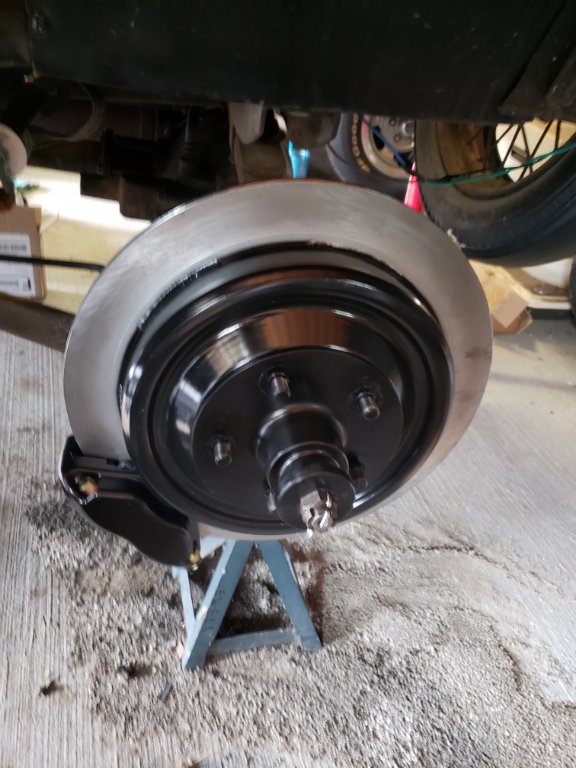

So, Last night I went to install the calipers. The instructions say to use a 3/8" x 1-1/4" bolt. The kit supplied 1- 3/4" bolts. 1- 3/4" is too long, 1- 1/4" is too short. So off to the hardware store this am to get some 1 1/2" bolts.

Use the washers that they supplied as spacers and stack them behind the bolt head to get the right length.

Mine custom bodied drop-side truck has the reservoir mounted on the wooden firewall.
I didn't want to see the plastic reservoir so I opted to use a metal reservoir.
While not completely period correct, it's closer than the plastic part.
Look up EZ Fill Reservoir on eBay or Google.
Looks like the price has jumped up since I bought mine. Ouch.

For me, the disks are ok. I painted the calipers black to eliminate the bright Wilwood lettering. Never understood why so many hate the obvious disks. However, the big white plastic reservoir is just not happening.
We have 9 cars, most are toys. Two had all wheel drums that I converted to power front disks. It's not stock, but it's safe. I've added 3 point belts to some that had either lap belts or none. One of my early 5.0L I converted to SVO front disks. Never has anyone said to me that these were mods that weren't stock and was a terrible thing to do. The mod on my 74 Bronco would make a stock purist cringe....my mods were done 70s style, not rock crawler.
I'm trying my best to keep the T stock while still safe. It has a Ruckstell and decided against the Rockies due to safety.

To close the loop here. I didn't have to drill a hole. I replaced the steering column mounting bolt with a longer stainless one and stacked two nuts to space the bracket out for clearance on the firewall (see pics). Just need to check adjustment and bleed then done! According to the seller, the reservoir is a 1920s accessory commonly used on Chryslers. I don't know but it fits well under the hood and looks terrific!

Nice vintage look ! Wish I could find one when I install those brakes on my 27
Posts: 7035
Post by Allan » Sun Sep 05, 2021 8:00 pm
That's about as neat as you can get! Nice result :)

Post by Mikey1968 » Mon Sep 06, 2021 10:10 am
Thanks, all. I had to use a 1/4 to 3/8 inch barbed splice fitting to adapt the hoses.
