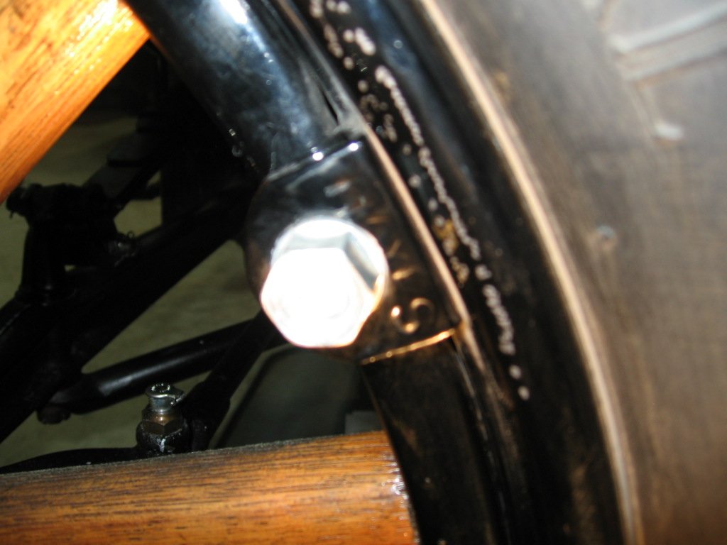

I've been fortunate in that I haven't had any issues with demountable wheel lug nuts loosening. I do check and snug them a few times after replacing a rim.

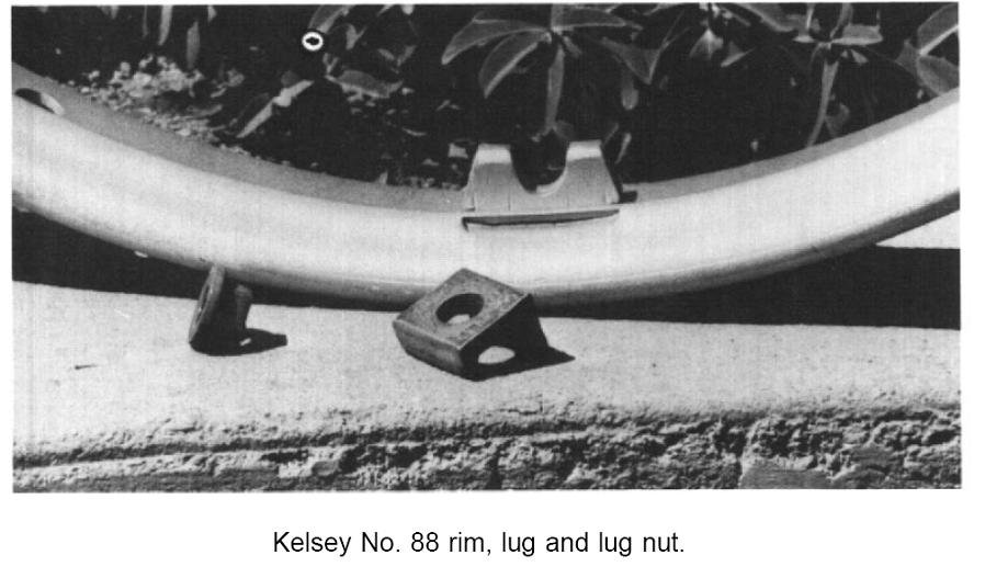

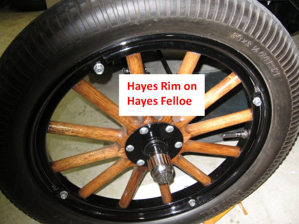

If you have Ford or Hayes style rims where the lugs are part of the rim and the nuts are conical on the back, do not tighten down the nuts to the point that you bend the lugs. There will be a gap between the lug and the rim when the torque is correct (see first two pictures).
If you have Kelsey rims with detached lugs and flat-back nuts, then the lugs do make firm contact with the rim and the raised notch on the inside of the rim (see second pair of pictures).
In either case, mild thread locker certainly won't hurt, IMO. :)

Kelsey 88 rims and loose lugs can lead to loose nuts. If there is any movement between the lug and the rim, the land on the rim wears. This wear can lead to the lug not tightening down on the worn land, and the nut can back off.

Mark, on or Canadian sourced Kelsey loose lug U shaped clamping pieces do NOT contact the outside of the felloe, unless,
a. The feet on the U shaped lug are worn, allowing it to go further on to the wheel bolt.
b. The land on the rim on which the short leg of the shaped lug has been worn, allowing the lug to go further on.
c. both the lug and the rim are worn.
Kelsey loose lug rims wedge onto the outer lip of the felloe. It is this wedging effect whicha llows the transmission of driving force from the wheel to the rim. If the lug was to be hard against the felloe, there may well be no tension in the assembly to maintain the wedging effect. With worn feet on the lug, worn lands on the rim, and lgs hard against the felloe, the rim cold well be loose on the wheel.
The same goes for fixed lug rims, except that these wedge on the wider inner land on the wheel felloe. The lugs stand off the felloe somewhat, unless the rim has been loose and it and/or the felloe is worn.
The wedging of the rims on their correct felloes is what must be maintained for any mix of components. It works for some mixes, but not others.
