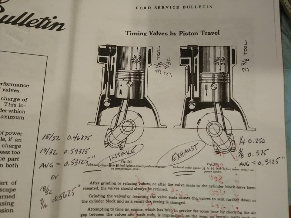

"The method of accurate valve timing on a Model T Ford engine is to time the valves by piston travel" per Ford Service Bulletin released December 1924. It accommodates a worn cam, but also works with a new standard cam. I figured out an alternate way to use the KRWilson method of adjusting 'valve timing based on piston travel'. I am using domed high compression aluminum pistons, so I couldn't use the tool designed for standard flat top pistons. I designed and fabricated an adjustable tool which registers off the top of the domed pistons. It's based on the inlet valves closing at (9/16" piston travel) past lower center on compression stroke and the exhaust valves opening at (5/16" piston travel) before lower center on powerstroke (dimension appropriate for motors later than 1913 Model)
. Here is the original method described in a 1914 Ford Manual
These next 3 images are from the Ford Service Bulletin .

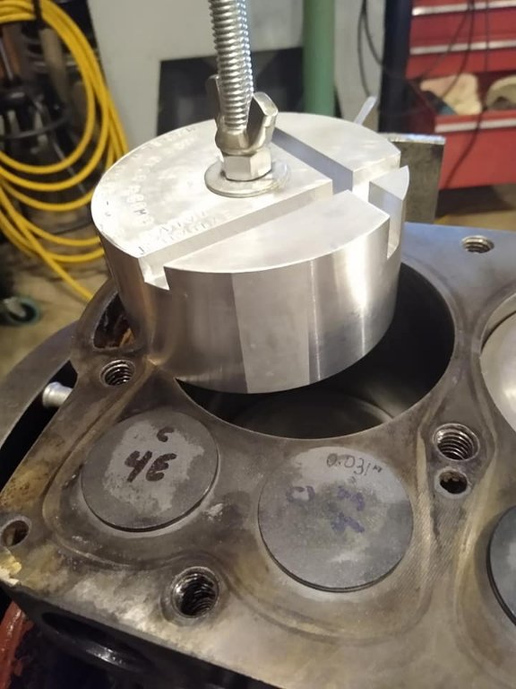

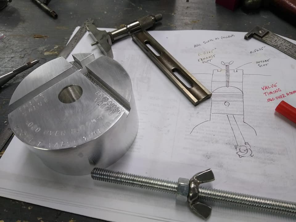

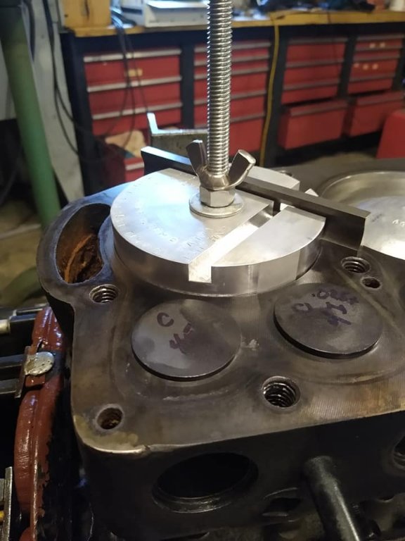

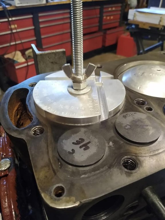

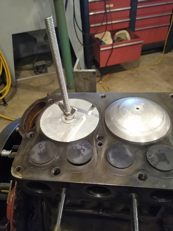

. Here's the tool I created to use with my domed high compression pistons
The tool has two grooves machined in the top. One 9/16" deep (inlet valve adjustment groove) and the other 5/16" deep (exhaust valve adjustment groove)

Tool inserted in the bore with piston at 'bottom dead center'. Threaded rod adjusted and locked with the top of the tool even with the top of the block.
. The crank is positioned with the tool up 5/16" before lower dead center on the powerstroke, which is when the exhaust valve opens.

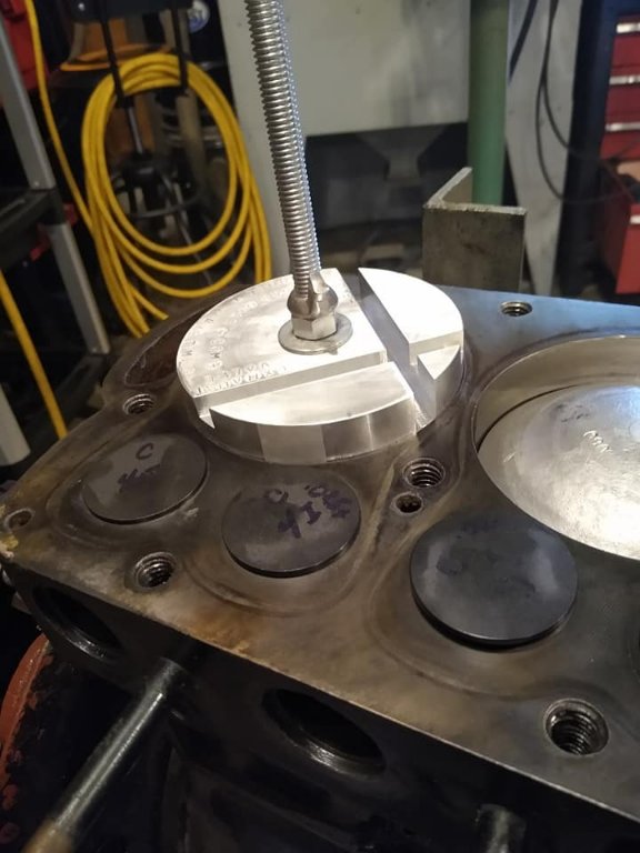

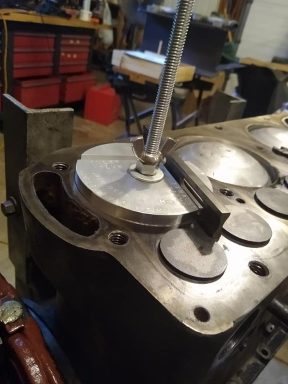

. Using a parallel bar to check for groove position relative to the top of the block
Then adjust your exhaust valve to be touching the valve seat by feeling friction as you push on and rotate the valve
. Crank positioned so tool is up 9/16" past lower dead center on compression stroke, which is when the inlet valve closes.
. Again, Using a parallel bar to check for groove position relative to the top of the block
Then adjust your inlet valve to be touching the valve seat by feeling friction as you push on and rotate the valve

Here's a sketch of my tool in the cylinder
After all valve adjustments were completed, I double checked the valve lash gaps and compared them to the gaps listed within the original manual - all within the range listed!!!
