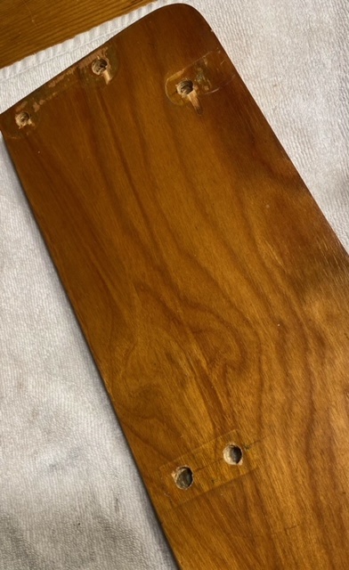

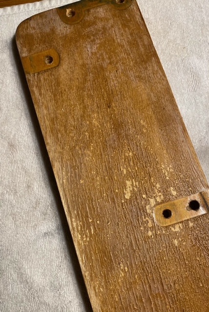

Would any of you know what type of “final clear finish sealer” (shellac, varnish, urethane, epoxy) I should put on my 1911 Touring Car’s two piece dash/firewall after it is stained?
I will soon be refinishing the two-piece wood firewall/ dash on my 1911 Touring Car. There are example photos of the current front side and the back below.
Would anyone here be able to steer me to the correct 'wood stain color' and a good product to use? I would also like to know what type finish (shellac, varnish, urethane, etc) to use on top of the stain? It would be nice to get this right the first time. Smiles.
Thank you in advance for any guidance you might be able to offer.
