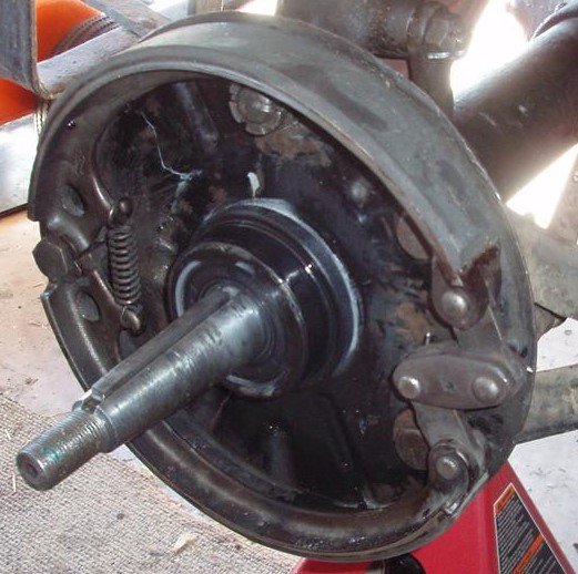

I will be working on a TT chassis tomorrow. One issue: when we pushed it in, The right brake shoes activated. The cam lever had to be jiggled to free up. I know nothing of TT's. The owner & an assistant with no T knowledge have been working on it. There are no brake shoe return springs. Missing? Not in the design? Any thoughts?
- Posts: 1211
- First Name: Adrian
- Last Name: Whiteman
Re: TT hard to push?
The springs will be missing. They are heavy duty ones to match the shoes size.

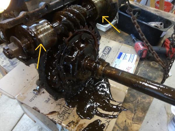

We could not push this TT either. It is a 'barn find' in beautiful original condition with a lovely locally made Kauri wood cab and deck.
Under the gunk the hyatt bearings on the worm drive shaft were rusted and seized. It looks like water had entered the upper worm housing and sat there for some time. Cleaned and replaced with 'spares from the box' this one runs well now:
