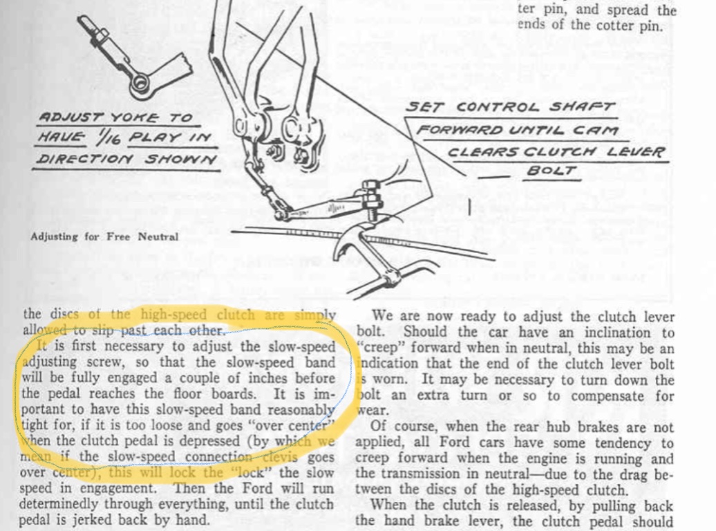

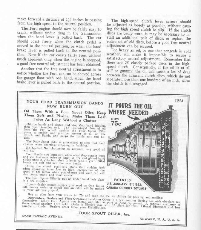

It has been a while since this has been posted:

Dan Treece wrote ^start the engine and with the engine running" If you try to adjust the low while the engine is running, be sure to jack up the rear wheels because, if you should get the adjustment too tight the car might start to move with you leaning over the transmission and before you can stop it, you might get run over or the car might crash! So if you do it with the engine running, be sure to block the front wheels and jack up the rear wheels!

The car can be stuck in low if the linkage between the pedal and the clutch shaft goes over centre. Adjusting the bands may stop this. If not attention needs to be paid to the pedal/shaft linkage. If going over centre is the cause of the car staying in low gear, the diagnosis is pulling the pedal back up to see if it disengages. Replacing the spring on the pedal shaft will have no effect if this is the problem.
