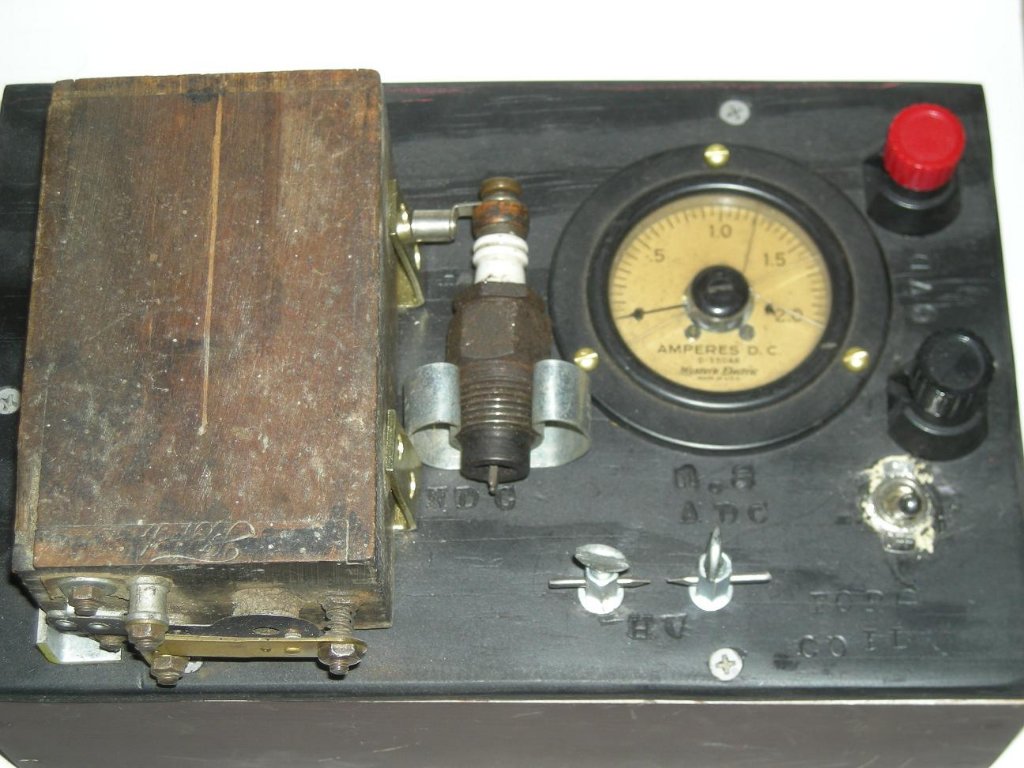

I have had my T for a few years. I was given a factory HCCT from an early Ford dealership. At the time the fellow stated that even in its day, the mechanics and customers found it more of a conversation piece.
I even today, the HCCT tester sits on a shelf, and I use a hand built test (I believe it is called a buzz box tester)to test and set up my coils.

A Buzz box makes the coil go "buzz", and you can set the current draw.
That is as complete an adjustment of a coil as changing spark plugs is an engine rebuild.
