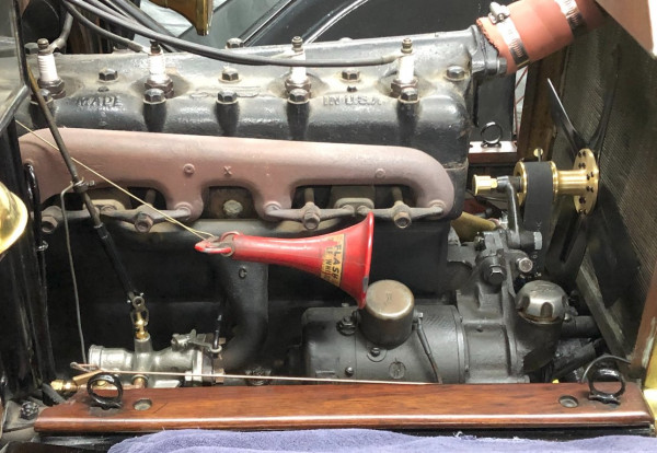

And I start my ‘14 yet another way. Royce taught me to choke it 4 times with the ignition off. Often I’ll have a free start when turning to BAT but, if not, I’ll insert the crank at the 3 o’clock position and slam it down with my foot. This is both safe and provides a greater spark due to the speed of moving the magnets compared to hand cranking. I might also mention my right hand was mangled in an accident.

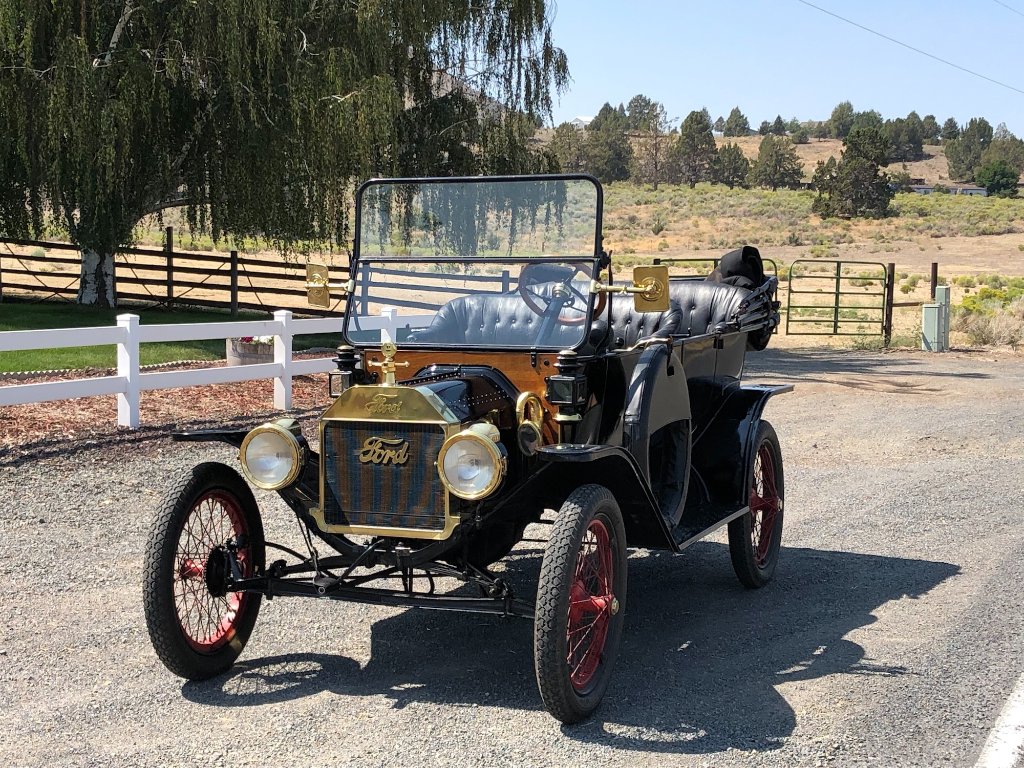

Inspired by the discussion here I tried starting the 14 with the crank for the first time yesterday. Before this, I had always used the electric arm which works well. It was awkward grabbing the handle with the left hand and keeping the thumb on the safe side. It took a few hard pulls from the 9 o'clock position but it did fire. Then while I was standing there admiring the roaring clatter as the motor roared to life it started to falter & I remembered the drill of running around to advance the spark.
I did it a second time just to make sure I could do it. This was a warm motor just back from a run flushing the radiator so it was not a cold start.
I imagine this is one of those things that just needs practice. I have seen many T folk swing the crank easily with good results. There is a knack to master.
