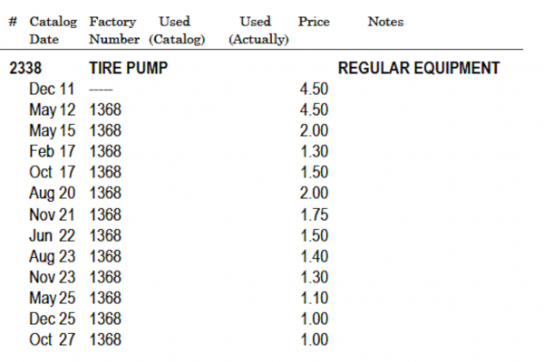

Re: Original T Tire Pumps
Here's a list of parts books that show them. Bruce's encyclopedia has a few pictures in the Parts section, but they're not all shown, so I can't tell you when they changed from double cylinder to single. My reproduction includes the Ford part number on the bottom, so I assume it's a pretty accurate copy of the original.

Generally the brass single tube, was painted black for claimed for 1917 (but perhaps is as late as 1920 based on Ford print) -1925. Then all steel tube painted black '26-'27.
But according to the various prices over the years in the Parts Books, maybe the $2.00 plus prices reflect the dual pump? The lowest prices of $1.00 are the all steel tube pumps.
Haven't read any publications with ref. material from Ford, but maybe someone has done it?

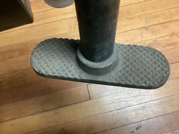

these are Ford script on base.

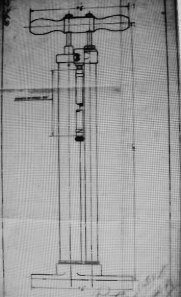

The Ford print T-1368 is noted showing the new single tube Ford design pump, drawing is dated Feb. 21, 1920. So later T's likely had the single pump*

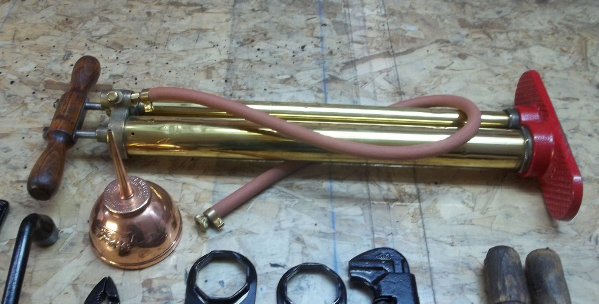

Jim, here is a photo of the pump for 1913. It is a "Bridgeport pump." I hope this helps. Russ Furstnow

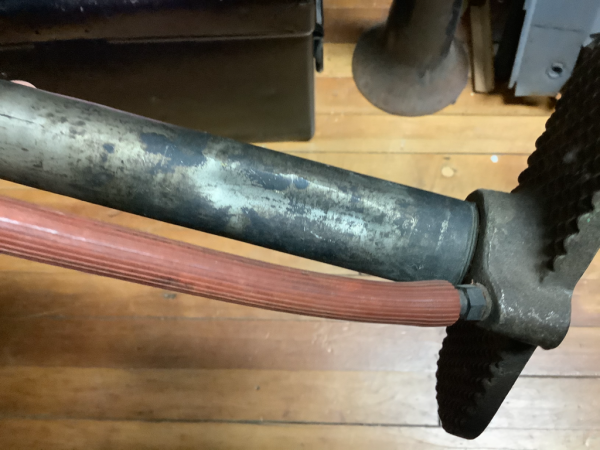

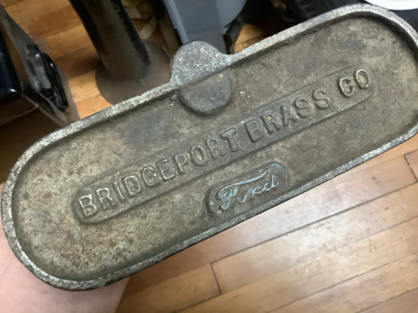

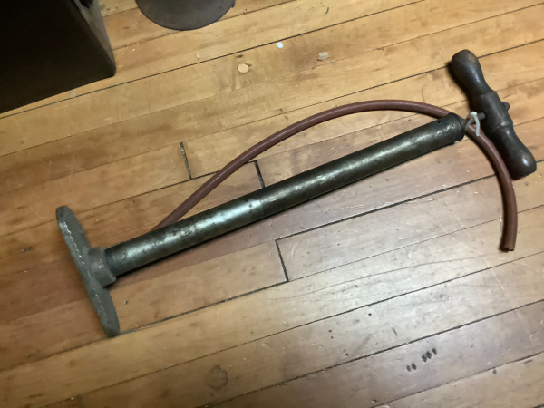

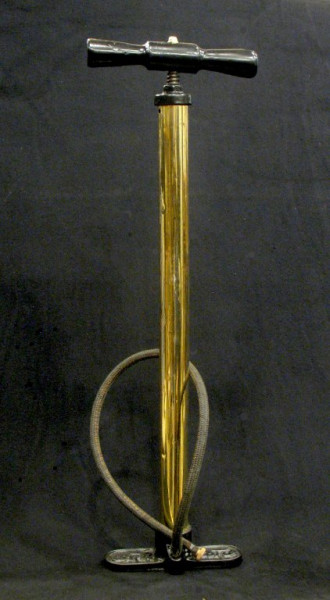

I’ve never been able to date or identify this one. Only one I’ve ever had, totally nickel plated single barrel Bridgeport Ford script. I’d love to know more about it.
