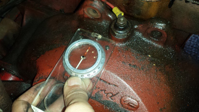

You will need the 36 volt and the amperage that the lead-acid batteries can give.
Here i did it with a compas. You may imagine how to do it without the hogshead, but you will have the better view of the magnets to make sure they are positioned perfect out of the coils.
I gave it 3 flashes in the top terminal and without the hogshead it is the large blank metallic spot on the top of the coilring.
After the operation, that took 10 minuttes or so I meassured the output: It may not give same performance as individually charged magnets, but it is so easy to do, so it's no worry. Just do it!
Then position the flywheel and the magnets right in relation to the coils is important. Here i did it with a compas. You may imagine how to do it without the hogshead, but you will have the better view of the magnets to make sure they are positioned perfect out of the coils.
