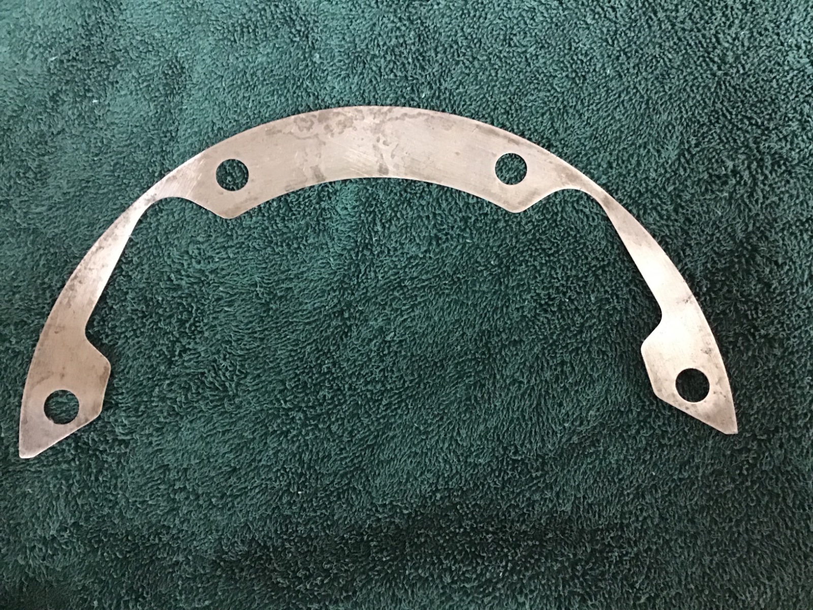

We normally end up using shim stock of .002, and .001. That would make 4 points 9, 11, 1, and 3, perfect, with a .030 thousandths gap.Mark Gregush wrote: ↑Mon Mar 18, 2019 7:37 pmWe are thinking about having some of the shim/spacers made up. The one piece shim. The originals I have are .015. They would not take the place of the brass laminated shims but would supplement them. This was original to the T engine. Ford part number 3272.
Question, would there be a market and if so what thickness would people like to see?
Mark
The mag coils that are between 9, 11, 1, and 3, are filed down, a few thousandths to the same height, if needed, as the Dial Indicator reads, on the 4 standards.
The two on the bottom will read from not under .006, to not over .010.
No matter how you do it, they have to sit 24 hours, to let them Acclimate, they can, and do change a little, they are cast Iron.
You can already buy .010 thousandths in Steel, in a horse shoe made for the Model A Flywheel housing.
Some spacers shims, for major height adjustments would be handy, and for me would be the fine adjustment shims of .002, and .001.
Thanks Mr. Mark,
Herm.
- Attachments
- 127_2739.jpg (15.27 KiB) Viewed 7731 times
Topic author - Posts: 5539
Re: Steel shims between coil ring and block
I will be keeping my eye on this and see how the feedback goes. Thanks Dan for posting the photo. I forgot my camera at the shop and was going to do same.
Mark

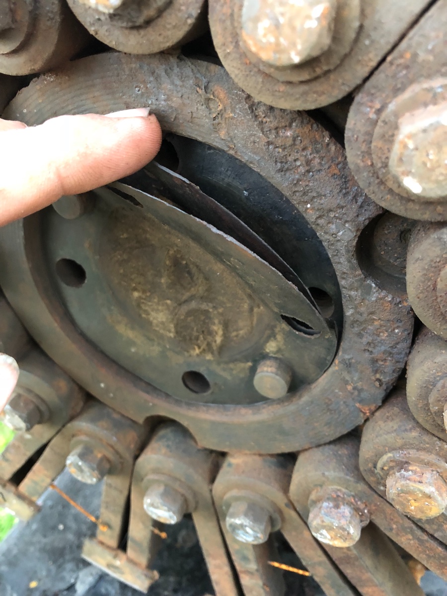

I found these paper shims between the flywheel and crank the other day.
