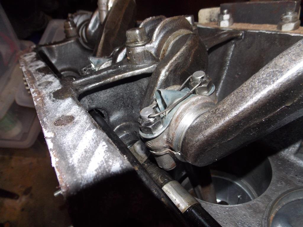

Motor is a fresh rebuild by someone else. I dissembled & fixed what was missed, like slightly bent rods & completed. New time saver bearings. All new. DM bronze gear @ .006. Stipe 280 super (all cyls ckecked to perfect spec)Piston/head clearance checked W/O head gasket. Rods checked .004 piston clearance. Sounded like a loose crank pully? Possible over advancement on timing lever. possibly worse on bat. Set up for mag (15 motor)
Didnt hear any unusual noise before I released it. Had a Montana buddy confirm this. Idont know if the noise is gotten worse. I do know it can be made noisy @ full(over?) advance. I suspect more so on battery. New day timer. I saw 3 videos today & have not gotten feed back to my questions yet.
This more complete picture may have you guys figure it out before I even see it for myself. I will also follow this thread for possible issues missed.
This is more MY problem than his. Its unfortunate that he cant enjoy his T right now.
I just got out of the hospital Tuesday form a 6 day vacation & havent got to see it yet. I hope to be able to lay hands this weekend with my seeing eye dog.

Craig installed the motor & alt. Ran it with no issue or noise, I believe. I removed the alt(not charging), replaced pulley. Fan position changed W new belt. A bit small for my taste. @ acceleration horrible noise. Fan sucked into radiator wire mount tab, Fixed that? Fan pulley got loose & clangy. Replaced that. Newer pully loosed again?? If so, why? Maybe a new billet unit?

Re: Engine noise from freshly rebuilt engine.
A while ago I was working on an engine that made about the same noice when running.
Took it all apart and only when I put the second piston back in place I found the noice.
I was one of the rod bolt head that touched the camshaft. Grinded the head and the noice was gone. See photos .
Just a sugestion where to look.

- Posts: 6559
Andre
that is an astute observation. Considering most every other suggestion has already been checked for, this is quite plausible.
