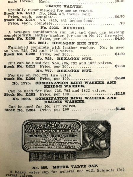

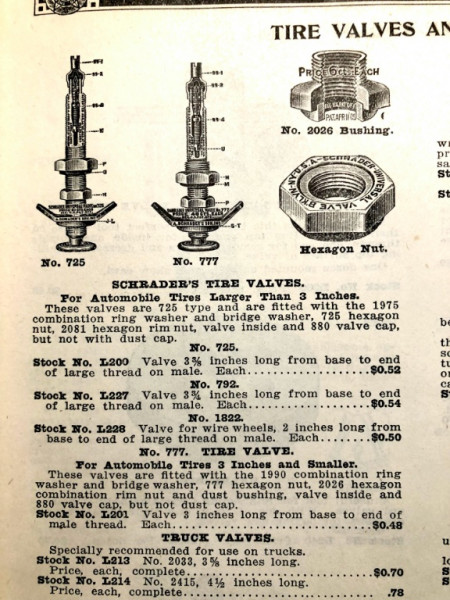

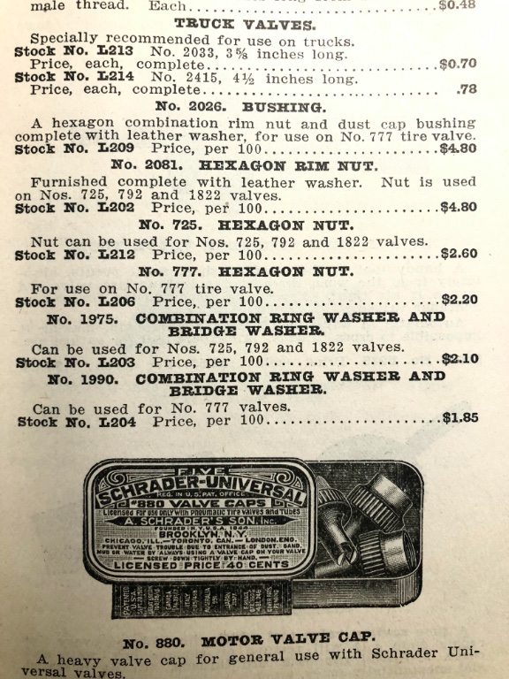

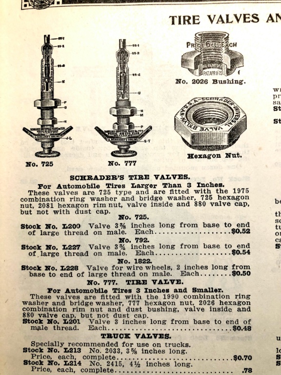

- Posts: 3993
Re: 30 X 3 1/2 Metal Stem Tube Source
Period catalog from an auto parts supplier. Lists the Schrader 777 for the little tires. 3" and smaller.
And the 725 for the big tires. Larger than 3". Couple of stem lengths for felloe thickness, and small length #1822 for wire wheels.
And the 2026 (rim nut) Bushing pictured is for the 777 stem, the 2081 Hexagon Rim Nut for the larger 725
