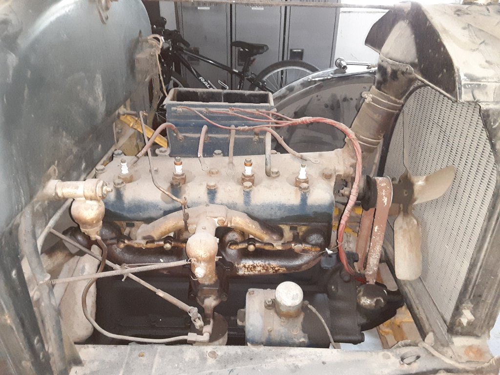

The first photo is of my Mom and Dad with the coupe in 1959 during the 75 anniversary of my home town in North Dakota. It was in the parade. It hasn't been run in the 62 years since. Hopefully, it will be in the next few months. The second photo was taken last fall just before we started to disassemble it.
- Posts: 8626
Re: My 1927 Model T Coupe Restoration

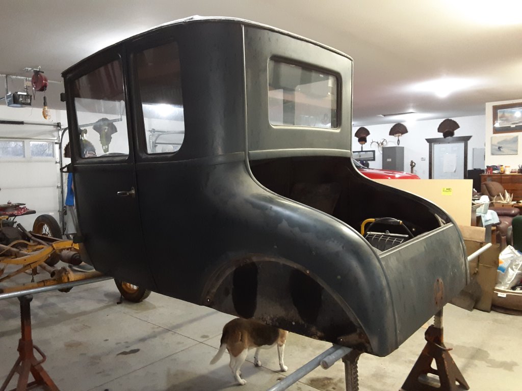

That's a very solid looking vehicle. How did the chassis come to be painted?

Last one for now. The frame has not been painted. It has just been blast cleaned to bare metal!

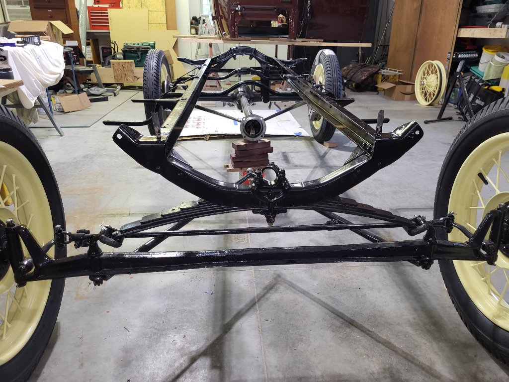

BLB27
Topic author - Posts: 892
- First Name: Bruce
- Last Name: Brakke
- Location: Ames, Iowa

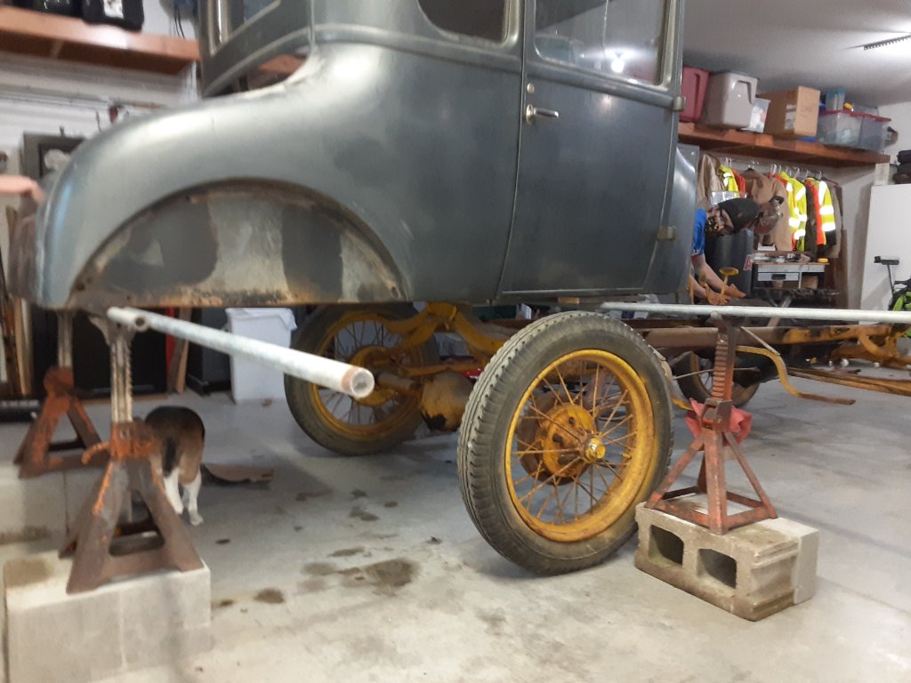

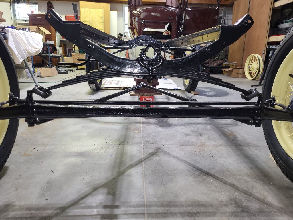

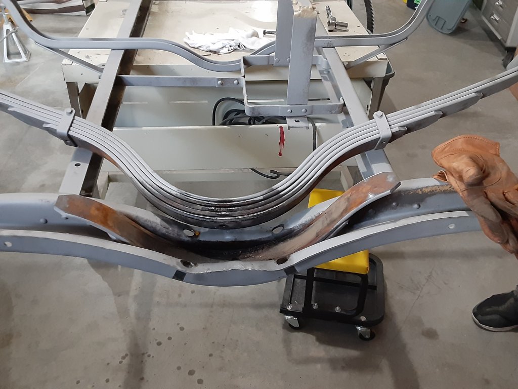

One small step for the restoration project. One large step for us.

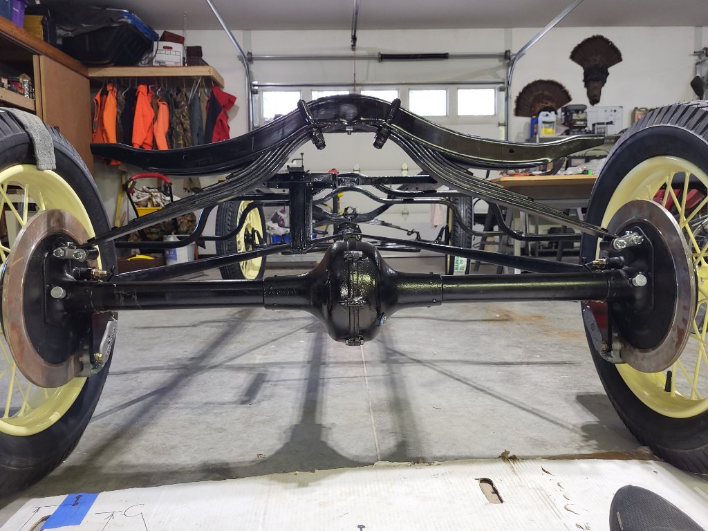

Wow you guys are fast. Nice work on the frame. Are you going to pull the rear end apart?

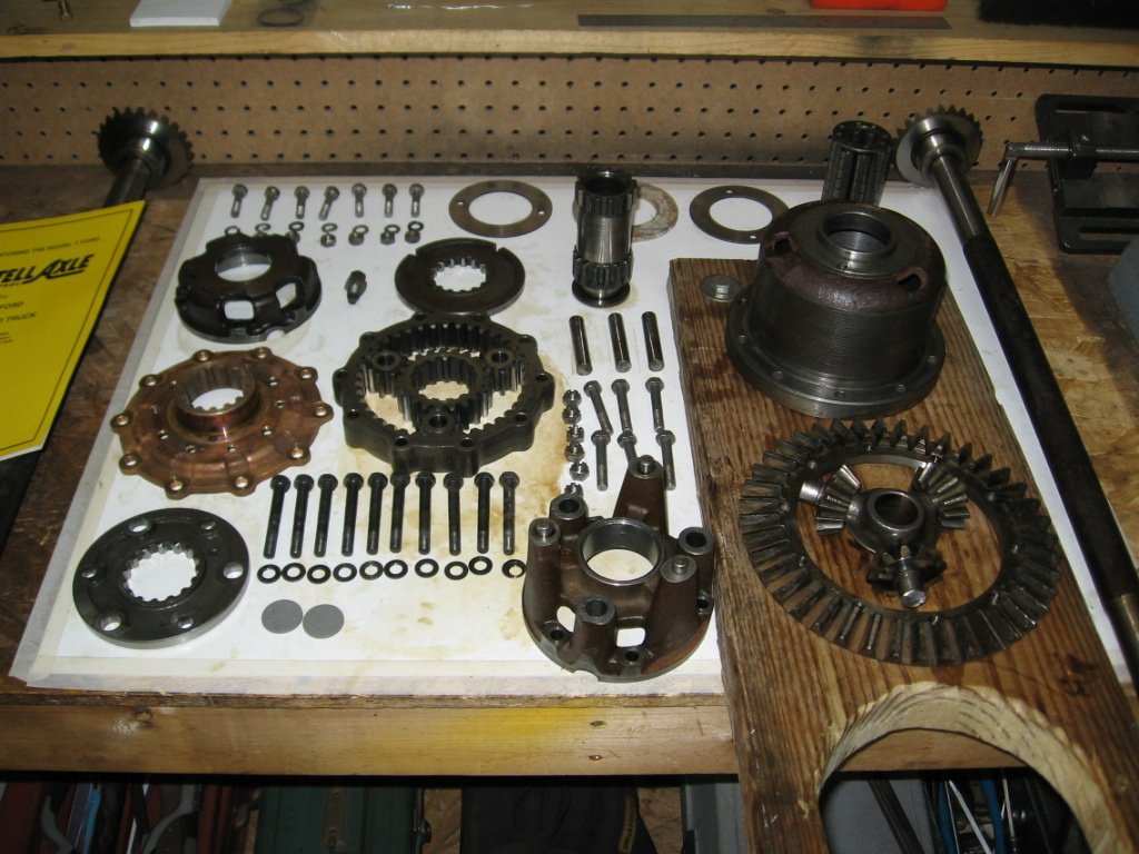

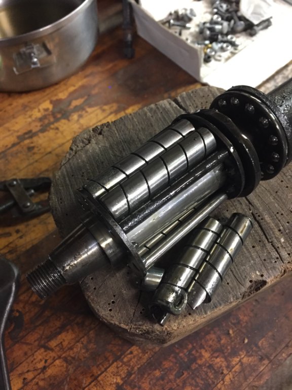

Robert, I have watched the three Model T-Tips videos about rebuilding the driveshaft/rear axle and am undecided on what to do, do it ourselves or by a professional.
- Posts: 2549
- Last Name: Strange
- Location: Hillsboro, MO
- Board Member Since: 2013
Based on the pictures you have posted, doing the rear axle will be a snap, just dive in and learn. When I broke an axle shaft on my standard rear end, I decided to buy a used small drum Ruckstell and rebuild it to install in my T.

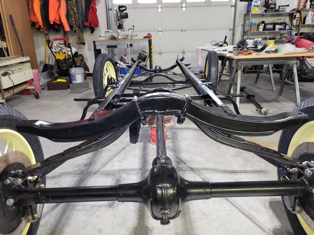

BLB27
- First Name: Bruce
- Last Name: Brakke

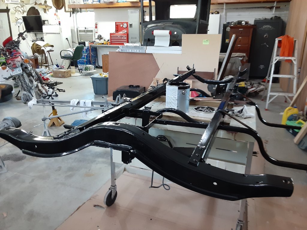

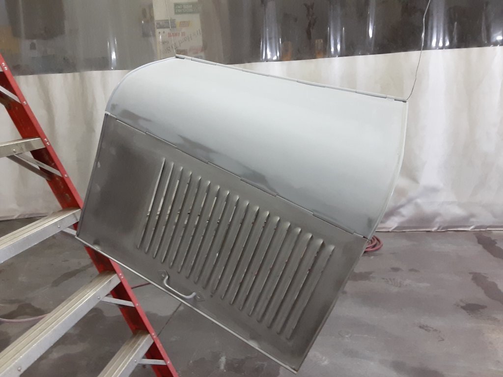

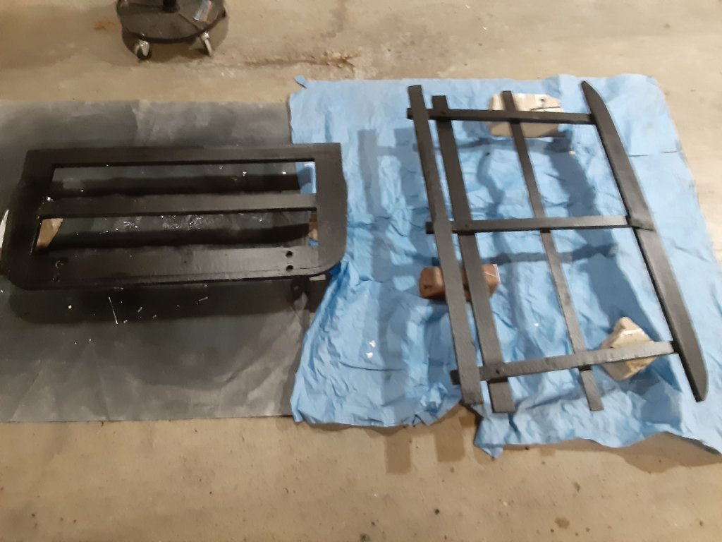

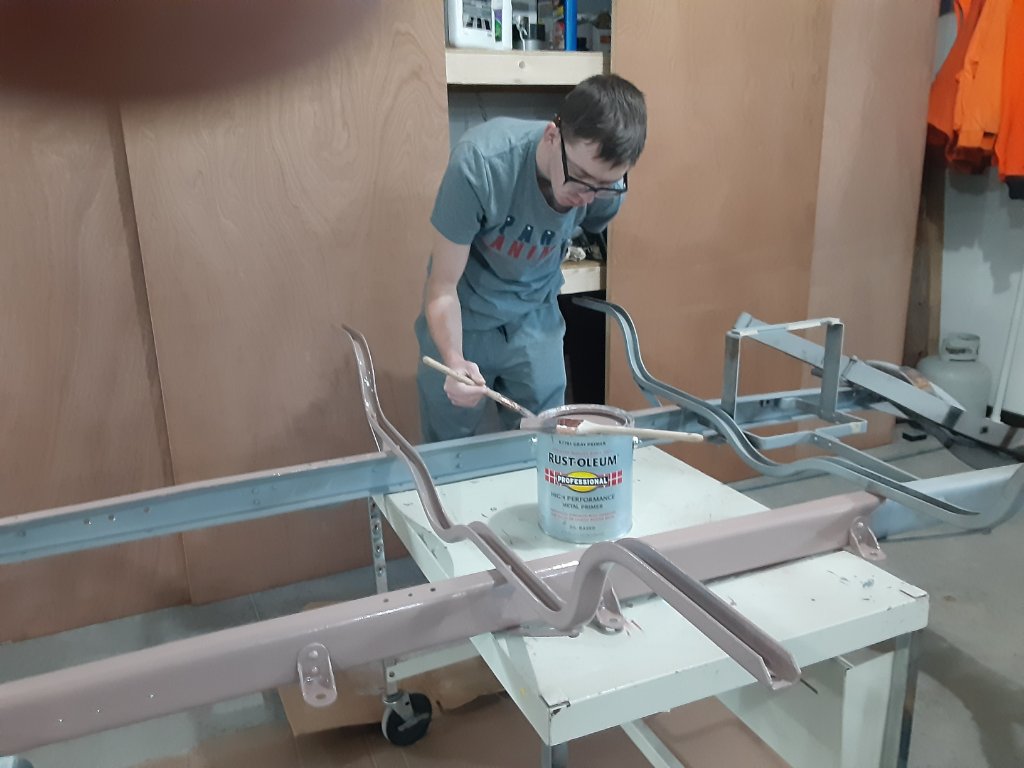

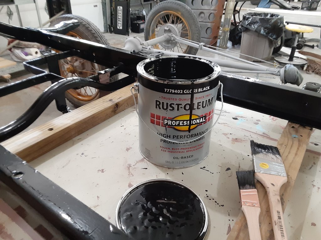

Prime coat being applied. The odd color of the prime is because I tinted the gallon of gray with two half pint cans of rust color. I did this because the gray was almost the same color as the sandblasted bare metal.
jiminbartow
- Posts: 2478
- Last Name: Patrick
- Location: Bartow, FL
Brush applied Rustoleum Gloss black Enamel. Great choice. Looks great! Jim Patrick

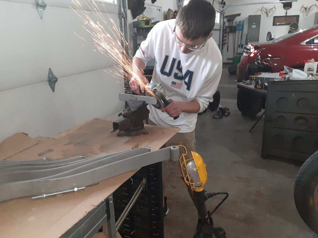

I do hope young Bruce Jnr is wearing EAR PLUGS while using the Grinder, Great thread..n.

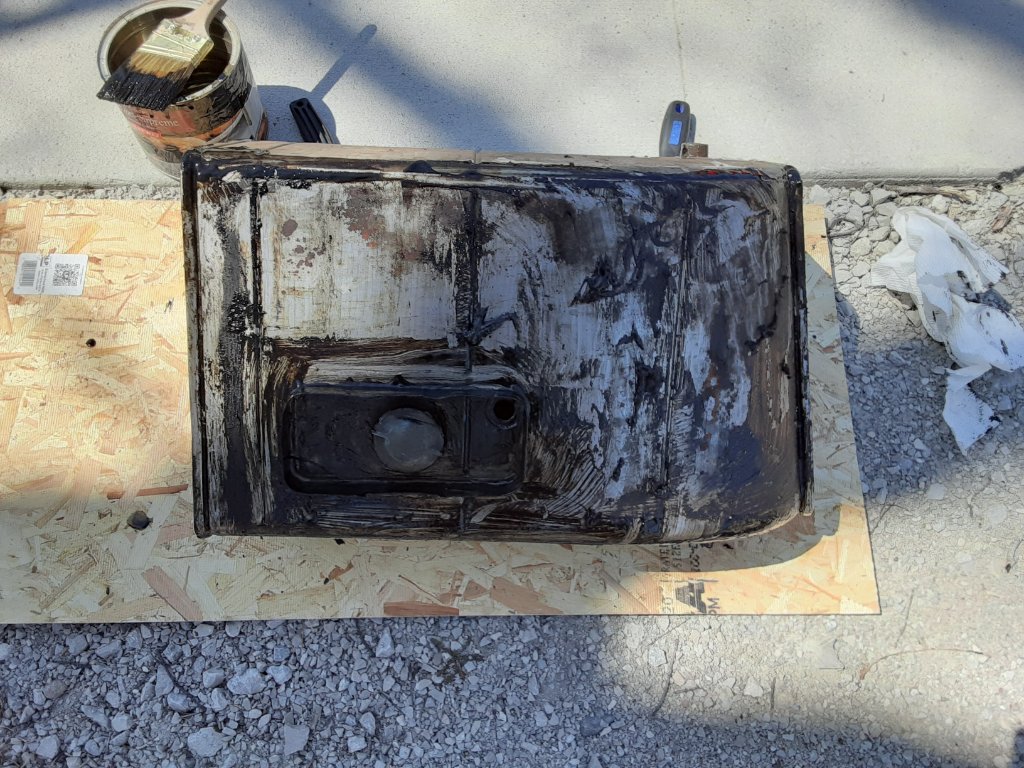

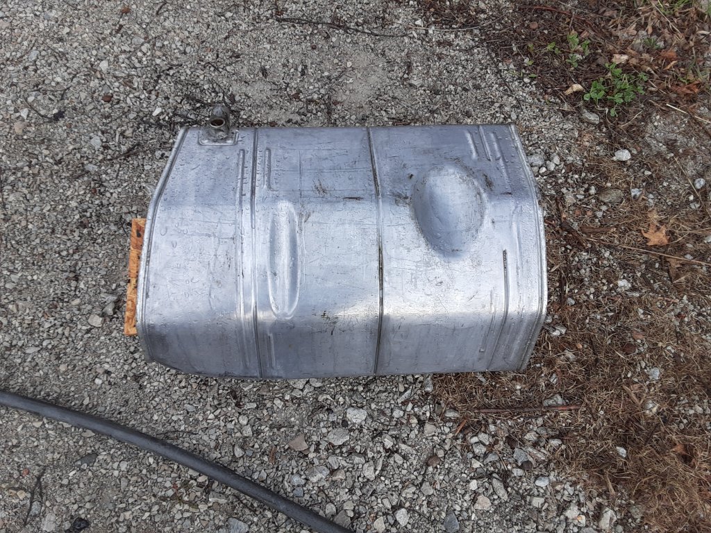

Did you check out and clean the gas tank? If old fuel was left in the tank, it could set up like varnish and be very hard to clean. Also the fuel line and vaporizer must be completely clean too.
If the tank had been drained, it could have had water or condensation in it causing rust.

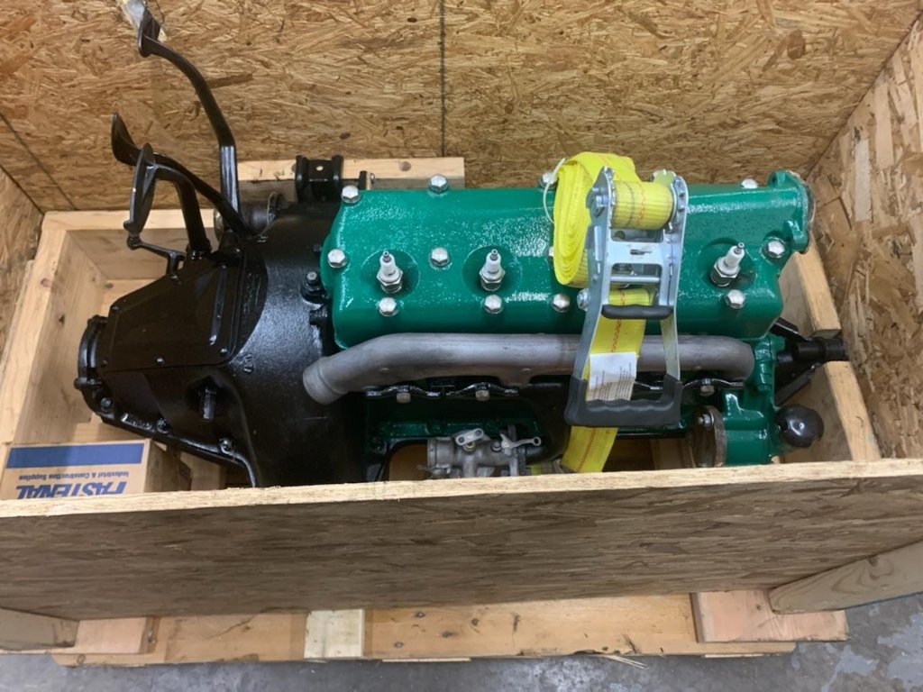

Up date. A photo by the rebuilder showing the engine being boxed for shipment to me! I am anxious to see it!! Complete rebuild with new upgraded camshaft. I shipped it by Fastenal and being returned by Fastenal. I found them very accommodating and very reasonable cost wise.

The rebuilder send me a video of the engine running at his shop. I LOVED the sound after 60 years of not hearing it!
I wish I could share it with you here.
- Posts: 2842
- First Name: Dallas
- Last Name: Landers
- Location: N.E. Indiana
That will give it a new life. Its exciting to get a good power plant and hear it run the 1st time. Makes me smile every time. Thanks for the update. Keep em coming. I have been too busy for T time this fall but enjoy others progress almost as much as my own.

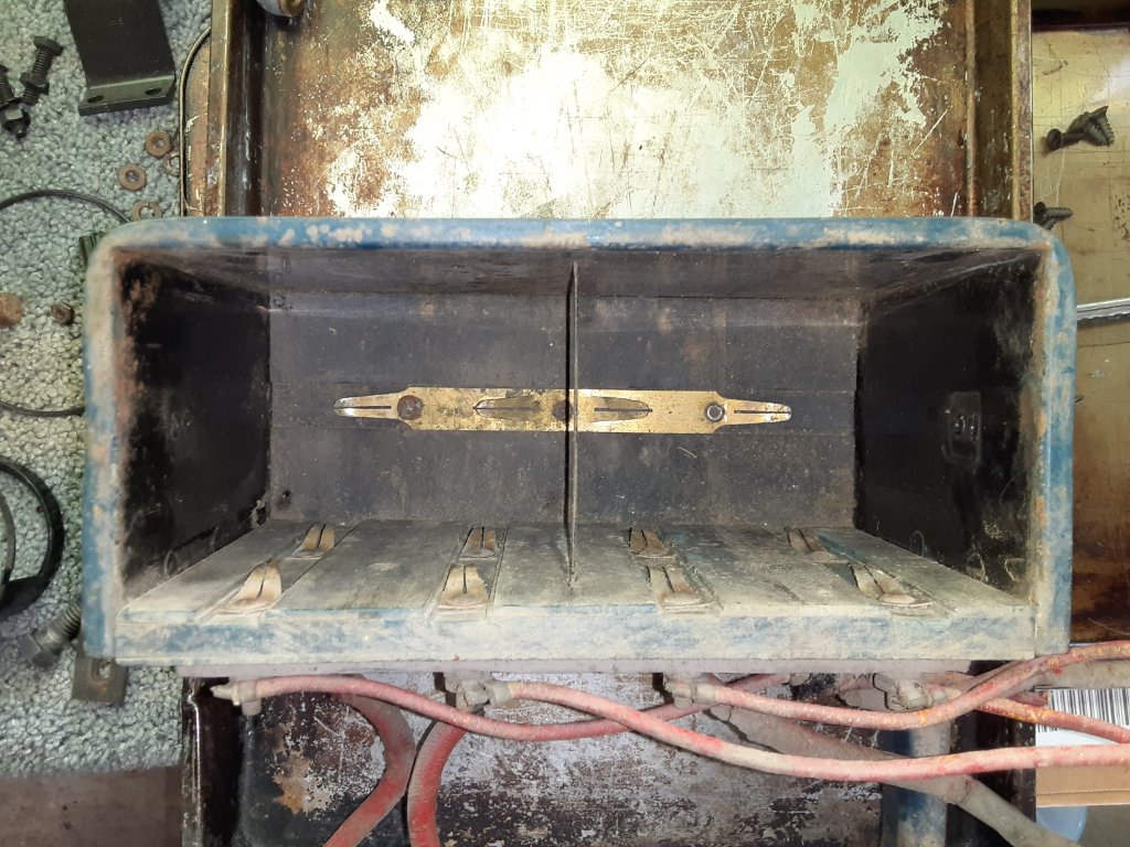

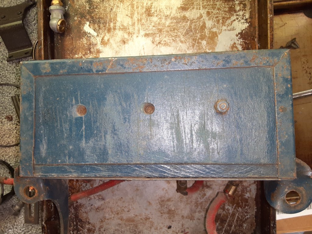

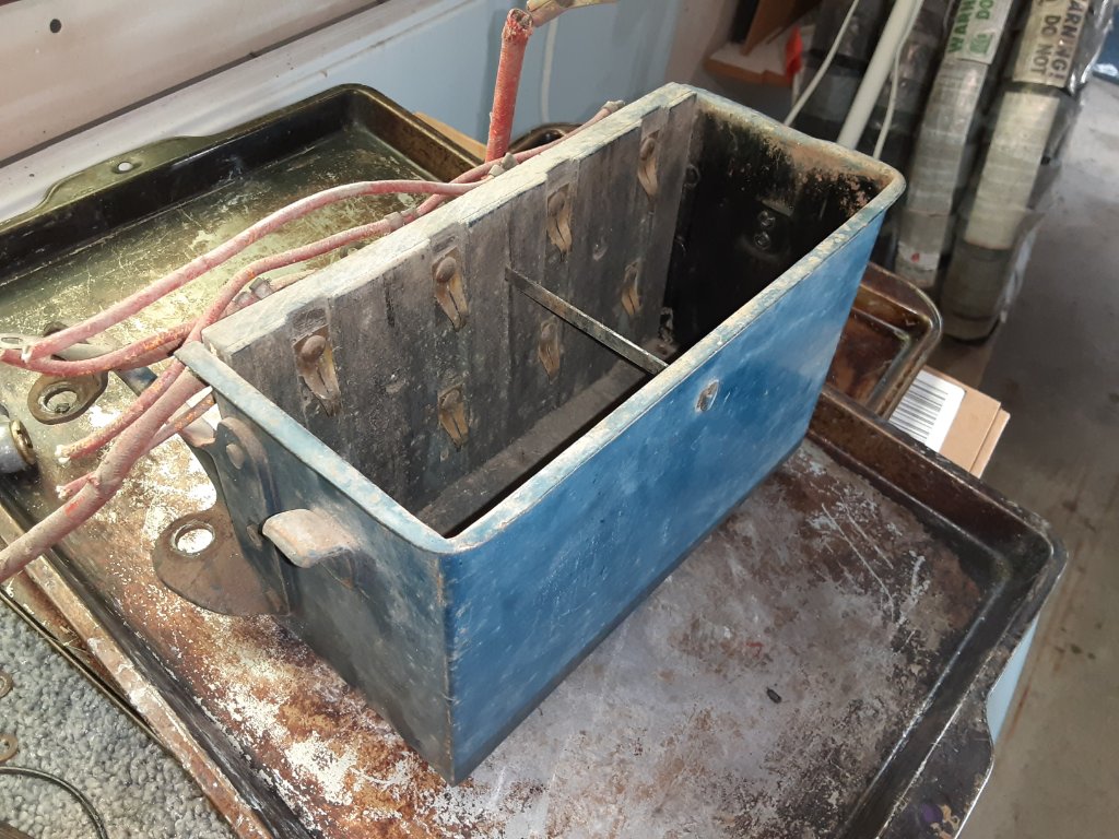

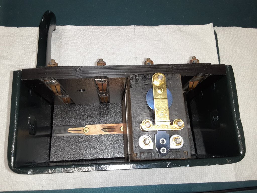

I rebuilt the coil box using the waterproof material and the original contacts, photos attached. I cleaned the contacts using the toilet cleaner, "The Works", per a suggestion by the Coilman. It worked great. He rebuilt my coils. What a great man to work with, very professional and always willing to answer questions and offer helpful advice!! I will coat the coils using linseed oil per his suggestion.
The contacts are soldered. I used the screw rivets that came with the rebuild material to attach the contact strip to the bottom and the vertical contact plate to the box frame. I may replace them with pop rivets.
Four more photos on next reply.

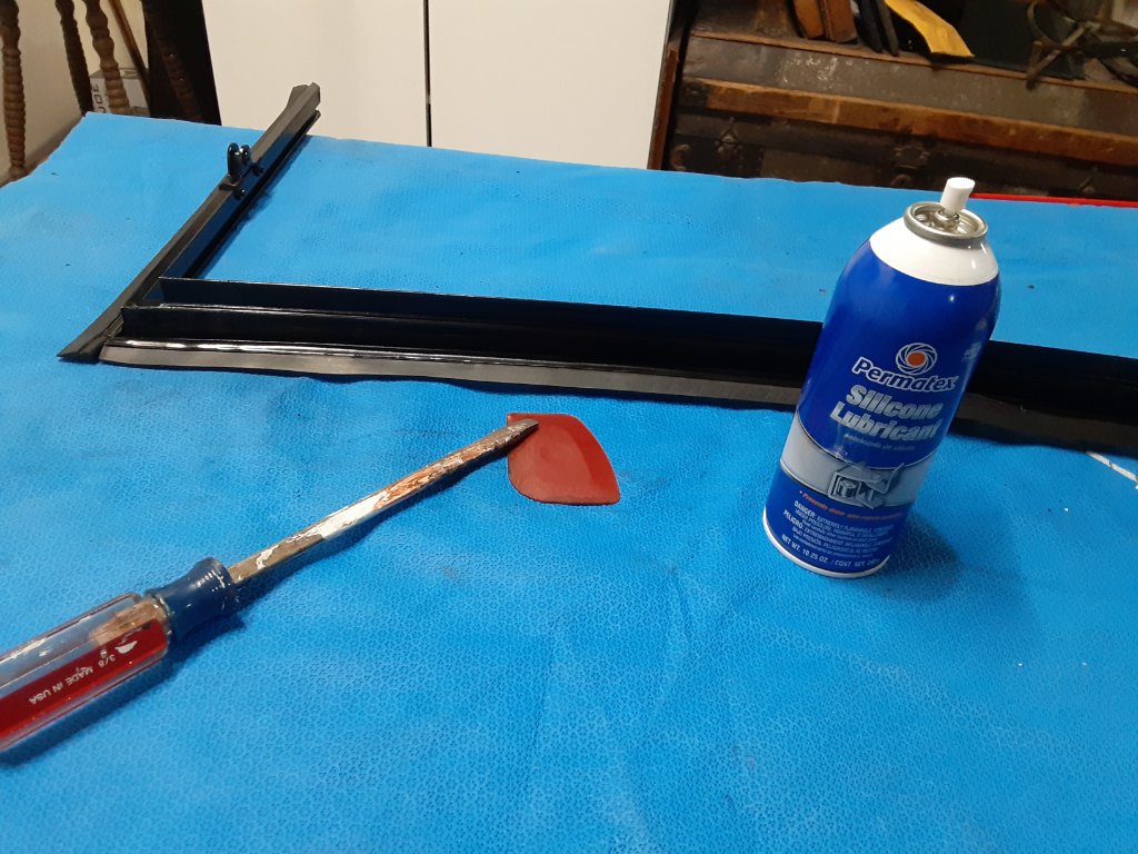

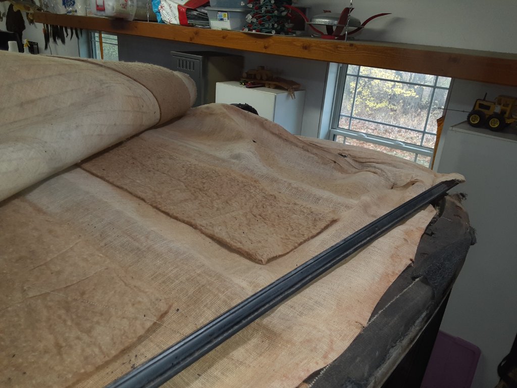

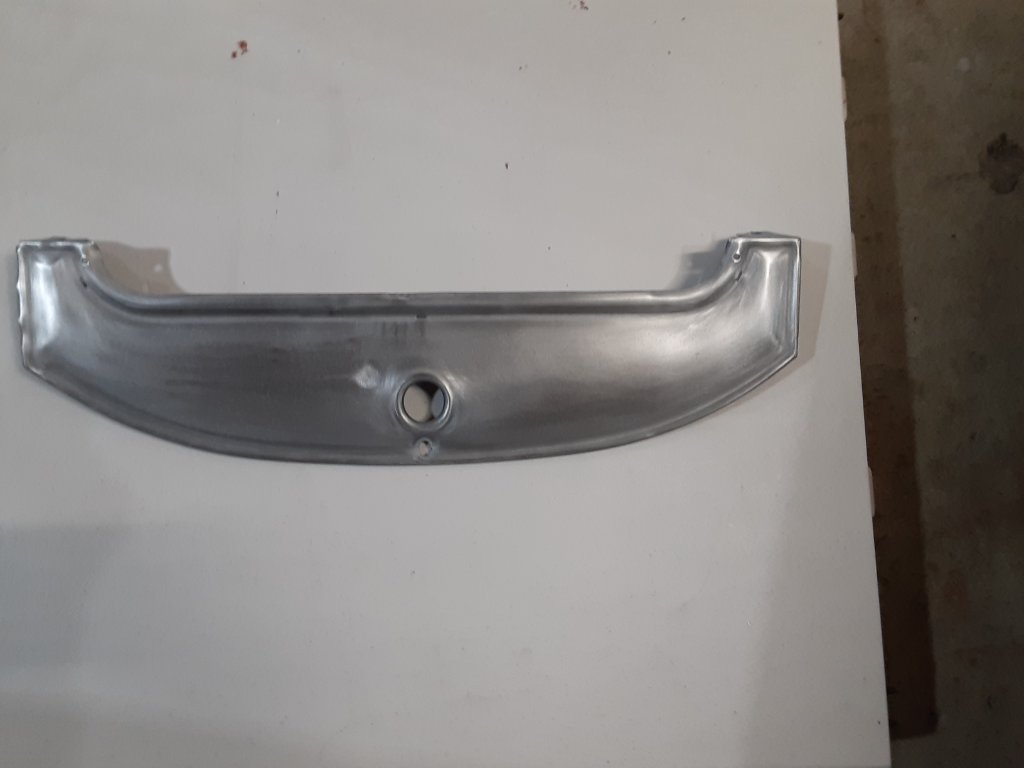

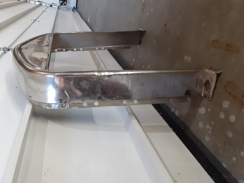

More photos. Screw driver in second photo was used to spread the channel.

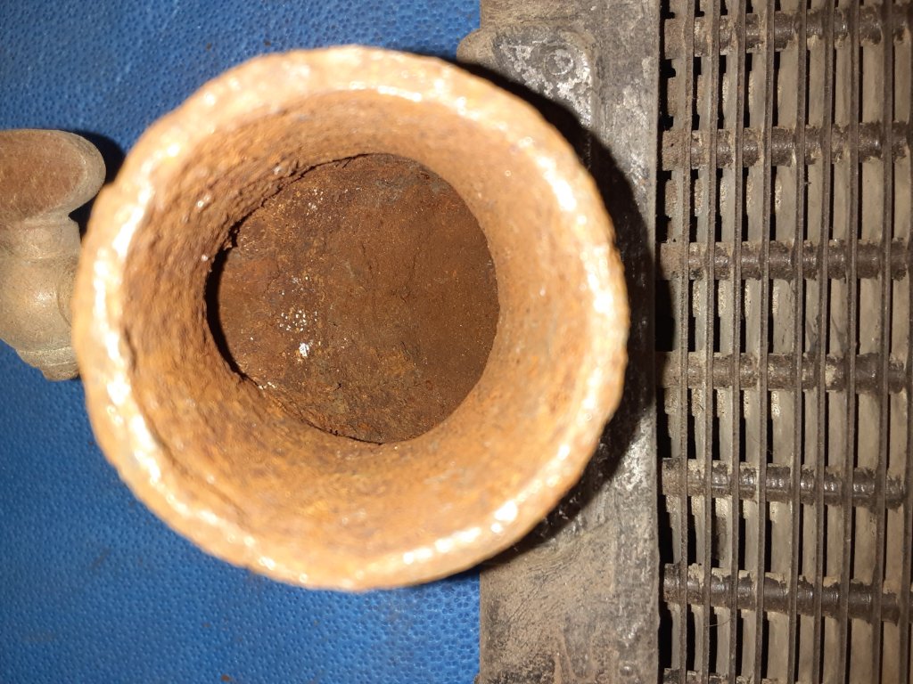

More photos. Two leaks in the round tube radiator.

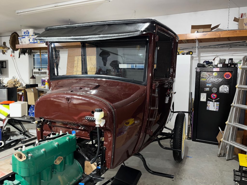

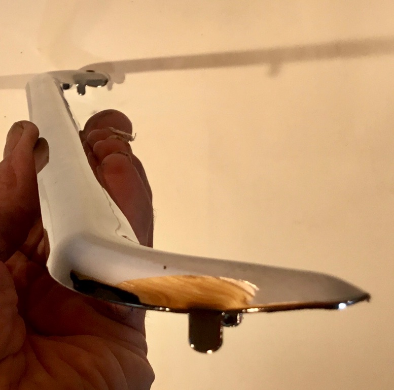

Sanded the handle with 220, 400, 800, and 1000 grit.

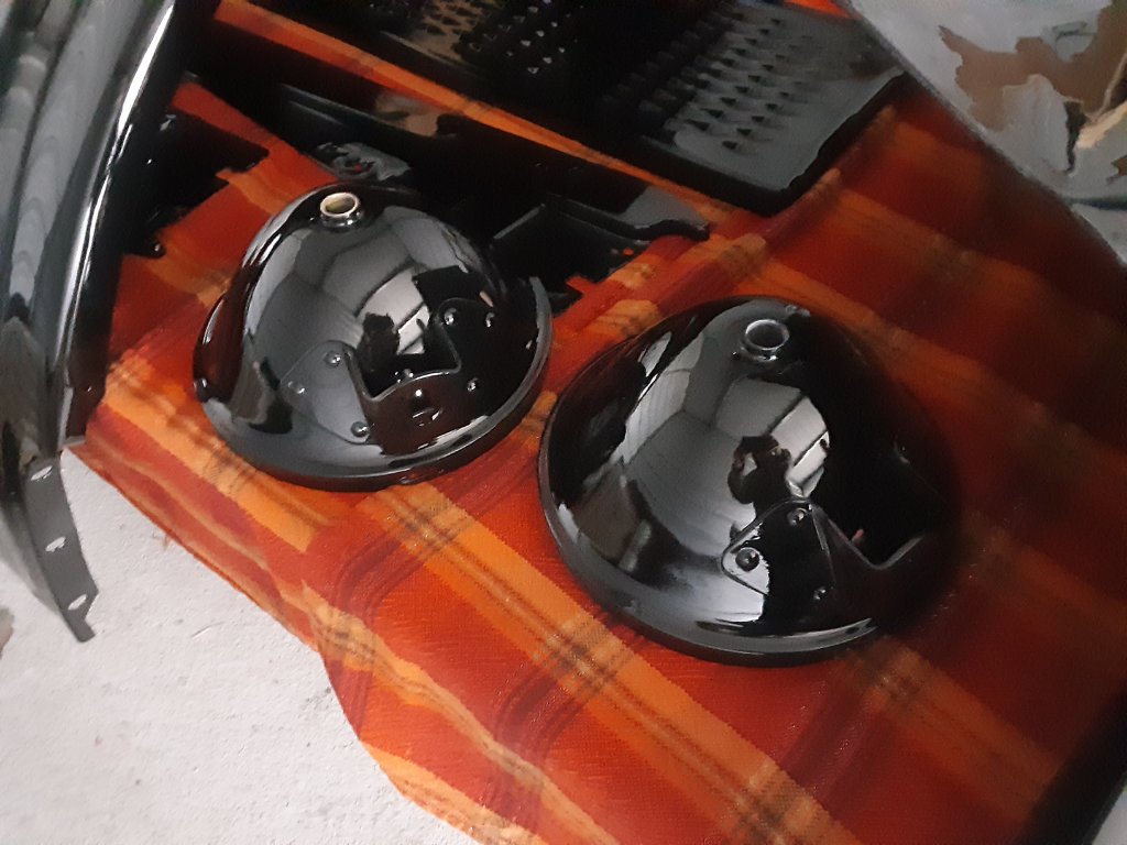

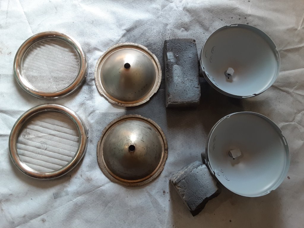

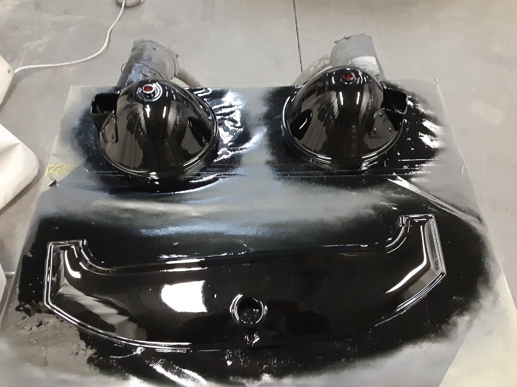

Head lamps and radiator apron restoration. Back side of apron primed.

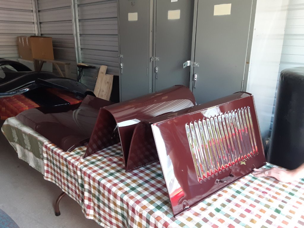

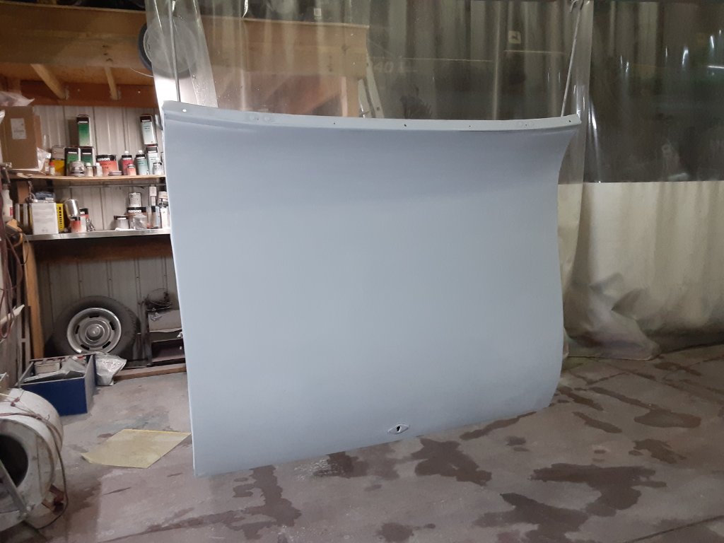

Splash panels painted and restored items in storage shed waiting for body to be painted.
- Posts: 2549
Wow, great job on the paint!

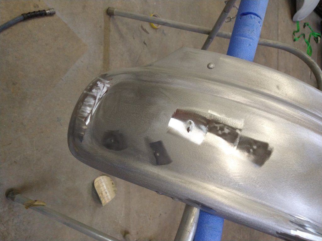

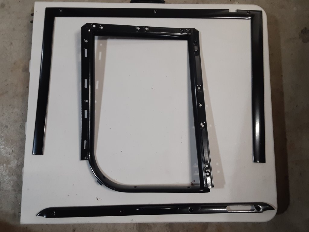

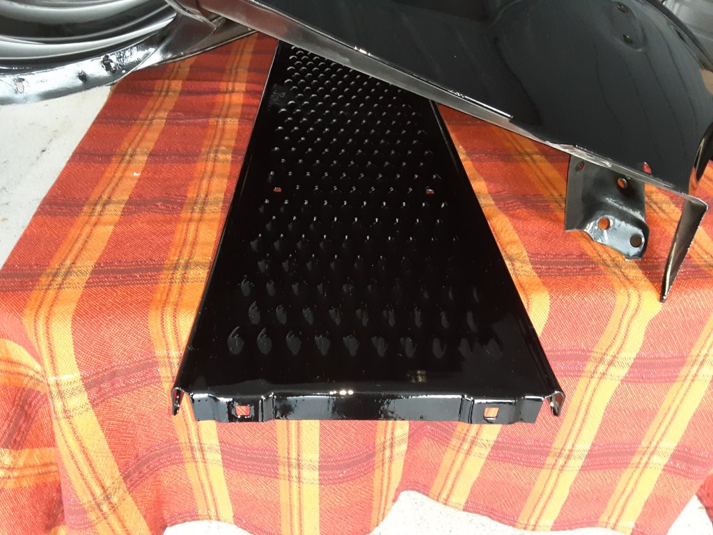

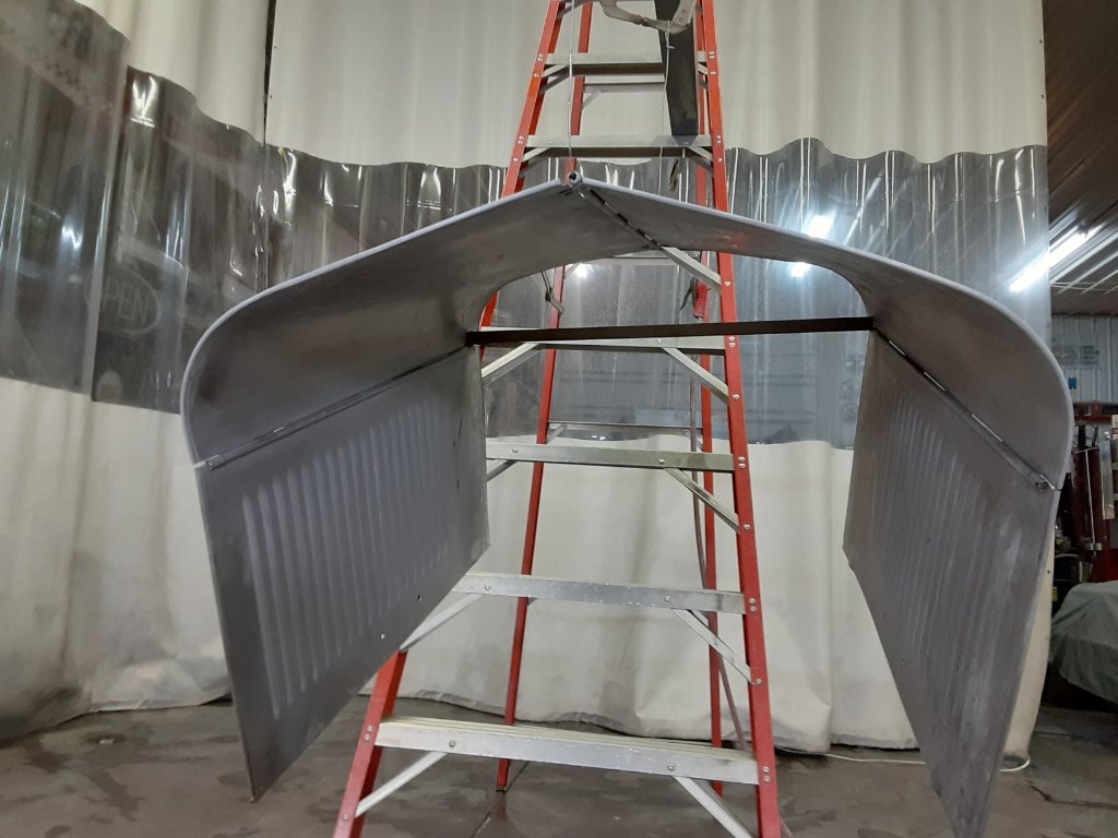

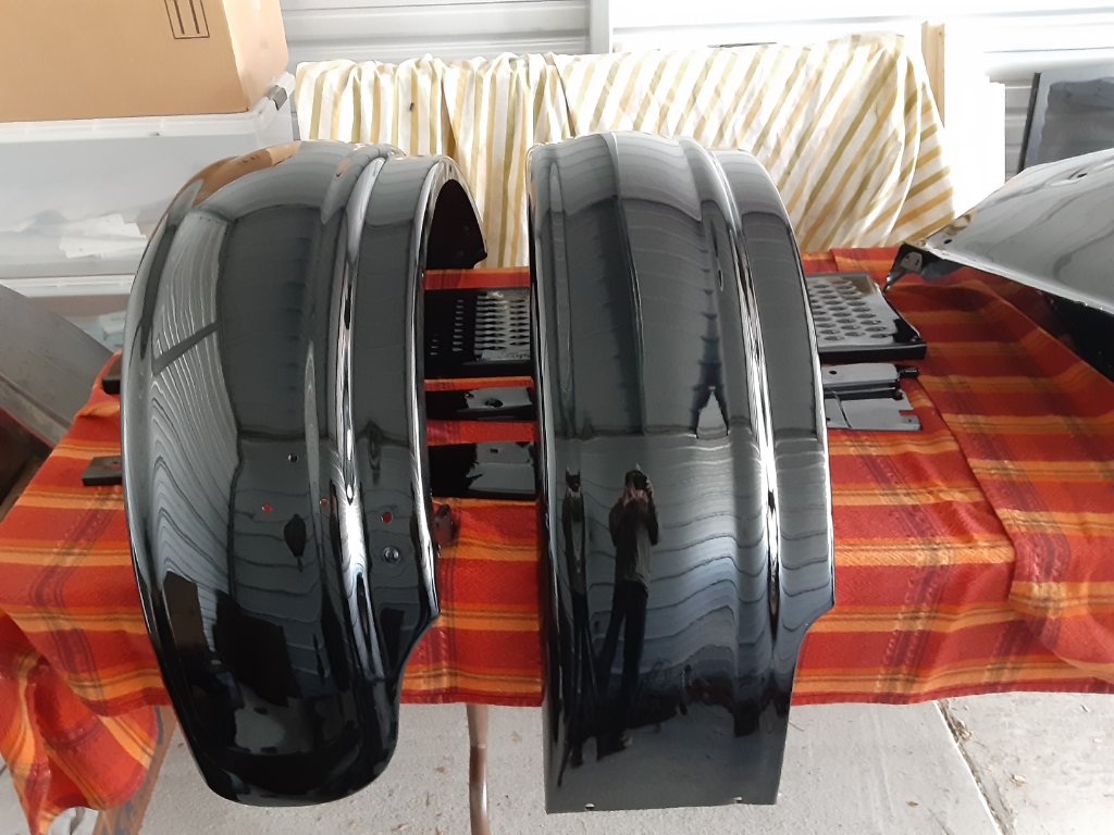

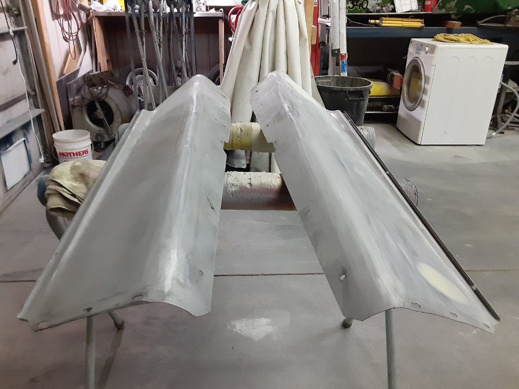

Fender and running board restoration and headlamp rod, apron, and splash panel.

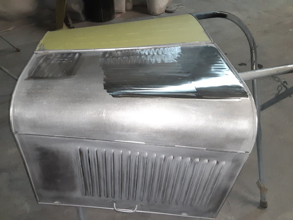

Photos in the paint shop. First one shows the sample of the maroon color for the body.

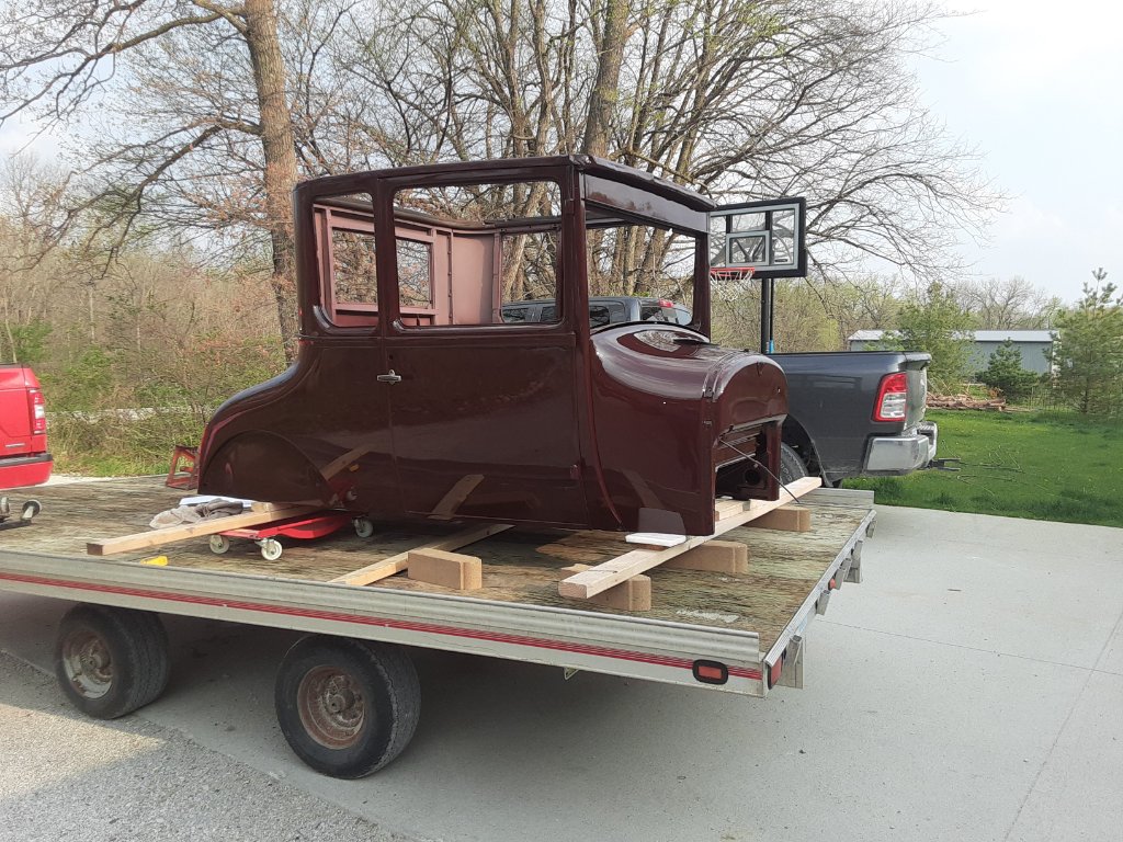

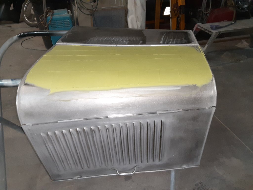

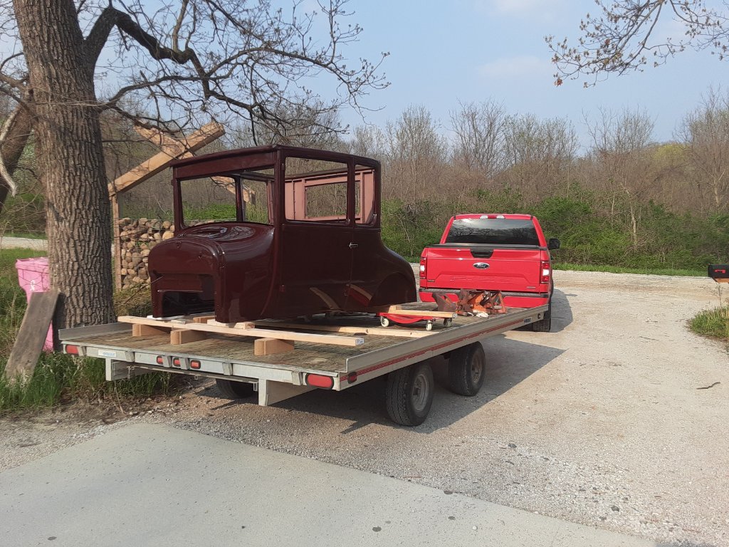

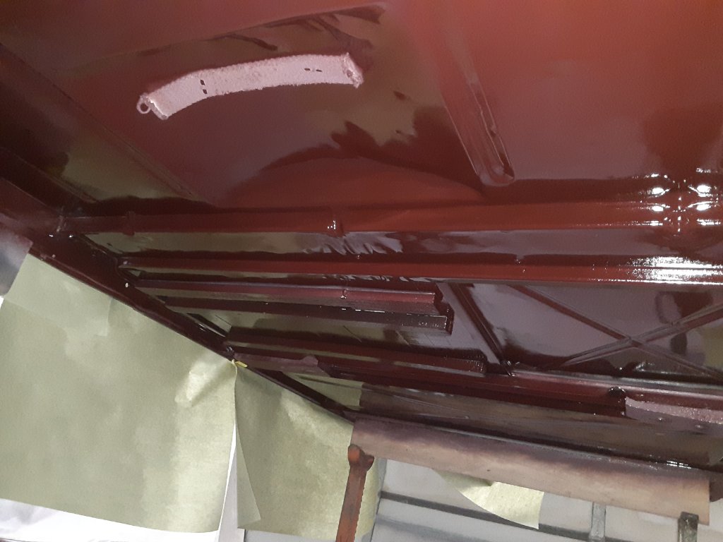

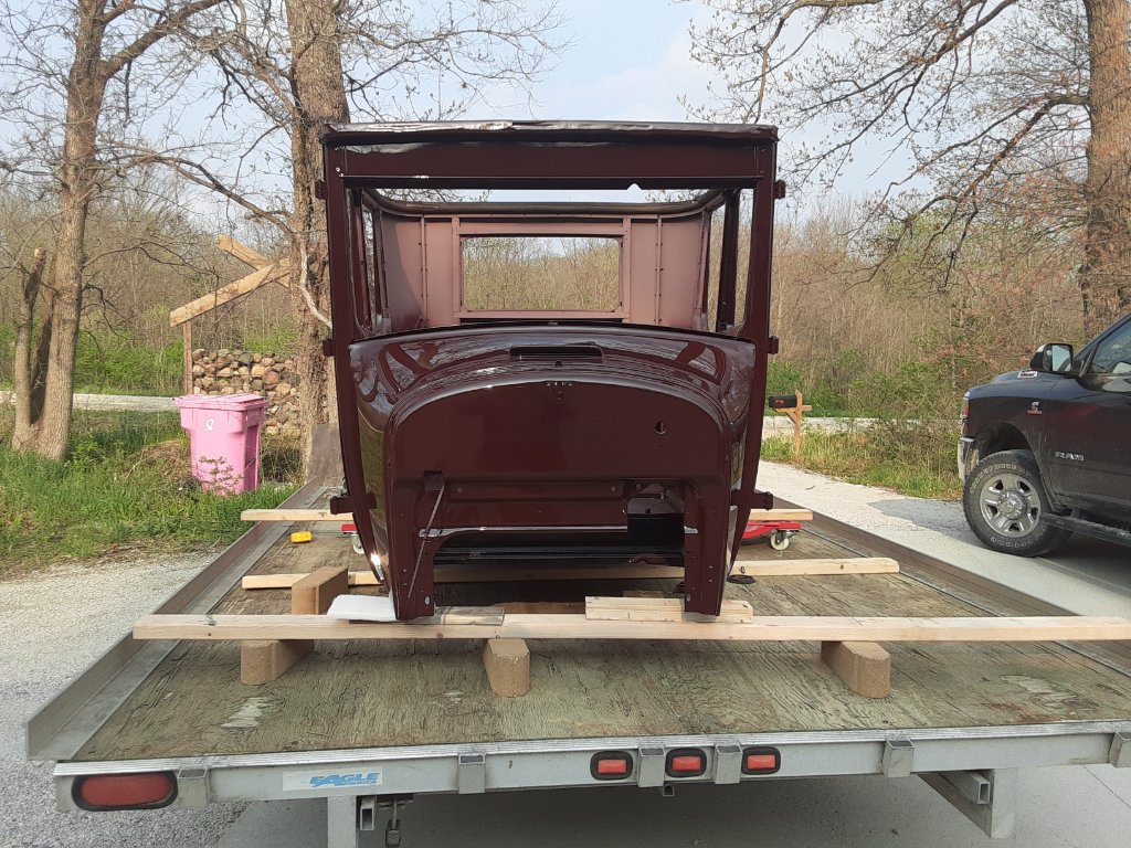

The body is painted. I took Ardith to see it at the paint shop. She liked it! Will bring it to the garage on Monday.

Amazing!!! can you tell us your choice to rebuild the engine ? you can pm if you like. and the radiator also. tx love all of these.

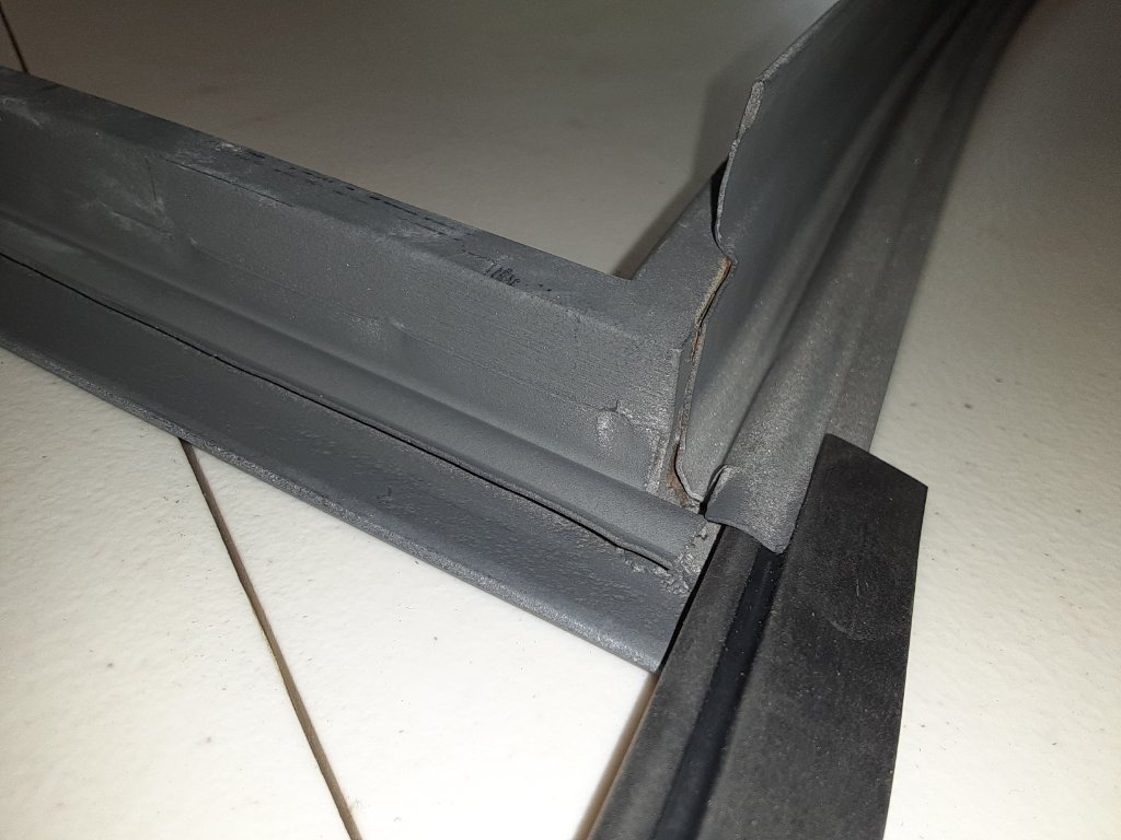

Did you have to replace the door glass channels? I'm trying to figure out how to do it for my '27 Coupe.

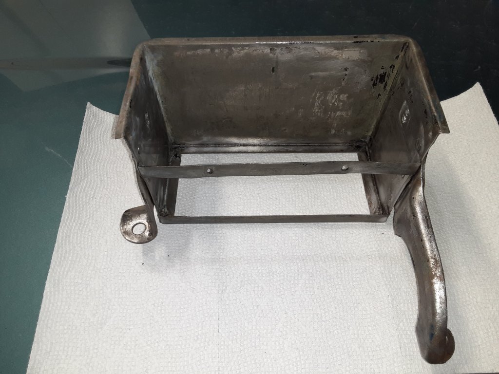

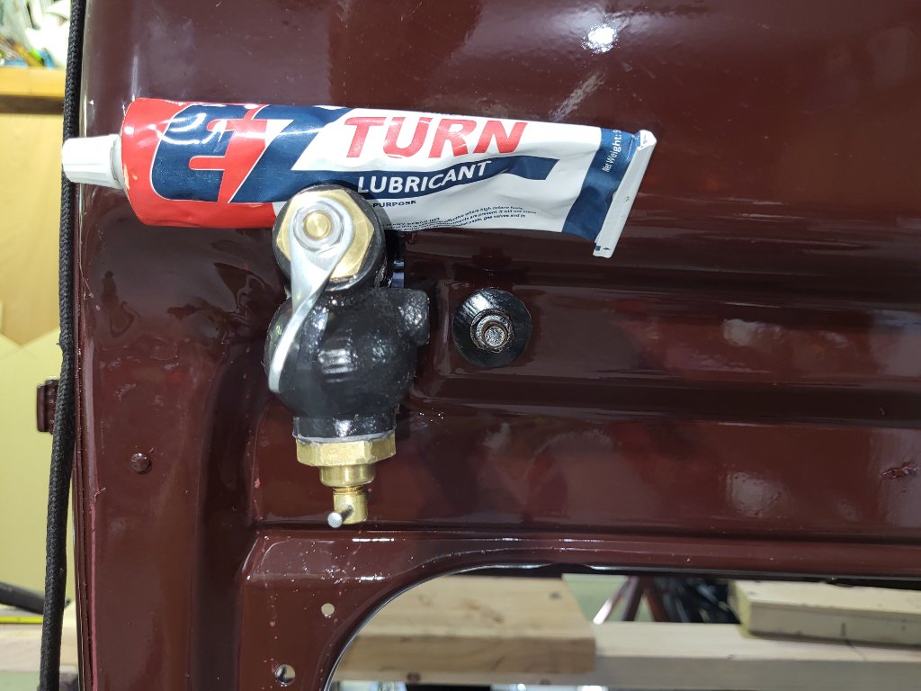

Reinstalled the gas tank. New pad between the tank and cowl, new pads on the straps, new adhesive pads on upper tank supports, and new sediment bulb.

Bruce. How do you plan to remove the dents from your radiator shell? The dent on the front is very deep. It can be done. Have you nickel plated it yet? Jim Patrick
Check out: Www.Paulschrome.com. A place like this specializes in putting out perfect work.

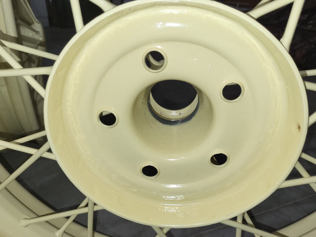

Powder coated the wheels. One small step, but a huge step for the restoration project!

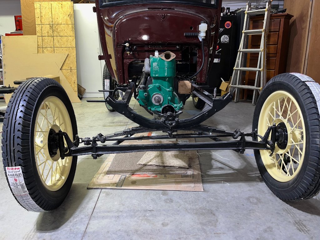

Another small step, mounting tires on four of my wheels.
Looking Good!

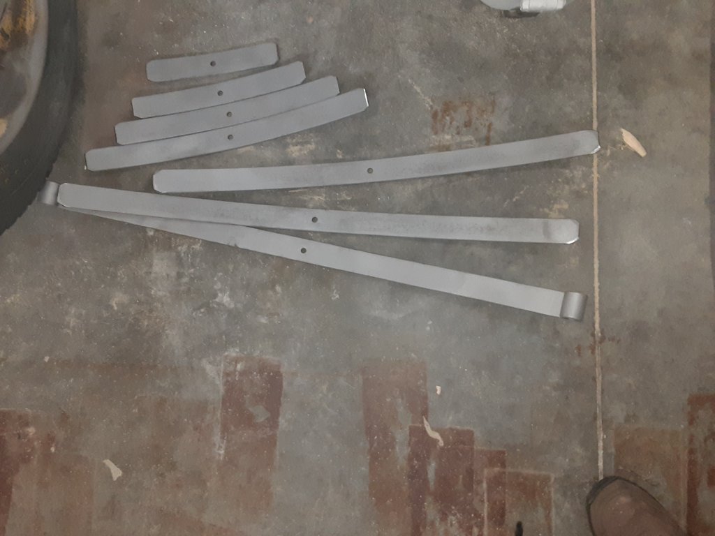

Looks great! Don’t forget to install the spring leaf alignment clamps on your springs to keep the leafs in line. Jim Patrick
- Posts: 7259
For others' information. Modern tyre changing/mounting machines will accommodate 21" wheels . With a bit of tape on the three mounting claws, powder coating can be protected. The fitter can adjust the machine so no other part ever touches the rim. It will roll the tyre around without ever touching the powdercoat. The tube can then be inserted and the outside bead rolled on in the same manner. No masking neded. No damage to the paintwork and best of all no cussing because of damage. Much safer than wrestling with them yourself.

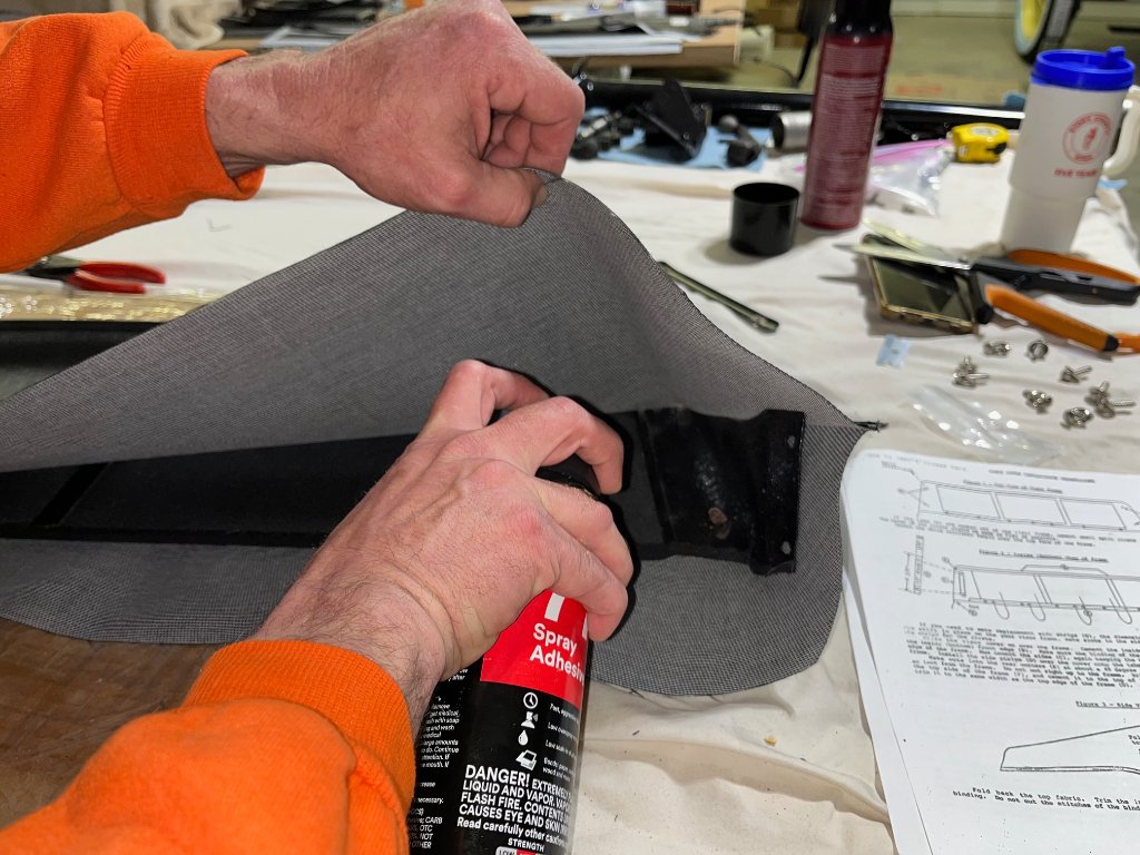

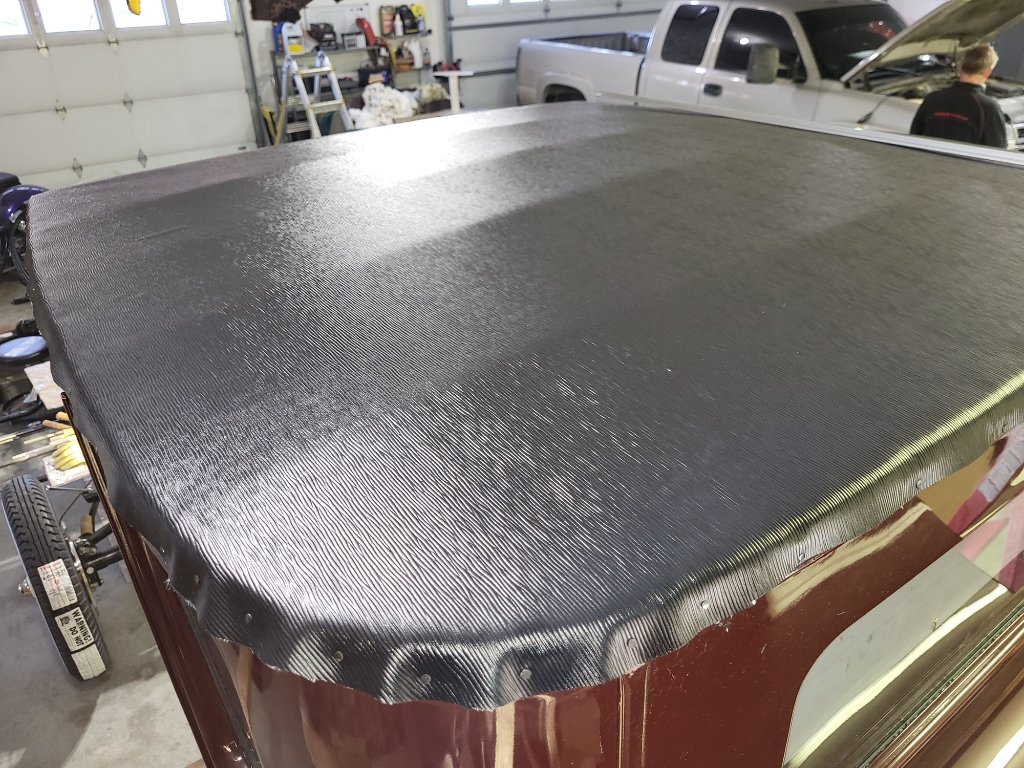

Photos of installation of top and interior material.

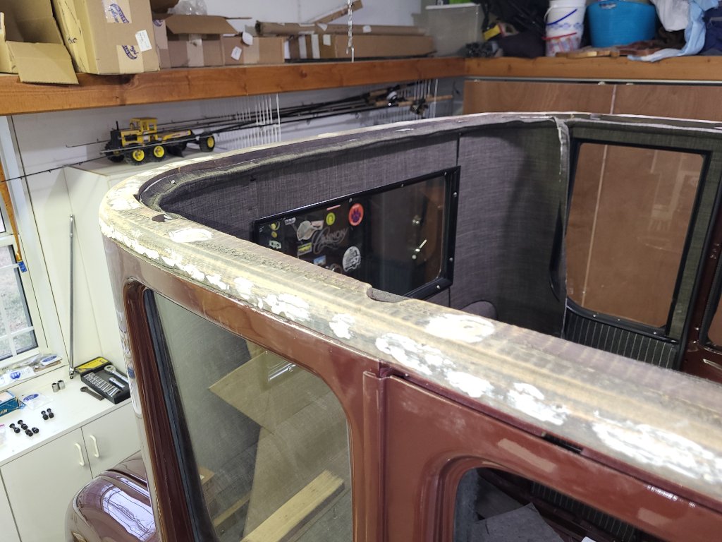

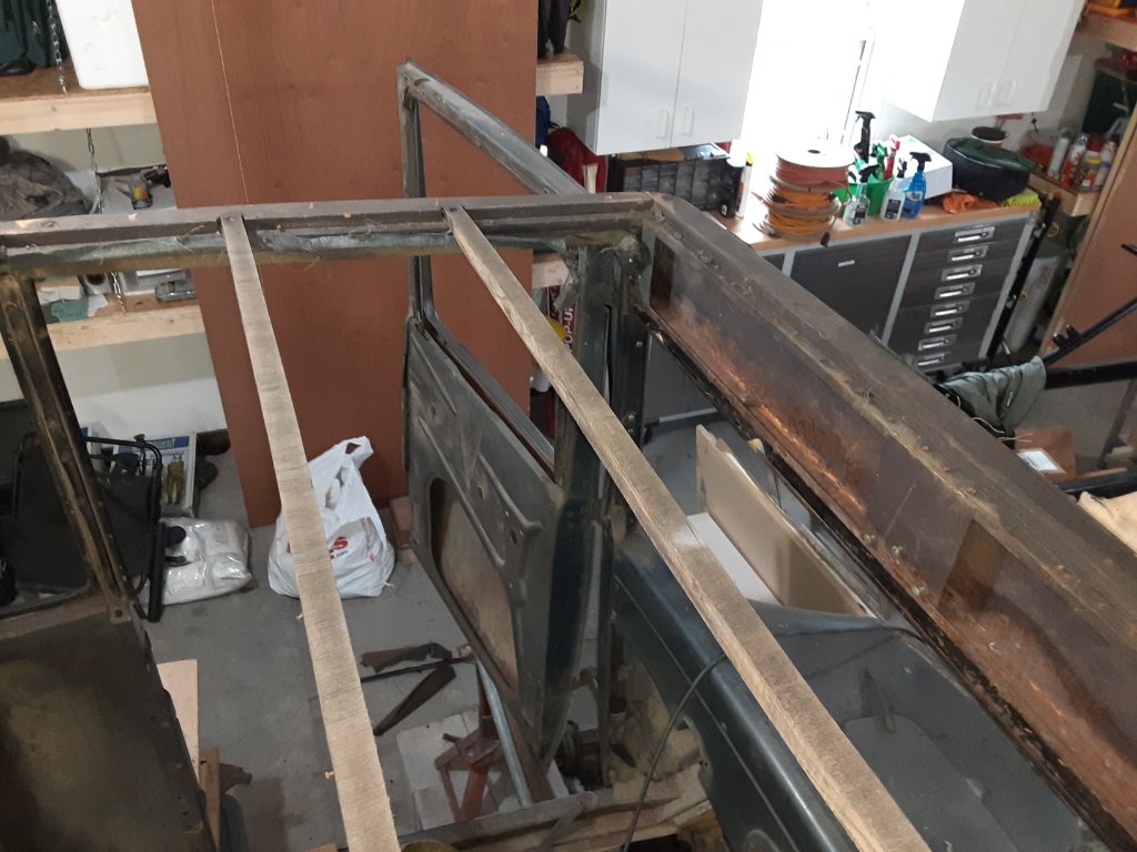

Photos of top installation. First photo is taking the original rain gutter apart. The inside piece was replaced with a piece of tape measure.
BLB27
- First Name: Bruce
- Last Name: Brakke

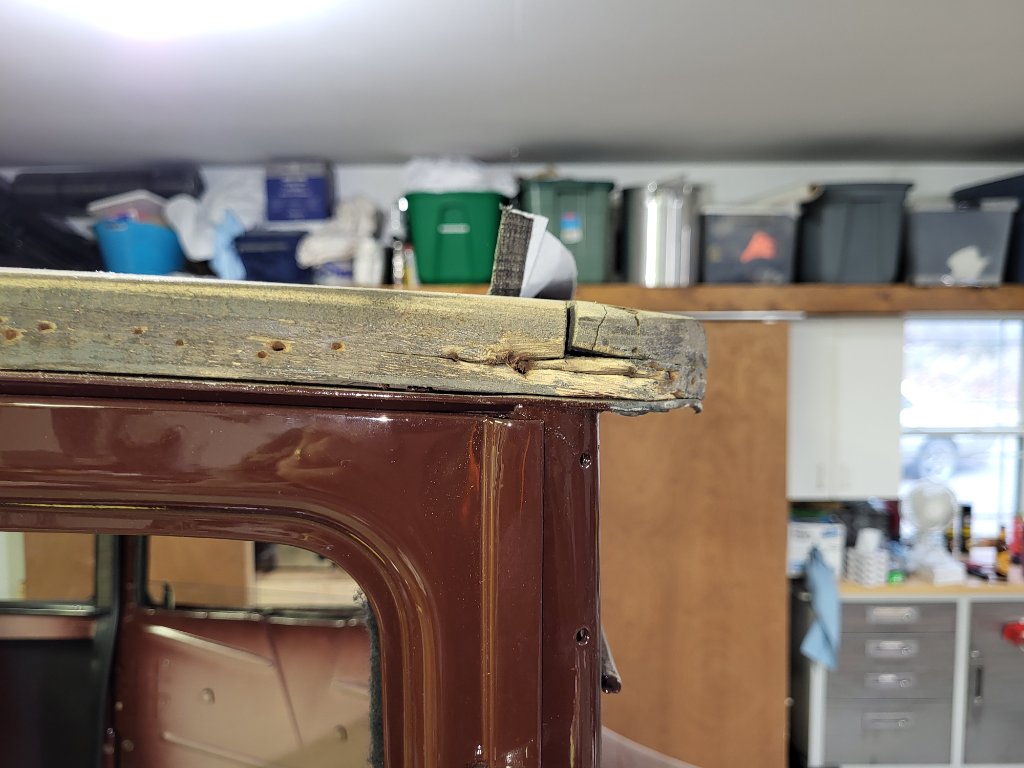

Repair of top wood. The last photo is the corner after soaking it with the "Wood Harder".
BLB27
- First Name: Bruce
- Last Name: Brakke
Repair of top wood frame with "wood harder" and "wood filler".

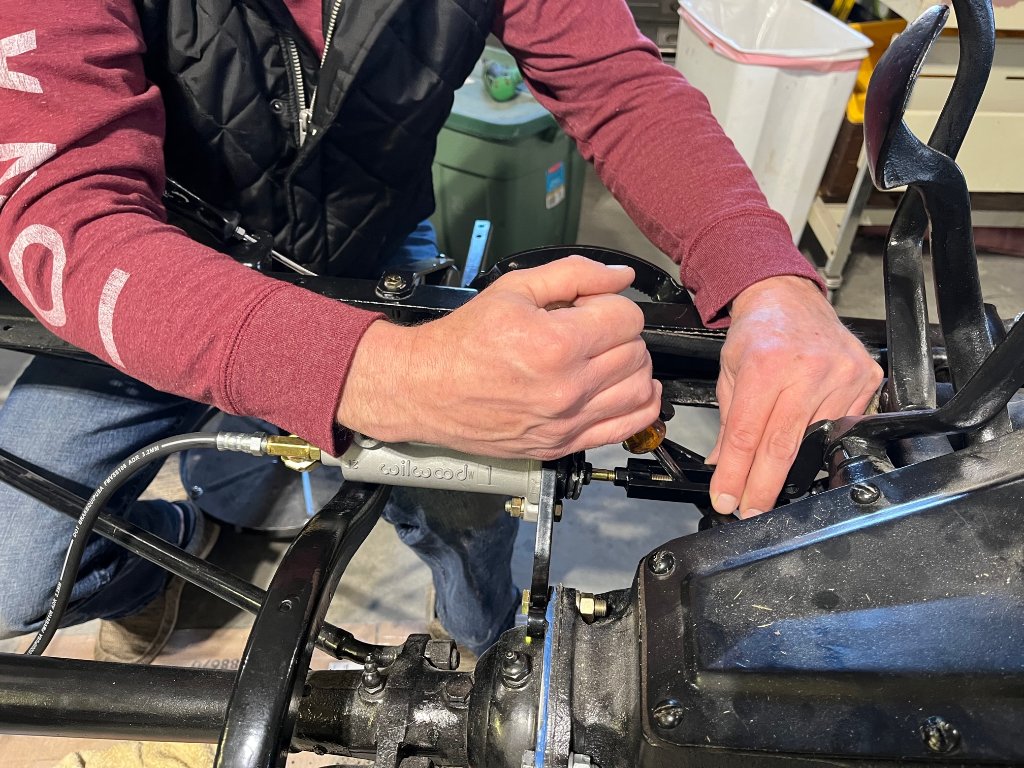

Bleeding the "SURE-STOP' disc brakes by Birdhaven. The first three photos are of bench bleeding the master cylinder and the fourth is bleeding the calipers.

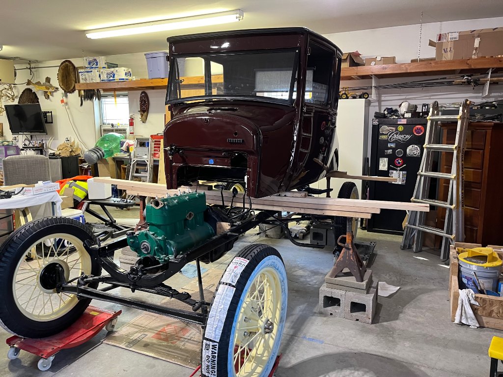

Starting to put the splash pans, running boards and fenders back on the coupe.
