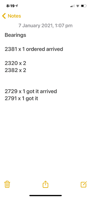

This worked for me but some you will need to find a metric equivalent

Thank You Dan and Tracer, I will cross those numbers to metric. Tim, I sent you an email about the transmission strap.---Dan
