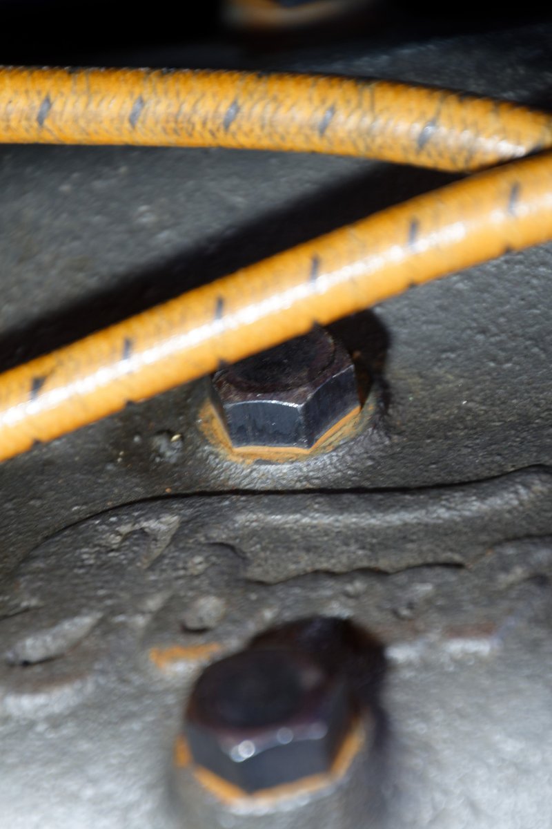

Can anyone tell me what's going on with my engine? Thers is new rust around several of the new head bolts. I saw water bubbling up in the sparkplug wells on 3 & 4. Is my head cracked?

I would suspect a leaking head gasket.

Are you seeing water or just compression blow by in the spark plug holes?

Water from rain/car washing will drain into the wells around the spark plugs. That moisture will also create rust where the headbolts have removed paint as they are tensioned. As indicated, compression blowby at the plugs is common, usually bubbling in oil, but just as usual if there is water in the plug wells.
There may be absolutely nothing wrong/worth fixing.

Jeff, i would think that if you don't actually see water seeping up from the head bolts, you're probably fine. Judging from your pic it seems like tightening the head bolts just scraped off what finish you had on the head, and the little wells surrounding the bolts just accumulated water, allowing it to rust. Like Mark mentioned, its pretty common on T's to get some blow by at the spark plugs and some here have added products to the plug to keep it from leaking. Good luck.

Your photo does not suggest any real problem. As someone else stated, car washes can easily do what you describe. Just keep an eye on things.

I just replaced the head gasket (w/copper spray) and double checked the ft lbs. (55) after a few heat-cool cycles.
I noticed the water !after! I washed the car. duh.
I'm gonna test drive it and I'll see how the power feels.
