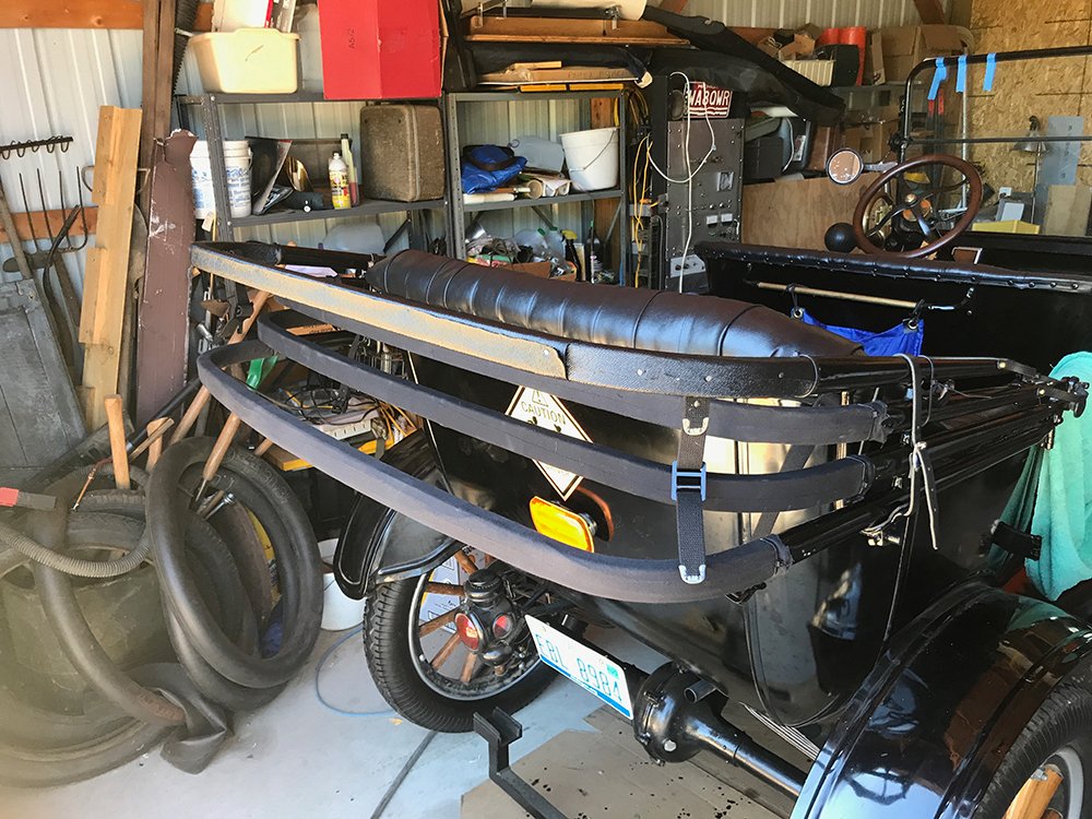

Here's a link on wrapping the front bow which on many T's is wrapped in vinyl <https://mtfca.com/phpBB3/viewtopic.php?f=2&t=14323> On my 1917 the wood bows make a 90 degree curve before joining the steel sockets. I carried the wrap to just below the top of the sockets.

My wife sewed the cloth material (cut on the bias) into a long tube and then pulled it inside-out so the cut edge was to the inside. I then pulled it onto the bow, sprayed it with warm water and pulled it taut, securing the ends temporarily with tie wraps. Finishing with a hair dryer while it was still damp, it snugged up wrinkle free.
For the vinyl, I did it in three sections. The two curved ends and the straight center (see previous post). I used contact cement and tacks (sparingly) to attach it.
Once the bows are finished you have the top to install. A whole other story
Do a forum or google search and you'll find lots of information.
