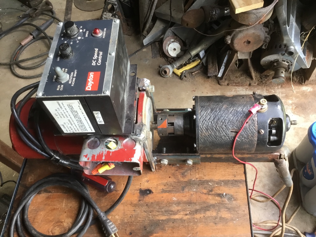

Bob, just looking at your test set up, wouldn't the generator voltage just run wild with out having a cutout or regulator on it?
BobShirleyAtlantaTx
Topic author - Posts: 361
- Joined: Mon Jan 07, 2019 12:44 am
- First Name: Bob
- Last Name: Shirley
- Location: Atlanta Tx
Re: Generator RPM
I’ll be darned if I know, I hook up an analog amp meter and set the third brush to 6-8 amps with the generator turning about 1500 rpms But, I’ll be the first to say, I know just enough to be highly dangerous when it comes to such.

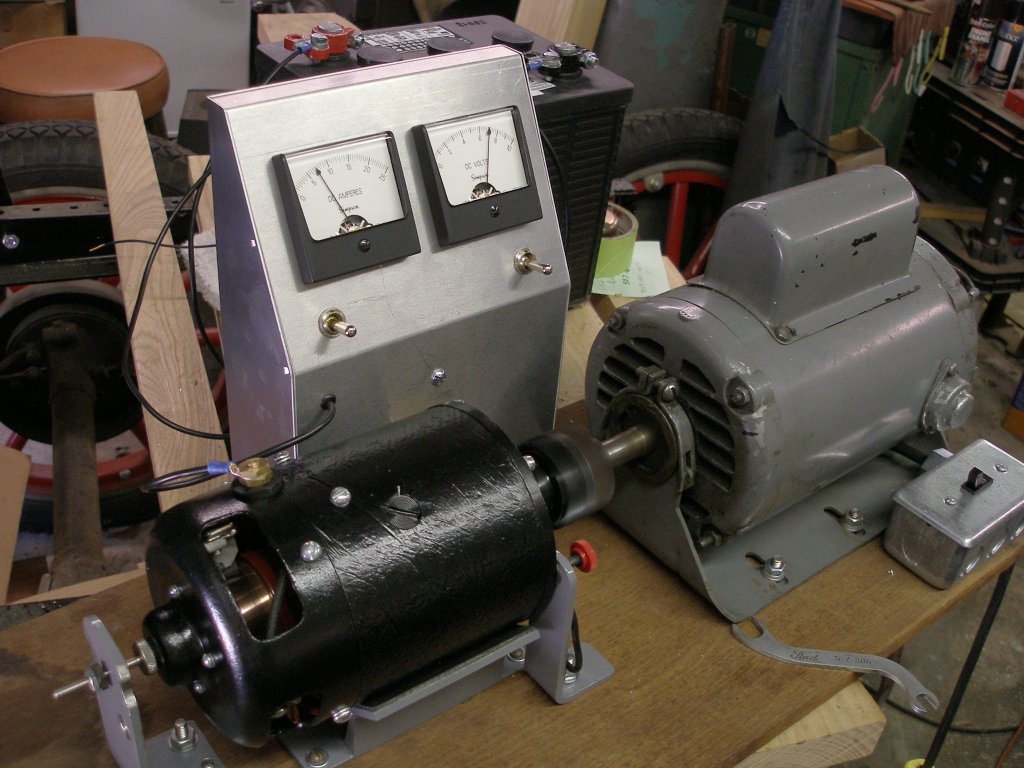

- Posts: 6732
Re: Generator RPM
You'd be better served by running your test at typical motor speed of 1725 RPM and then running the amperage down to around 4A. That's plenty.
easier on the generator and easier on the battery...

- Posts: 6732
Re: Generator RPM
Something that I'll add relative to the cut-out discussions:
1. if you are building a test set, it really does need a cut-out in the circuit
2. the set needs a way to electrically close the cut-out independent of the generator running, so that you can "motor" the generator and measure the amperage draw while doing so...too high of a current and the generator has a mechanical bind or electrical fault which will need to be rectified before adjusting for operation in the car.

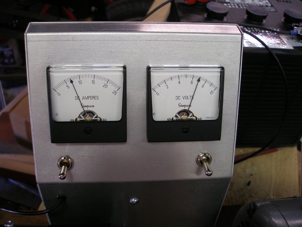

Re: Generator RPM
Scott
The ammeter shows 7 Amp in your picture showing the current draw of the generator.
1. Do you allow the generator to turn during this test or is the generator not allowed to turn.
2. What would the max allowable current be.
3. It seems like a simple switch would work to turn off and on.
- Posts: 6732
Re: Generator RPM
Art, the picture was taken years ago with the generator under power, so it is misleading relative to my commentary...sorry about that. It is showing 7A output and 7V output to the battery as you can see.
as for testing the motoring current, to your questions:
1. I allow the generator to turn with no drag when measuring "motoring" current
2. I cannot recall, but will check this AM. It's been a long time since I was rebuilding generators...mostly am doing carbs now
3. you're right...the switch on the lower right in the utility box turns the 1725 motor on/off
for testing motoring current (checks for mechanical binding or electrical faults in the generator), the two switches on the panel are momentary "ON" (normally OFF). Because the meter I purchased is not a +/- meter, the switch under it reverses the leads to the meter and it is pushed and held UP. Then the other switch is pushed UP and that electrically closes the cut-out to allow the battery to back-feed to the generator. The resulting voltage shown is the draw-down on the battery, and the current measured is the current draw from the battery. It works very well and since they are sprung to be in a normal test position unless manually held, there is no way to accidentally screw up the normal output testing of the generator which is what most people would want anyway. The motoring current is just a nice way to see how well the brushes are seated and how freely the armature turns in the case with properly adjusted bearings, etc.
Now, I'll throw some opinion out: there is a point where the generator builds up and will overcome the cut-out and put a charge to the battery...there is also a point (RPM) at which the generator is not going to continue to build up. Where is that point? At what RPM? Well, depending on the condition of your generator, the condition of your battery, the condition of your wiring (do you have the wrong gauge wire going to the battery?? Many do!) the amount of charge regulated by the third brush, every combination of variables will determine "when" the generator has built it's greatest output. Do you want to guess at what RPM that threshold is for your particular set up? Not me, that's for sure. That is why I test everything at 1725 RPM at the armature. That is a convenient motor to hook up and is pretty much the generator speed that an un-modified T is going to run at on a level paved road at a mildly elevated speed. In my mind, there is no reason to set a generator for puttering speed and then unexpectedly have to get on an open road and 'let 'er rip' and have more output or stress on the device than was tested for. I test for maximum stress/speed and end up with a very reliable and functional unit.

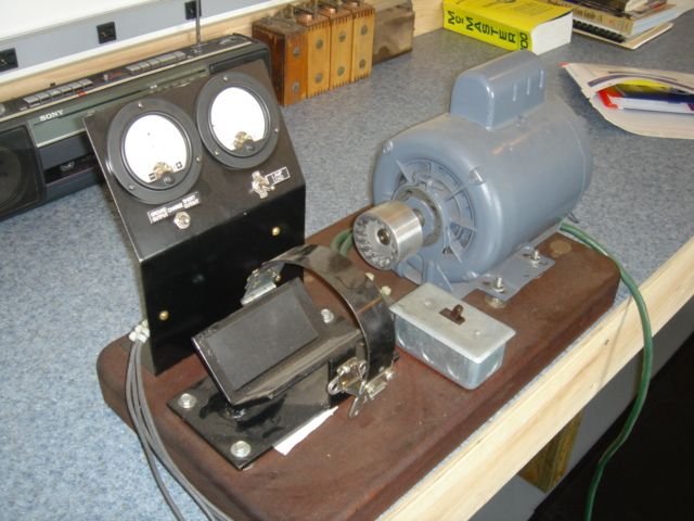

Re: Generator RPM
Scott, Very nice generator test stand. I wish I had one like that, then I could work on developing a voltage regulator replacement for the one that is no longer available. Have the circuit and simulation done but no substitute for bench testing.

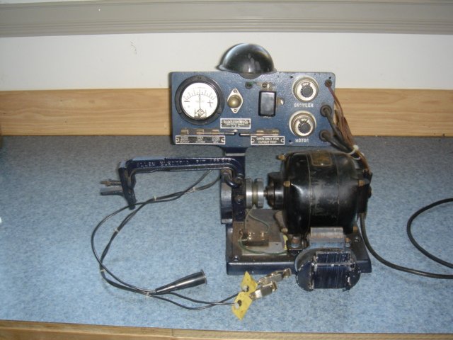

Ron Patterson
Re: Generator RPM
Scott
The Model T Ford generator is a "third brush regulation type, but you already knew that.
It was the most inexpensive type generator available at the time and probably why Ford (actually Fred Allison in the Ford electrical engineering department who developed the FA Starting and Lighting System) they specified it. After buildup to 7.2 volts which is the desired cutout cut in voltage. It is a constant current source over a range centered on about 1725 RPM (about 27 MPH) based upon rear axle ration, the "null" point and third brush setting. It has no dynamic current regulation based upon the batteriers actual need for charge. The current output will decrease as speed significantly increases because the interacting relationship between the armature and field windings has a limit. To say this another way the output will decrease at extreme RPMs far beyond usual engine speeds. I have a better explanation of this attribute if you email me.
Here is a photo of my two generator testers now owned by Don Lang and steve Tomasso.
