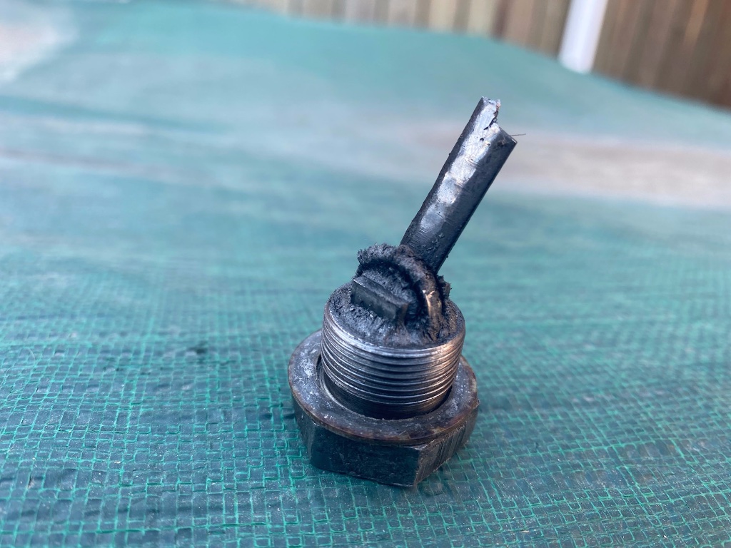

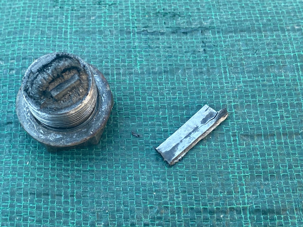

Did an oil change on the '26 Touring this afternoon and found this unidentified but obviously ferrous object sticking up from the magnetic plug.

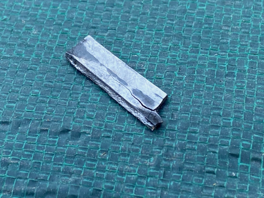

Both sides look partially peened. One end and one side appear square and smooth, other end and side have been broken away from something bigger. Thickness about 0.050".
Thoughts? (Hopefully no prayers needed!)

Ring gear tooth? Ouch!

If the transmission was rebuilt and new shoes added a while ago, there were some bad ones made. The grain of the steel went the wrong way or wrong temper steel was used, and they were prone to breaking along the fold lines.

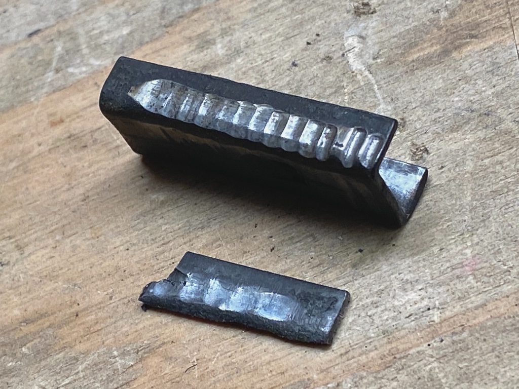

I don't recall reading his transmission was rebuilt using our brake drum clutch shoes which are made to the original Ford print including material and heat treat. We have literally sold thousands of these shoes and have yet to receive a complaint of this nature from a customer.speedytinc wrote: ↑Fri Oct 22, 2021 8:40 amThem little cutting tools can work their way between the drum & band lining, not to mention your field coil. Been there.
Bit by another batch of bad repop parts.
Furthermore, it is not uncommon for the original shoes to fail over time due to excessive wear caused by the clutch disks. Case in point, the photo of the intact shoe shown next to the fragment.

I went thru the invoices from when this transmission was worked on in 2012… bushings, washers, pins, bands etc. but no drum lug shoes. Safe to assume I reused what was in there at the time, most likely since day one.
In hindsight, there were smarter ways to save $15. I was probably lucky to get nine good years and many thousands of miles out of them.

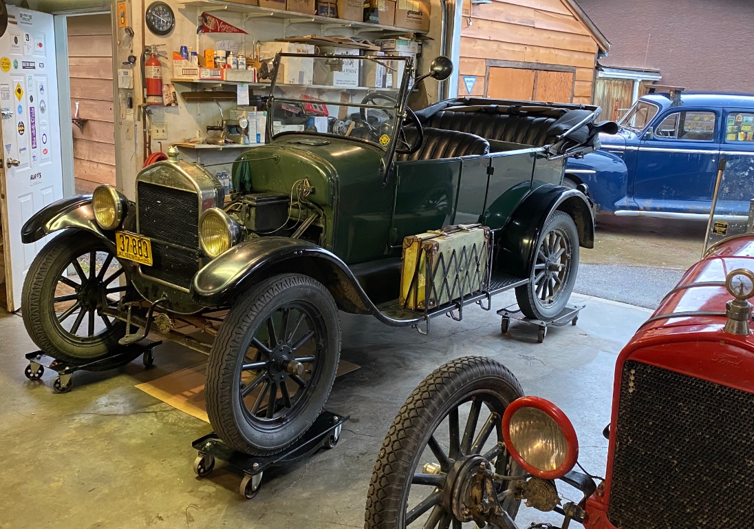

The Touring is up on dollies and patiently waiting the return of my loaned-out hoist and engine stand…
