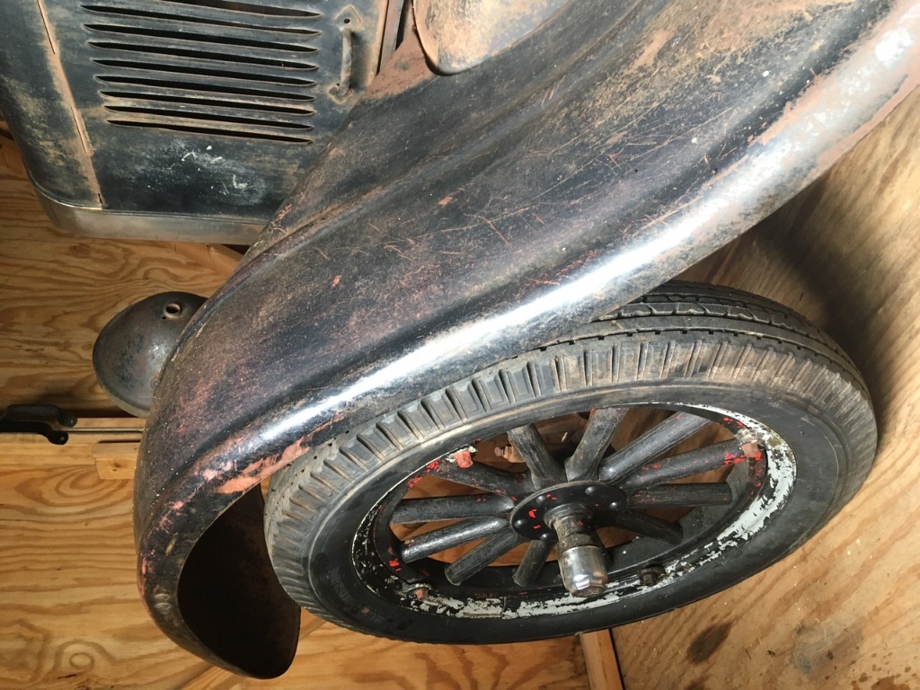

Hey still learning here. Trying to figure out the different rim styles/names. I have a 26 Tudor and am wondering what type of rims or the name of the rims I have.
- Posts: 4694
Re: Rim terminology
Those were split rims. They were standard for that year. They also came with wire spoke wheels which cost a bit more.

Re: Rim terminology
I here the term clincher rim often and didn’t know the difference. Also should the split rims have a locking tab on them? And Iam assuming these split rims are considered de mountables ? Basically when I go for new ones I will know what to ask for
- Posts: 2061
- First Name: Jeff
- Last Name: Humble
- Location: Charlevoix, Mi
- Board Member Since: 2006
Re: Rim terminology
Bryant, yes you have demountable split rims. There should be a locking tab, you will not see it with the rim on the wheel.

Re: Rim terminology
Clincher Rims are designed to fit Beaded Edged Tyres as in Steve's explanation. The Beaded edge and its equivalent rim was designed to hold the tyre securely in place. Very early tyre designs tended to allow the rim to turn inside the tyre and this stopped that happening, provided the tyre was inflated correctly.
