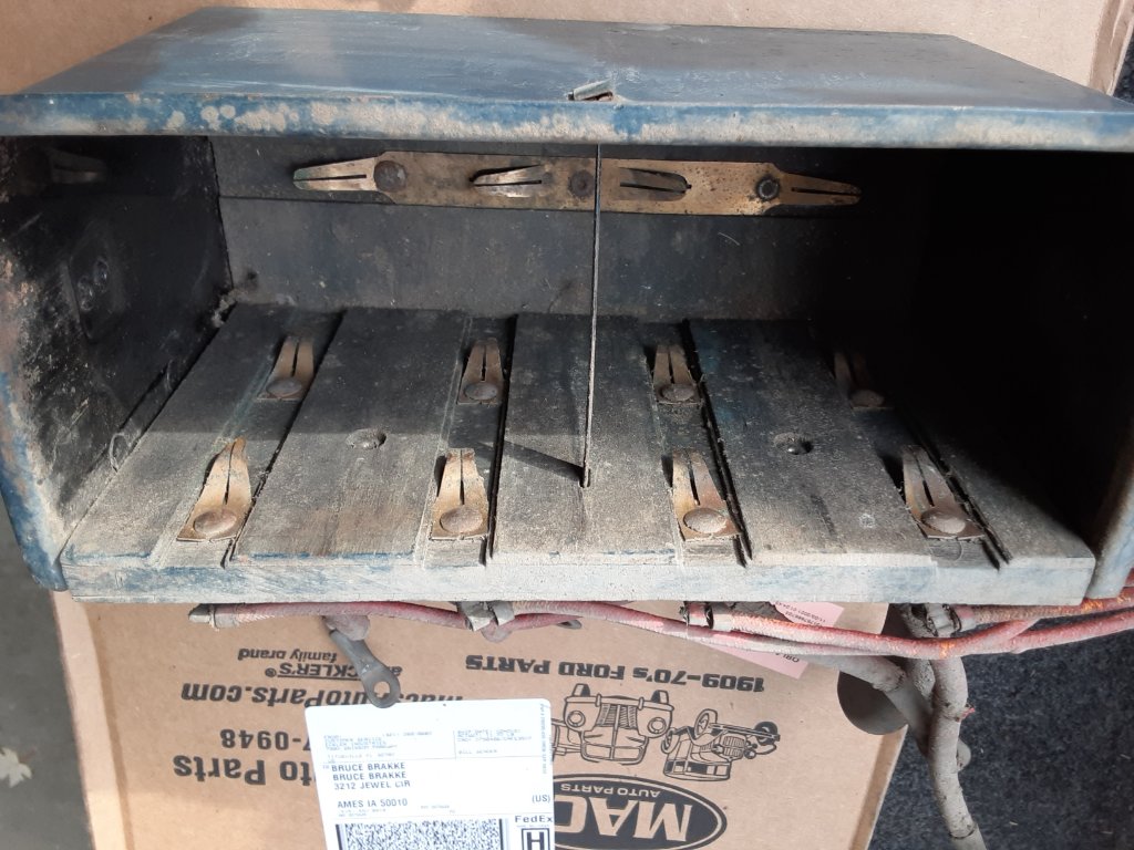

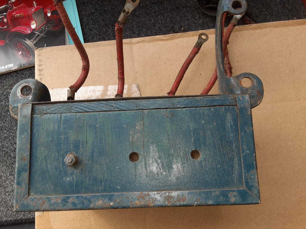

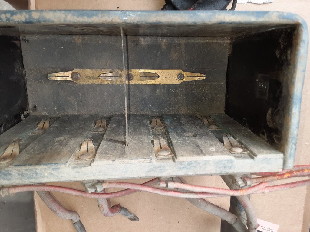

Wood looks good. Couldnt hurt to re-coat or oil. Whatever you do, do not replace the contacts with repops. They are way to soft & would be a step down in reliability.

That “Macs” cardboard box scares me!

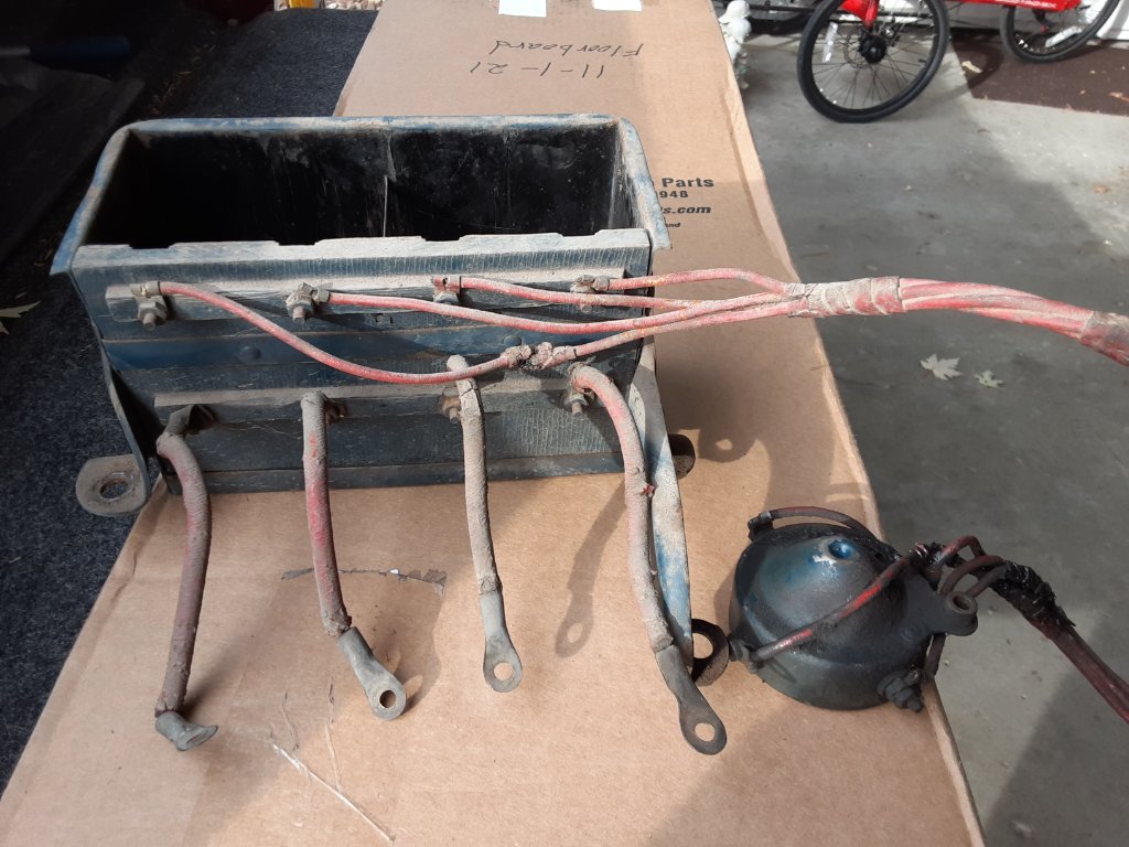

Michael.. the timer wires.... I would take each wire off the terminal and replace so the wire comes off the bottom of the terminal so it does not short out on the coil box lid.

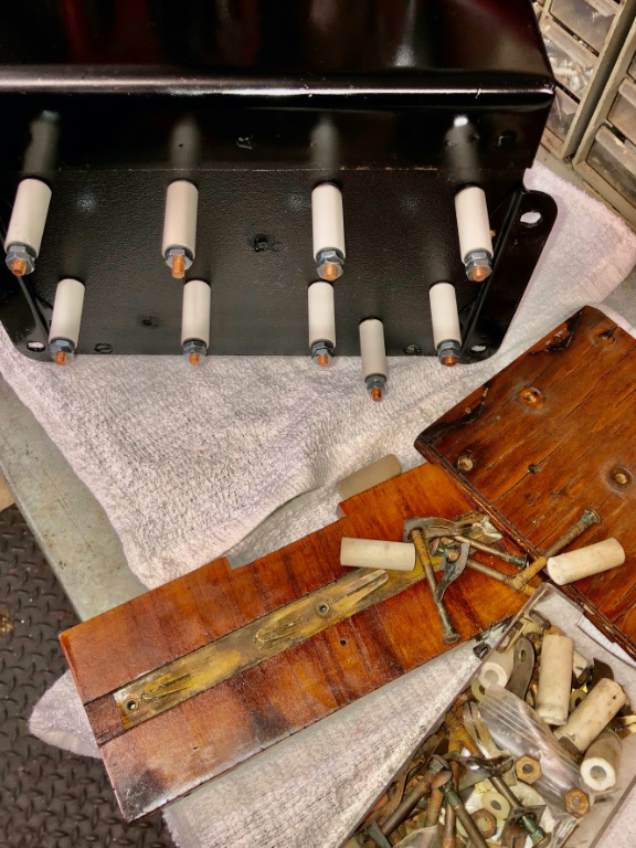

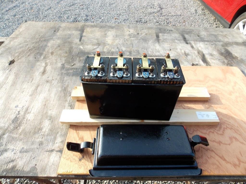

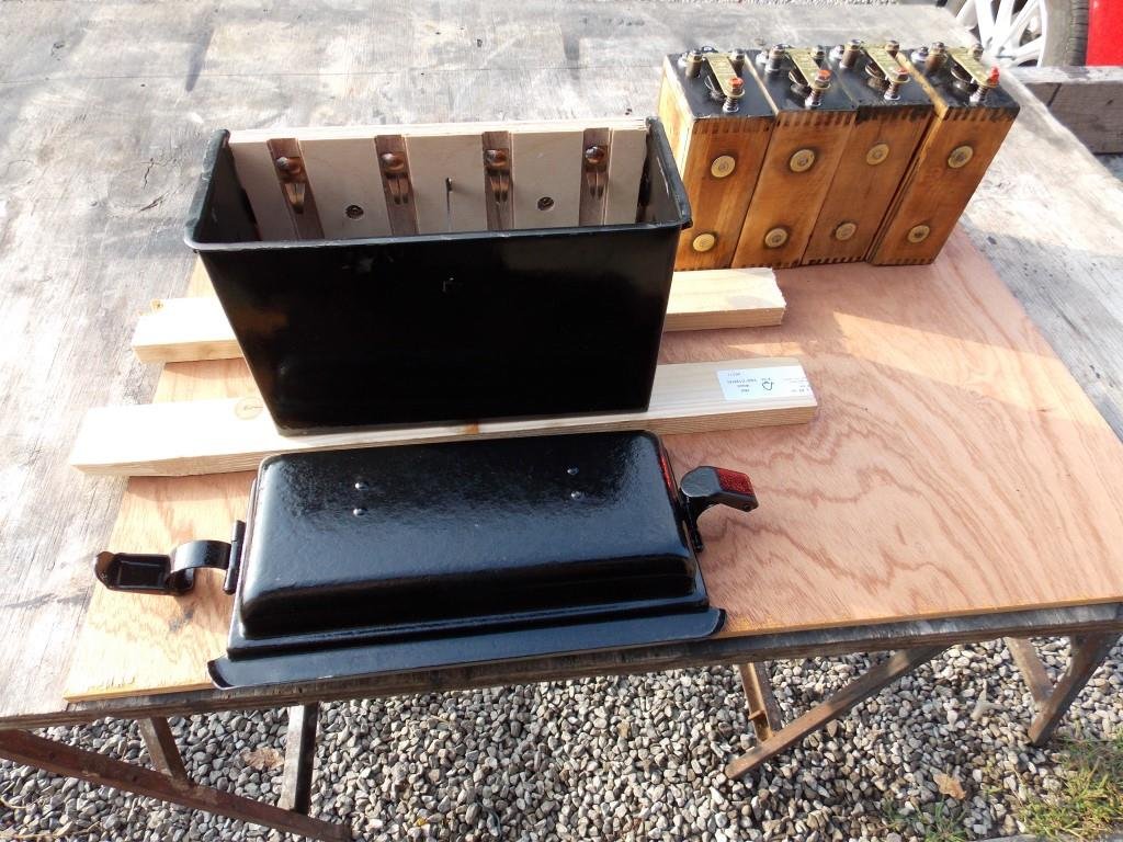

Re: Coil Box on 1927 Coupe

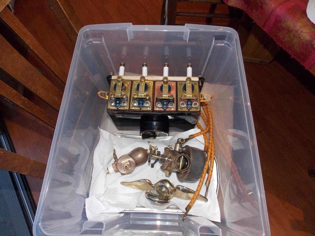

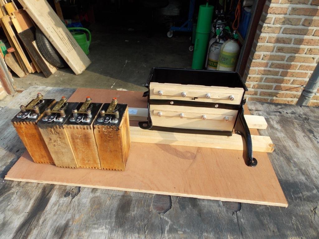

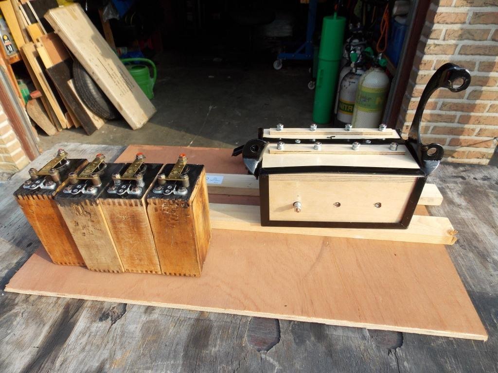

If it was mine I should do a complet overhaul with new wood.
Sometimes old wood had carbon traces around the hight tension bolt this could be the reason for ignition problems.

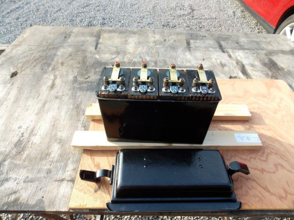

Here is what I did with one of mine.
The new wood has a few furniture wax coatings.
Contacts are original, cleaned and soldered to the new screws.
Sold it with rebuild coils, all the wiring, new timer and all the small parts needed to install the timer in replacement of the old Bosch distributor.
Andre
Belgium

It's only original once.
Looks good. I would keep it.

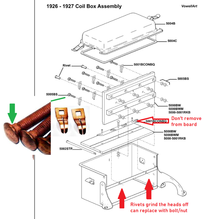

NO. The wood looks really good, no separation of the veneer from the solid. At a minimum I would clean the contacts in place (do not bend them). It is as well as the nuts. Be careful in loosing the nuts. The carriage bolt head fits into the square hole of the metal contact
IF you feel compelled to do an overhaul be aware of a few things.
-To remove the carriage bolts and contacts - wrench the nut closest to the back o f the box and remove the outside one and wire. If the remaining nut doesn't come off easily double nut the bolt and then wrench off the nut to break it loose. When replacing the bolt and nut don't over tighten this nut as it will squeeze the contact and possibly deform it.
-The bar on the back of the box is held in place with rivets - you'll need to Dremel grind the heads off - can replace with pop rivets or bolt/nuts
-Don't remove the bottom strip - just clean it. Removing it is just a lot of unnecessary work.
-Once apart clean the wood with a non-oily wood cleaner/restorer then seal with a product like Cabot Black Solid Exterior Wood and Sealer Model #BLACK-1614379. Its an Acrylic based staid.
-Pay attention to how things fit together before you take them apart
-What to buy The copper bolt & nut set (5005BS ), brace (5002STP), gasket (5004C), instead of the rivet set (5001RIVB) I'd use some stainless nuts and bolts, wood cleaner and stain.

AndreFordT
- Posts: 557
- First Name: Andre
- Last Name: Valkenaers
- Location: Scherpenheuvel

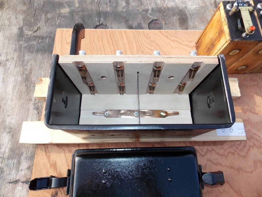

Hi All,
The wood in my 1926 coilbox was bought at HISTOPARTS in the Netherlands. The wood in the 1914 box came from Snyders (first picture).
It is made, as somme said, from good quality plywood. In the past I bought the wood panels and a lot of other Model T parts from Snyders and they have also these good quality plywood panels. T-5000-W for 1915 to 1925 and T-5000-BW for the 1926-27 panels.
Before assembling the boxes I aply two coats of furniture wax on the panels, no clear coat or paint.
Just for information.
Andre
Belgium

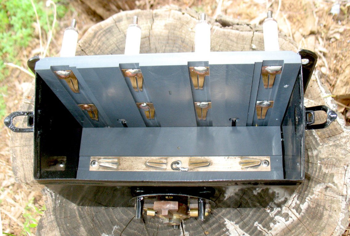

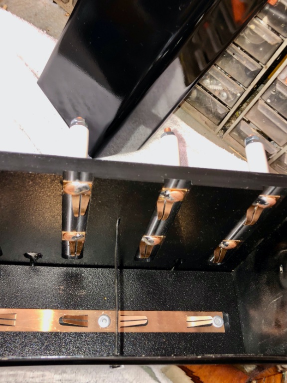

- Posts: 4056
Replaced last year a so-called redone old wood panels in this coil box, some one cleaned and varnished it, so it looked good, but was cracked and I just don't trust old wood trying to prevent 10k volt outputs from my coils
So bought the former Fun Projects plastic replacements from Langs, Birdhaven is the builder of these, so yes, still avail. The plastic is a bit different with a nice grain finish, but the kit works perfectly. I just used different pop rivets in my install, as I had some nice s.s. ones in the drawer.
Can't beat the plastic, that will outlast wood! Won't crack, warp, swell, makes insertion/removal of the wood coil boxes easy with a slick surface, or cause any troubles in your T's ignitions system.
A good coil box is the home base or foundation for the trembler ignition.
The contacts are the new more expensive bronze ribbon, and work like the originals, strong and springy.

To me this particular coil box looks pretty good after almost 85 + years. It doesn’t like it hasn’t ever been wet.
But on a Model T the coil box is the heart of of the electrical system. It has to be in good shape for a T.
Checking it out with a good VOM you could see if it has good continuity or shorts and so on.
Before you check it out use air to blow it out really well.
It’s your choice what to do and if you do decide to rebuild it reuse all the original contacts and strips.
