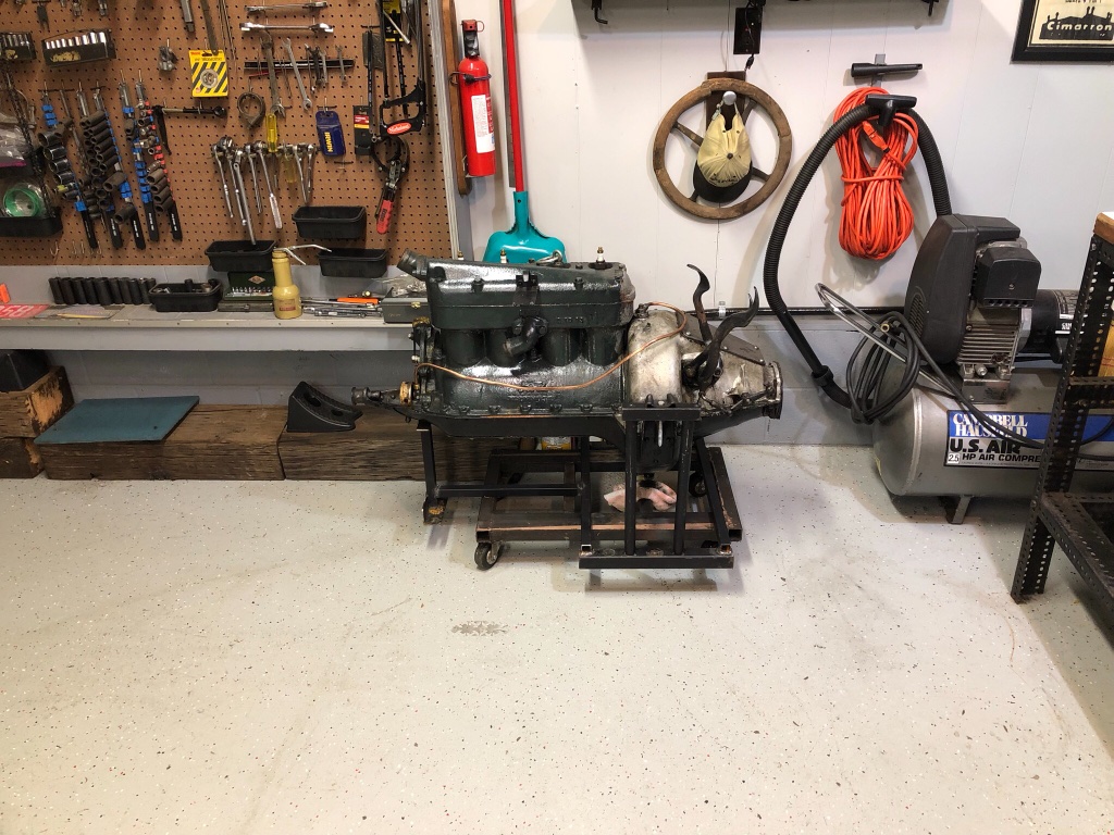

Freshly rebuilt engine set in the frame all that remains to do is everything else......

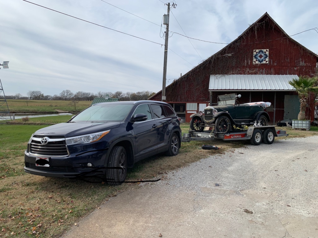

I guess my post should be what did Corey Walker do with my Model T in November. He did a beautiful job of rebuilding the two screw Holley H1 carburetor for our 1911 T restoration project. Here is a before and after picture:

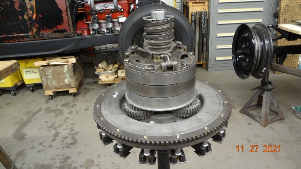

A "T" transmission for a friend.
Picture 1 shows some of the small parts to the transmission puzzle.
Picture 2 is an adapter I made in 2000 to support the flywheel during removal and installation of triple gear pins.
Picture 3 is the pilot wheel arbor press I used to install new pin part way.
Picture 4 I am using a hyd. press to finish the install, making sure the pins are below the surface where the magnets rest.
