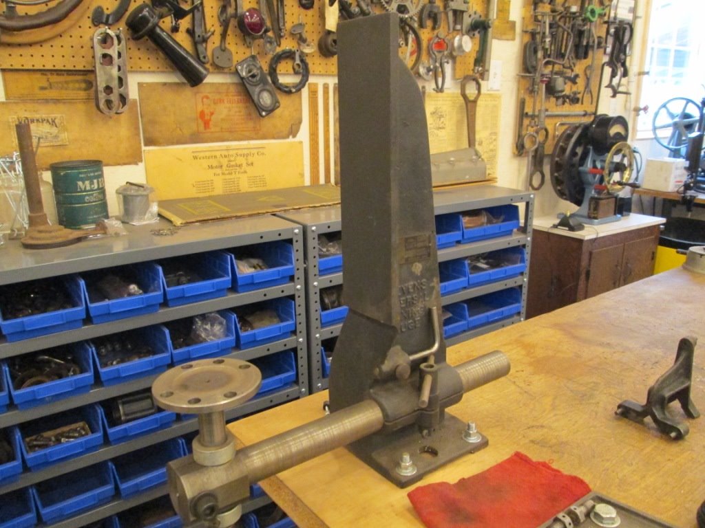

I recently viewed a post where a "SMART T'R" had re purposed his KRW piston aligner to check adjust mag. clearance?
Please refresh me on the forum date?
Thanks in ADVANCE!!

I have a Stevens rod alignment fixture that I had a flywheel attachment made to hold the flywheel to set the magnet height with my KRW gap gauge - is this it ?

Thanks! I will fabricate that "new" use of an old tool!

I believe I saw the flywheel holding fixture in an old Ford Service Manual or Bulletin ?

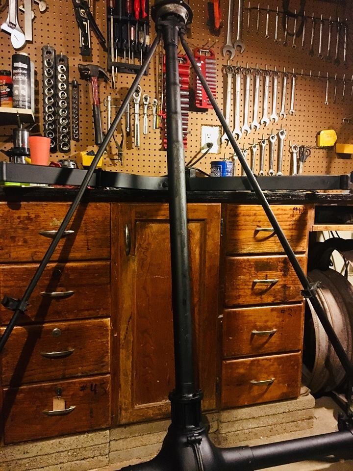

Steve: How do you manage to keep your garage so neat? I'm unable to do that! Great looking shop.
Posts: 5491
Re: KR Wilson piston aligner new use!
Post by RajoRacer » Wed Mar 27, 2019 1:14 pm
I'm kind of an organizational/anal/ clean freak !

I am too Steve. (see mine below)
I've always heard, however, that a clean desk or workbench is the sign of a sick mind. :shock:
