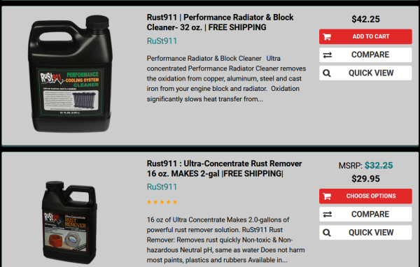

Noticing large flakes of rust in my radiator I drained and flushed my cooling system. Then I refilled it with a mixture of RUST911 concentrate. I left it in for 24 hours, and even drove the car with it in without any problem. When drained the clear concentrate came out black. I repeated the operation and this time it was light grey. After the third application it drained clear. By removing the hoses I could see sparkling clean block and head. The radiator was also rust free. No flakes at all. I chose to refill the system with Waterless coolant. No water = no rust.
https://www.amazon.com/Rust911-16-gallo ... 0cnVl&th=1
https://www.amazon.com/EVANS-Coolant-EC ... 91865&th=1

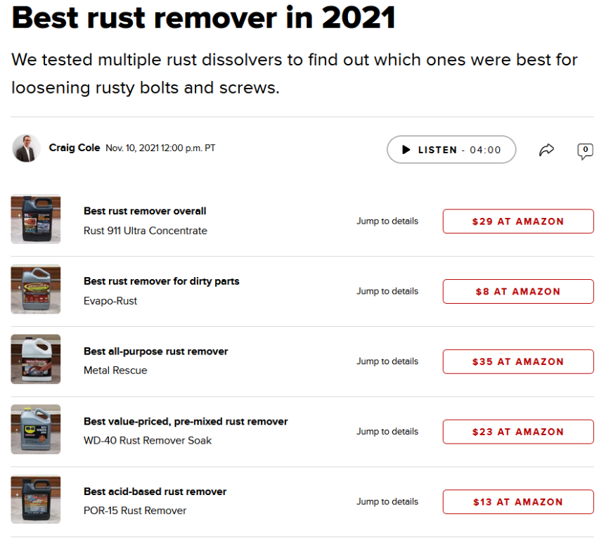

The rust color changes indicate its a concentrated phosphate based product .
Information on toxicological effects Phosphonic Acid, Salt LD50 Oral Rat / Male/Female 1,512 mg/kg -
Always good to know what works for a specific problem.
https://www.rust911.com/rust911-home-page/ https://www.cnet.com/roadshow/news/best-rust-remover/

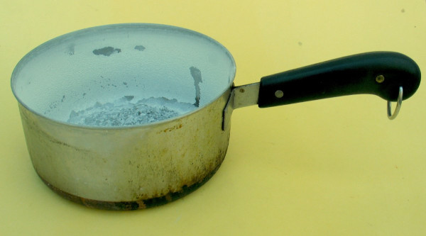

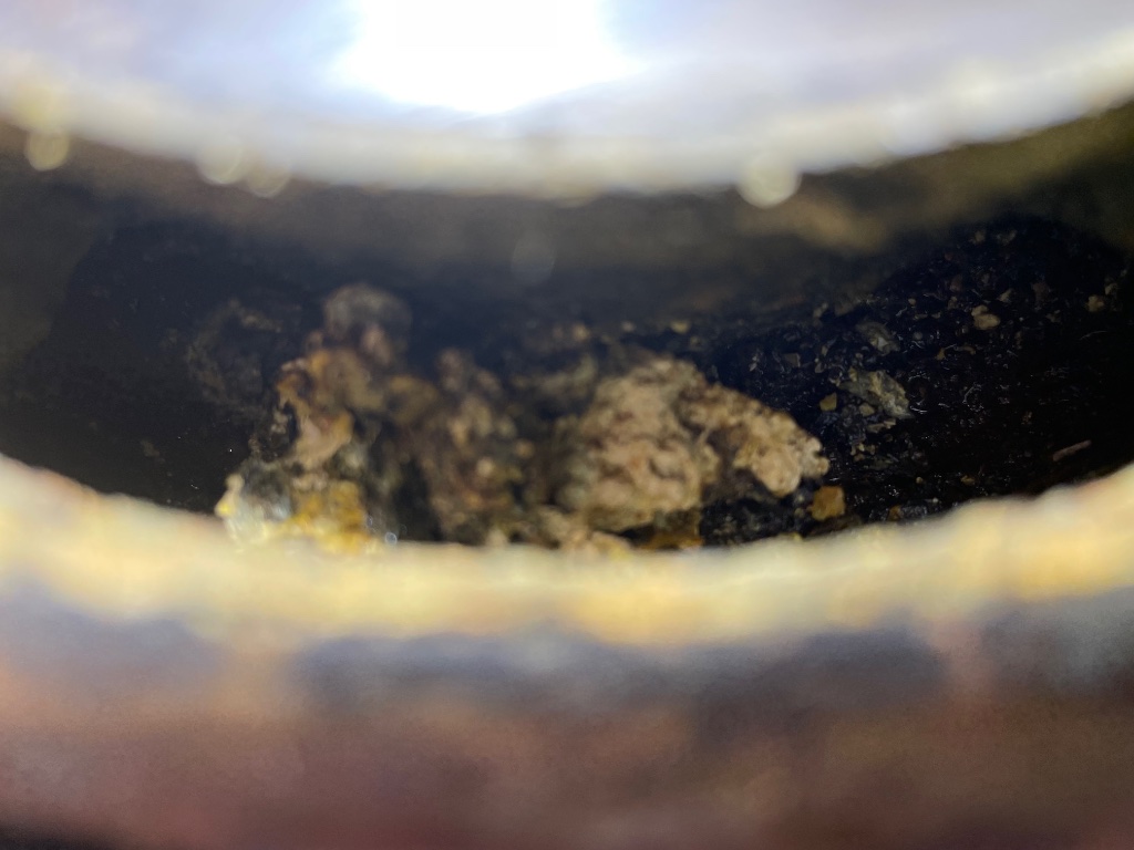

Whatever you use to prevent rust, it's important to use something. The head on my 1915 was so rusted away inside that it developed a leak near the rear, which I patched. Recently it sprang another leak between #3 and #4. I replaced the head, I hope with a better one. In addition to antifreeze to prevent rust, I also use distilled water because the tap water here and in many places has a lot of minerals that form scale.
I heat tap water to make tea in this pan. Notice how bits of mineral scale have broken loose, perfect for clogging radiator tubes.
- Posts: 4699
Re: keeping the engine and radiator rust free,
Yes well water will leave mineral deposits in your engine if you use it all the time!
The mention of well water brings back memories growing up and my Mothers tea kettle we had for years. I may still have it somewhere in our sheds. She finally had to get another one because the one she had was coated with the white minerals from our well. The ‘rock’ that was in it made the old kettle heavy! She was so use to it it was hard to stop using it!
