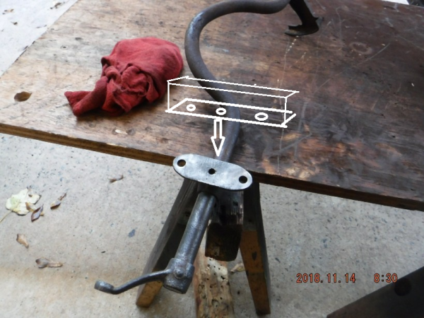

Once the control shaft is removed don't forget to clean out and maintenance the oiler holes
http://www.mtfca.com/discus/messages/82 ... 1542391088

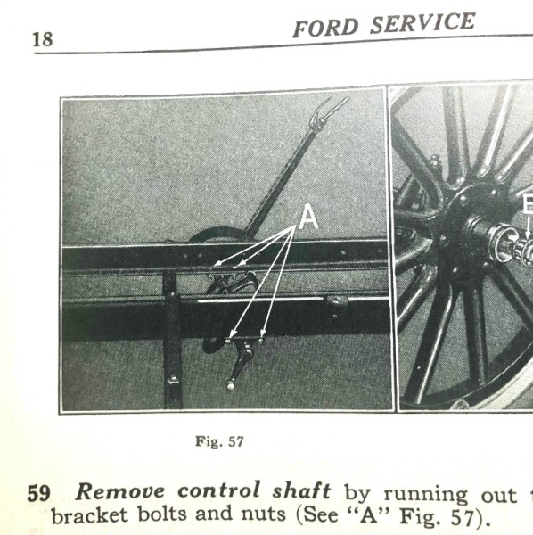

You can refer easily to Ford Service, paragraph 59 to remove and paragraph 67 to install that control shaft.

Thanks all. Dan - I looked all over the darn manual for that page - One would think "handbrake" or Pawl or control quad etc would have pointed there! Anyway looks and sounds easy enough. Thanks!

As pointed out before in past posts there is a small felt in the 2 small oiler holes. I found that out a few years ago when reading the forum. The felts act sort as of a wick for the oil to seep into the shaft.
I’ve had a few of the handbrake assemblies out of the cars
I have worked on and thought I was cleaning out dirt or gunk out the holes which was the remains of the oiler felts!
I don’t know if any of the parts suppliers have them and lots of T’s don’t have them after a clean up the the handbrake.
It’s an overlooked item that usually doesn’t get put back in.
